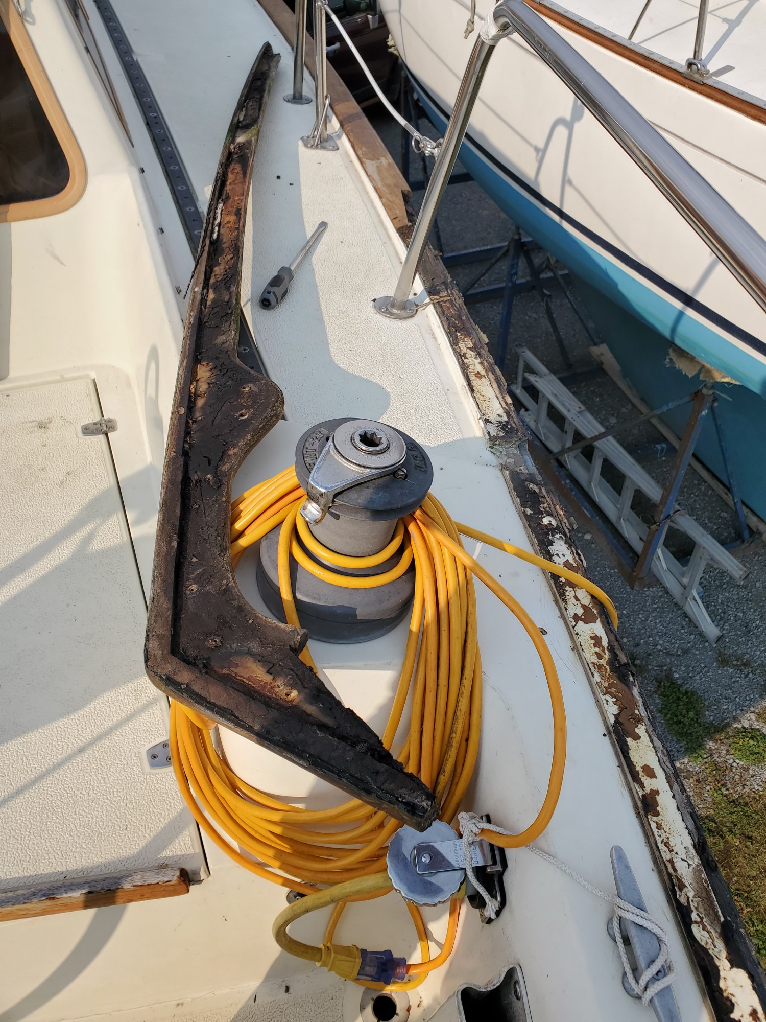

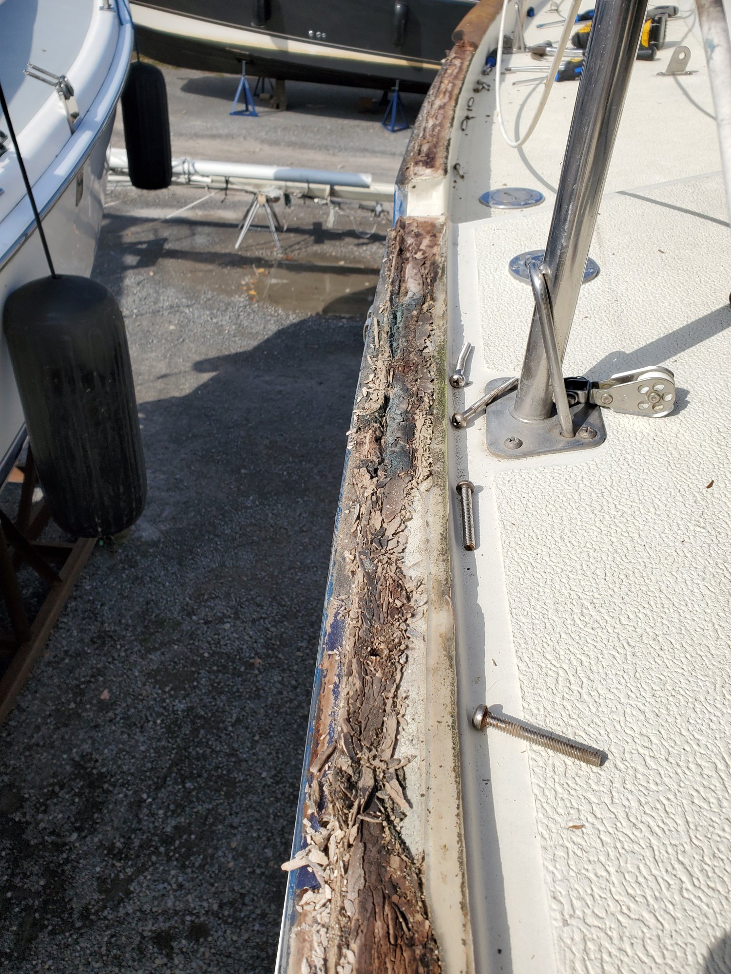

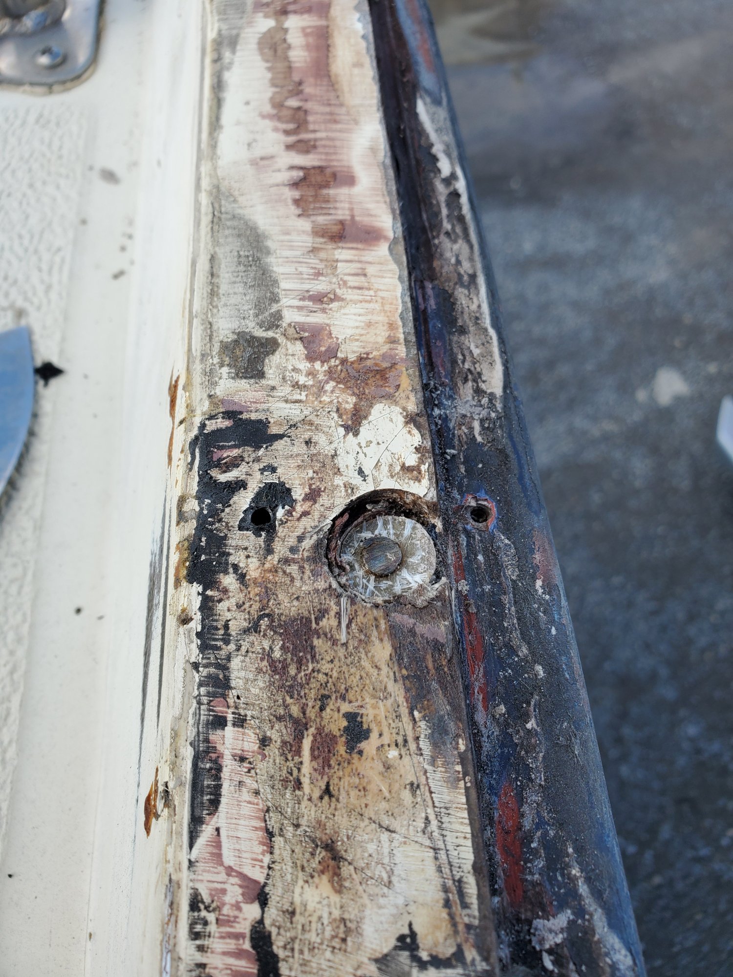

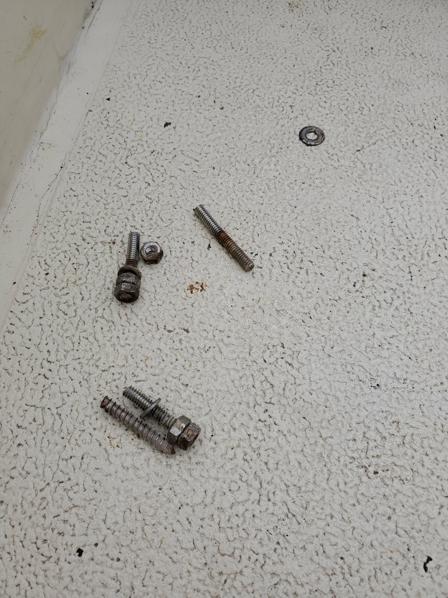

What I found was more than a little disturbing. The starboard cap rail had been replaced previously, possibly do to a collision although the hull did not have signs of any major repair so it looks like whatever damage there was, was limited to the cap rail. The problem is how the original cap rail was removed. The factory used #14 wood screws to fasten the hull to deck joint but then through bolted the cap rail with 1/4-20 machine screws and nuts through the cap rail, deck and hull which held it all together very securely. The problem is whoever removed the cap rail couldn't figure out how to remove the machine screws so it appears he used a 1" hole saw to just cut the cap rail around the screws then hacksawed through the screws and left the now headless screws in the hull. :banghead: I actually found one of these headless screws in August and could not figure out where it came from. Turns out they were all along the starboard joint.
The person who worked on this before (trying to be nice here) did a lot of damage with the hole saw that needed to be patched up. Here is one of the holes in the deck he created with the headless screw still in it.

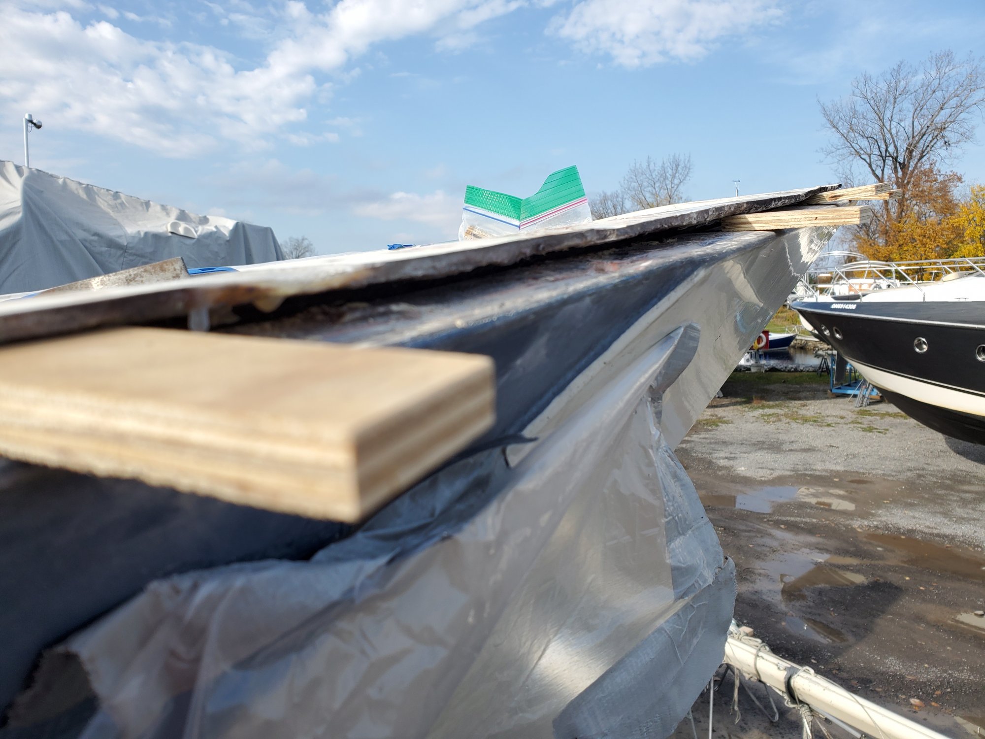

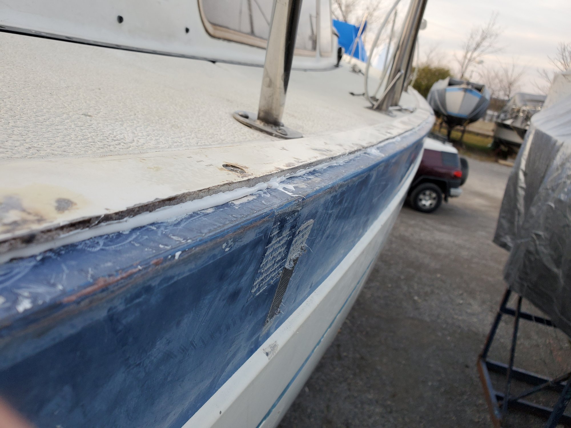

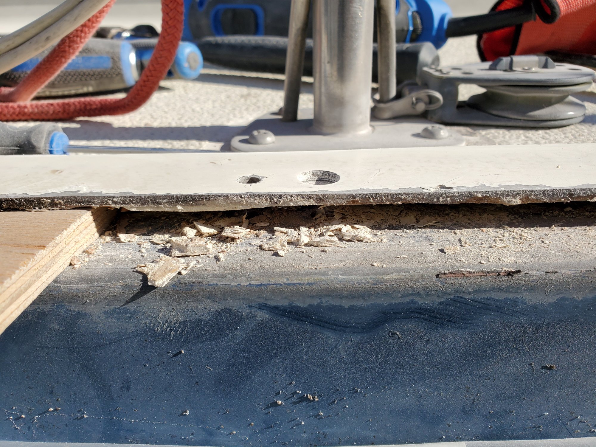

The trick I learned from those that travelled this route before me was to open up the joint with some wedges, up to 3/8" in some places, other places would only open up 1/4" then use a rasp in an oscillating multitool to grind out the sealant. A lot of it just flaked out it was so dry.

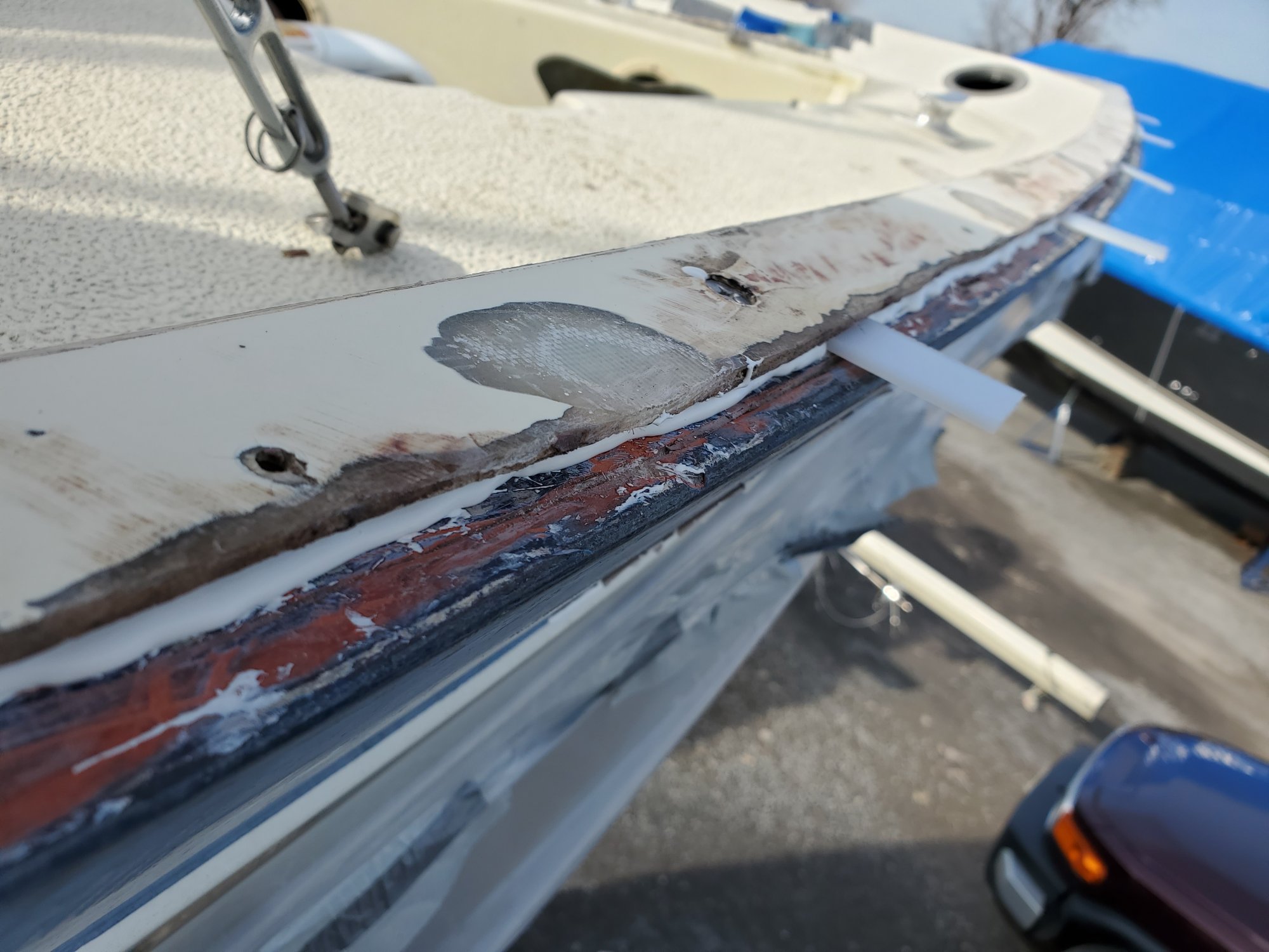

Once it was cleaned out I used 1/8" thick UHMW spacers to maintain the gap for the sealant and shot in as much 5200 as I could. I've never wanted to use 5200 on my boat before but this is a job I don't ever expect to do again - it is now permanent. A couple days later I removed the spacers and filled the gaps with more 5200.

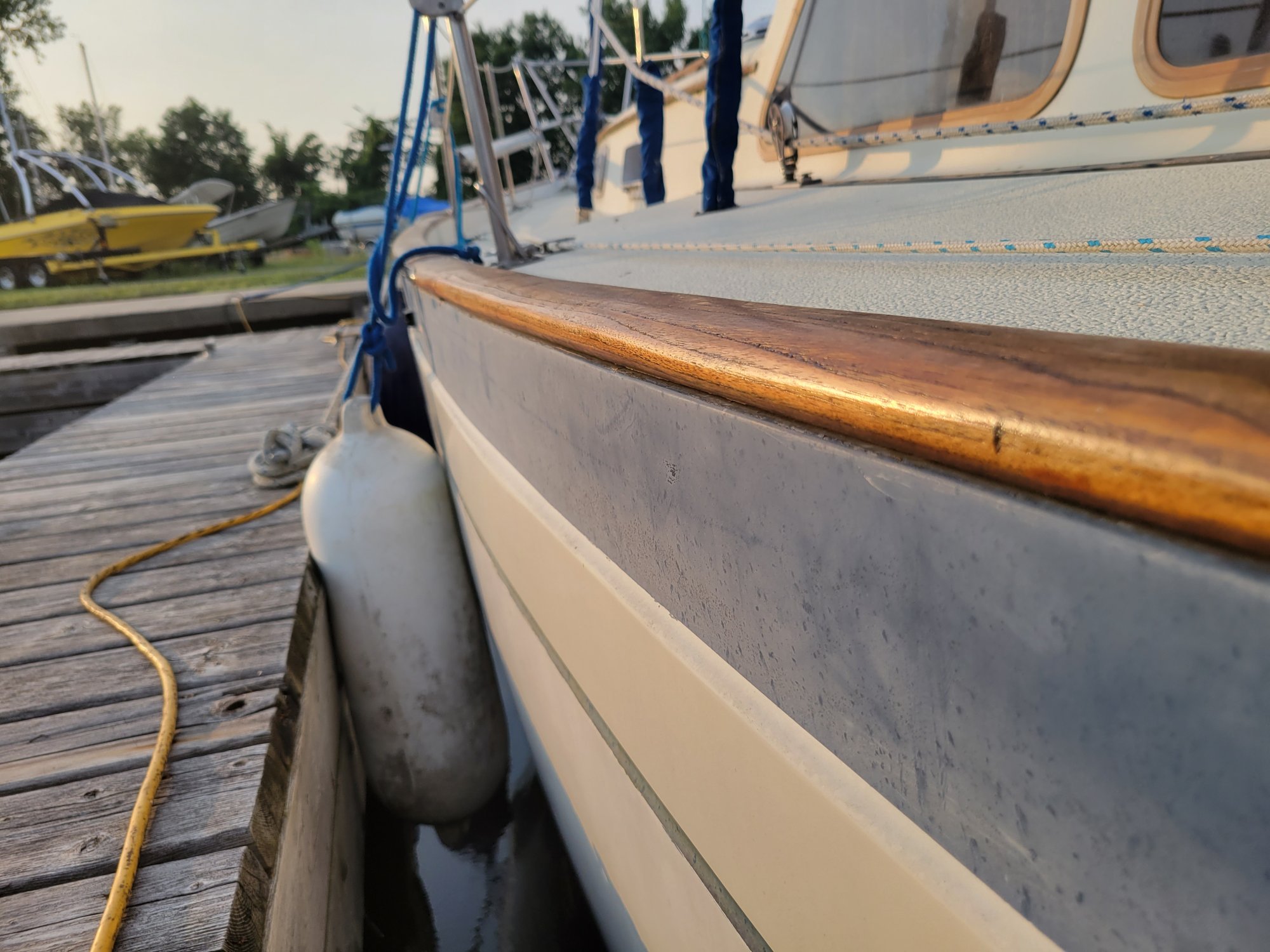

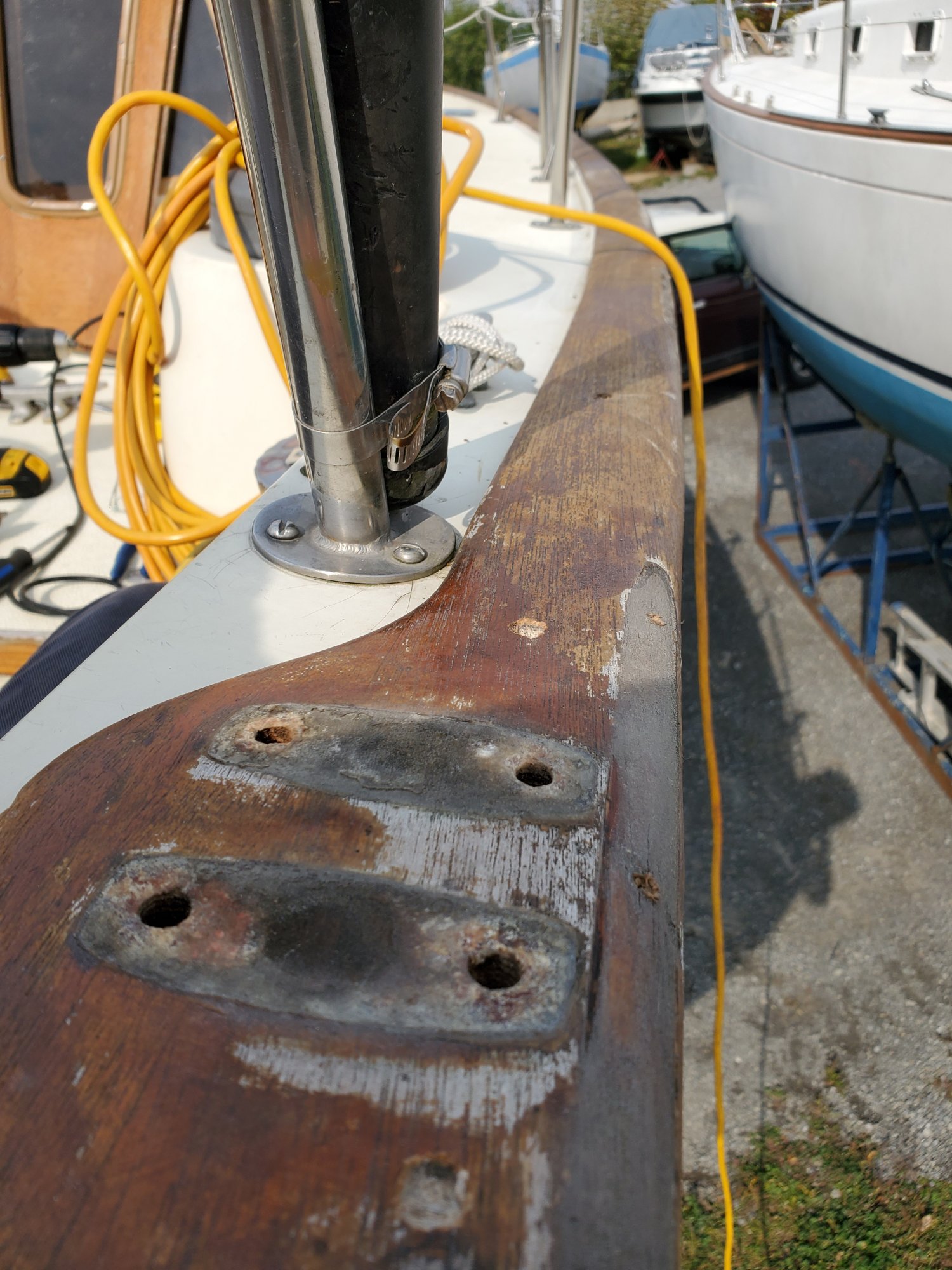

My winter project is to refinish the teak cap rails then reinstall them in the spring.
