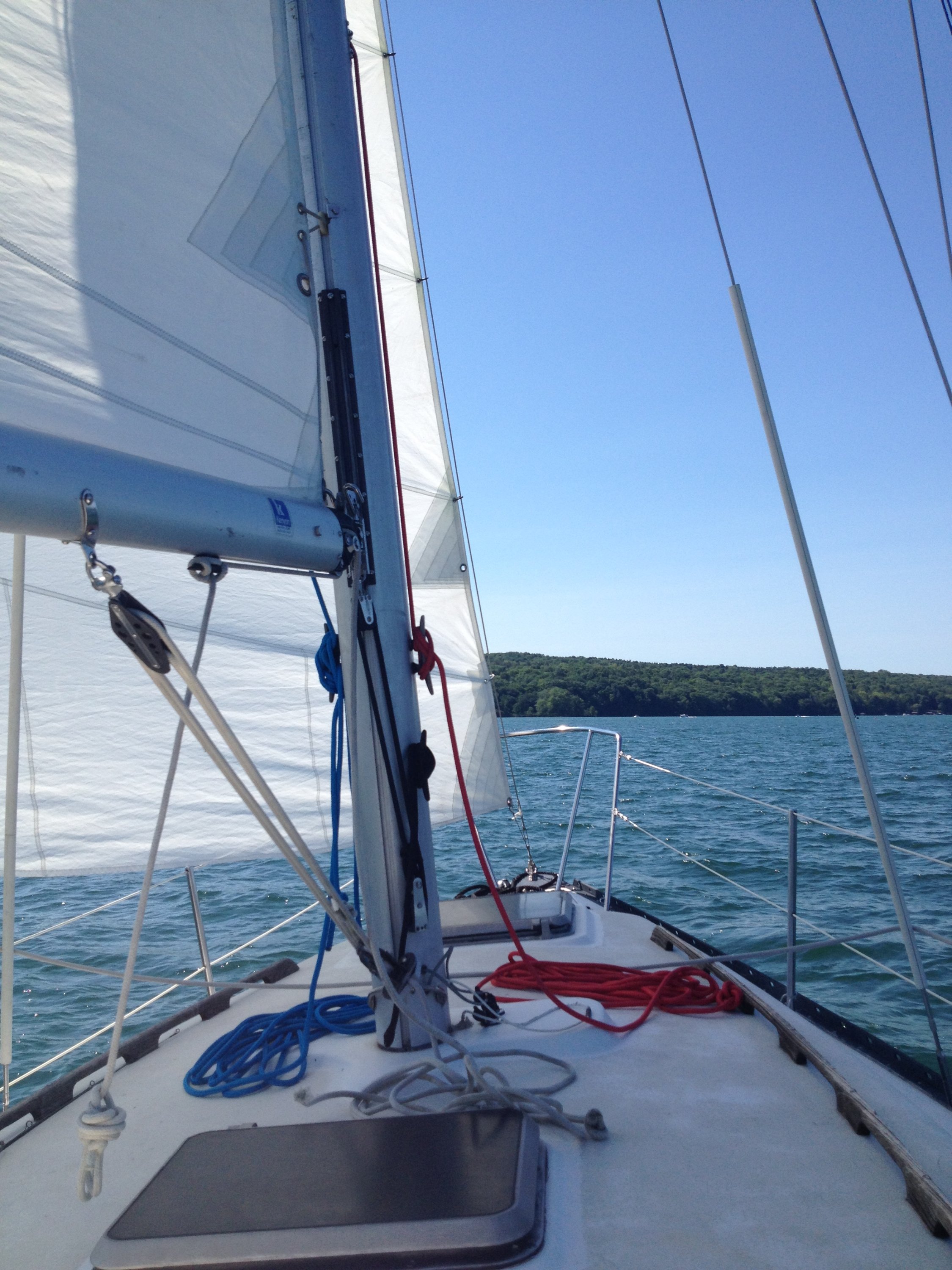

Spazz, are you suggesting that the halyards have been completely withdrawn from the mast? In other words the lines were totally removed? Typically this is a bad idea, if true. Most folks, when replacing the halyards, simply leave the old lines in place until ready for a rethread of new lines. You use the old lines, sew them onto the new lines, and pull the new lines up thru the mast and sheaves. I think you'll find a world of hurt trying to use something like a drain snake or something comparable to rethread without the old lines in place. I'm sure it's possible, but gonna require some effort and patience. Do your halyards enter the mast slightly above the boom like mine? Follow the red line up near the top of the photo.
