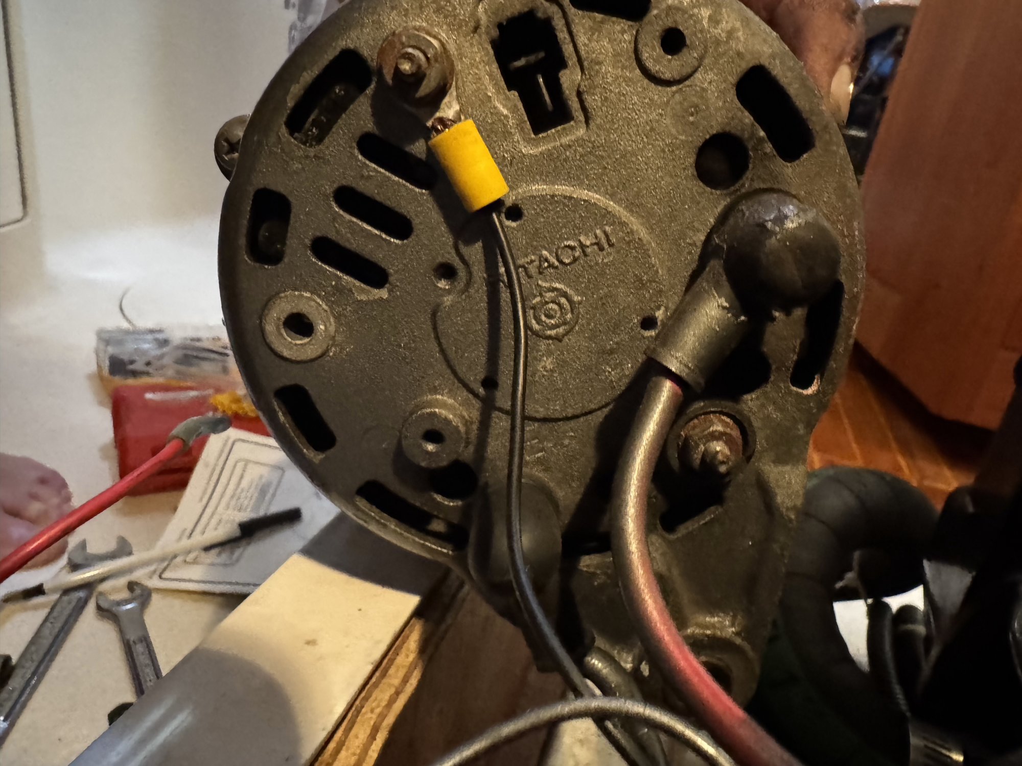

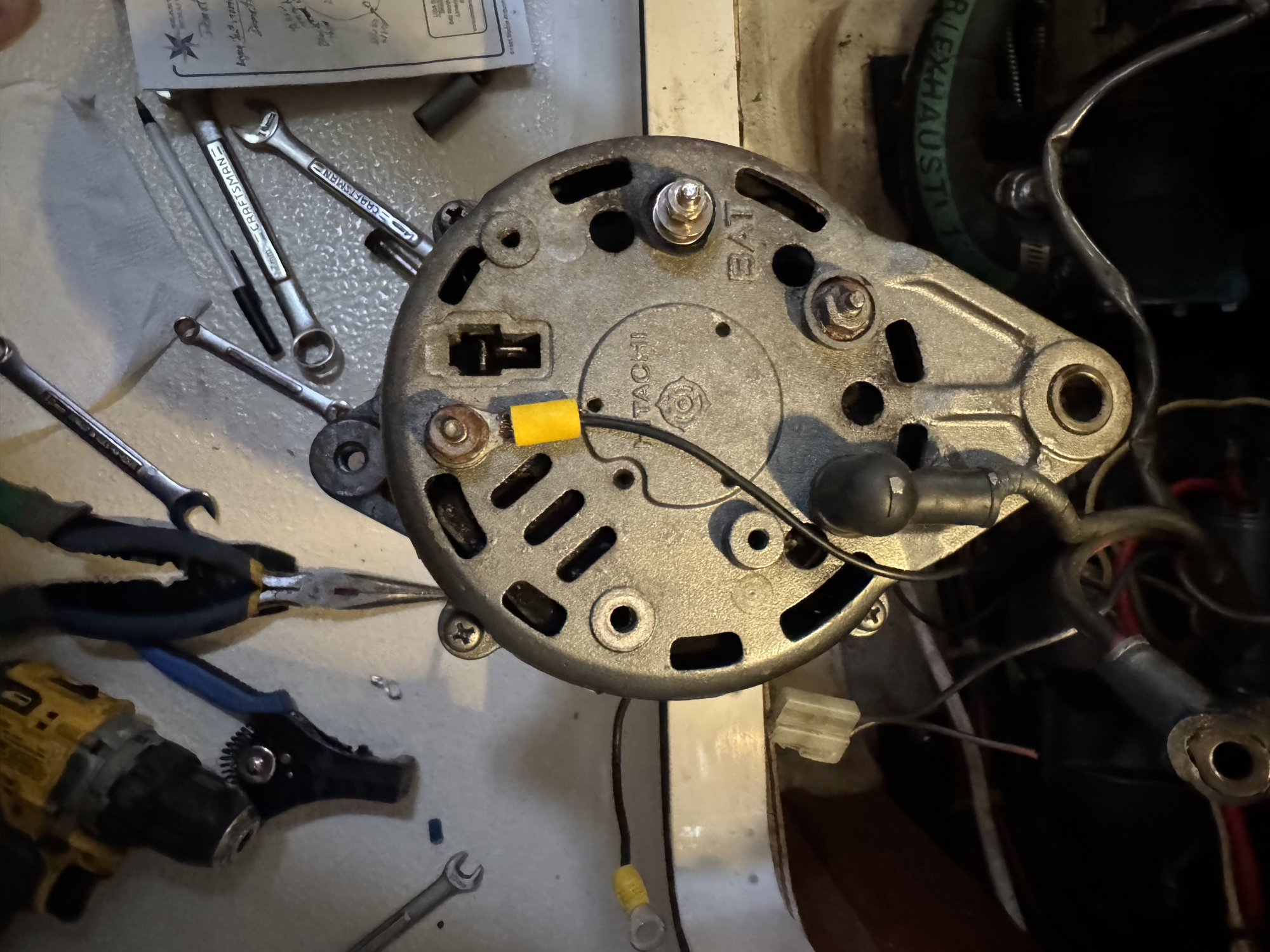

I am not sure why you showed photos of your alternator…
mine is wired to the hot on the ignition switch. Same with my fuel gauge…only on when the key is on.

The alternator picture was provided because Hunter wired either to the hot starter connection or to the same connection as the tach, on the alternator. The mechanic, who I had hired to resolve the hour meter problem, has not been available for a very long time. He had said that he had been feeling I’ll.
I’m afraid that he may have passed away, mid-project, leaving a new hour meter and unattached wiring.
I will wire to the hot ignition switch as you suggest.
