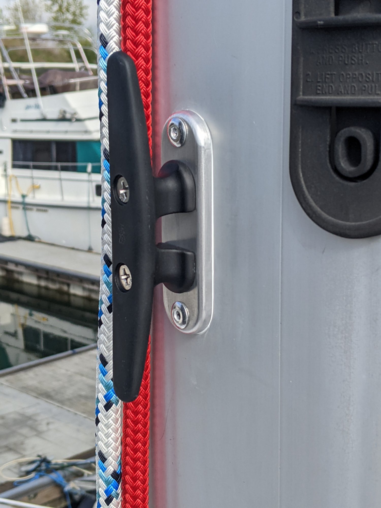

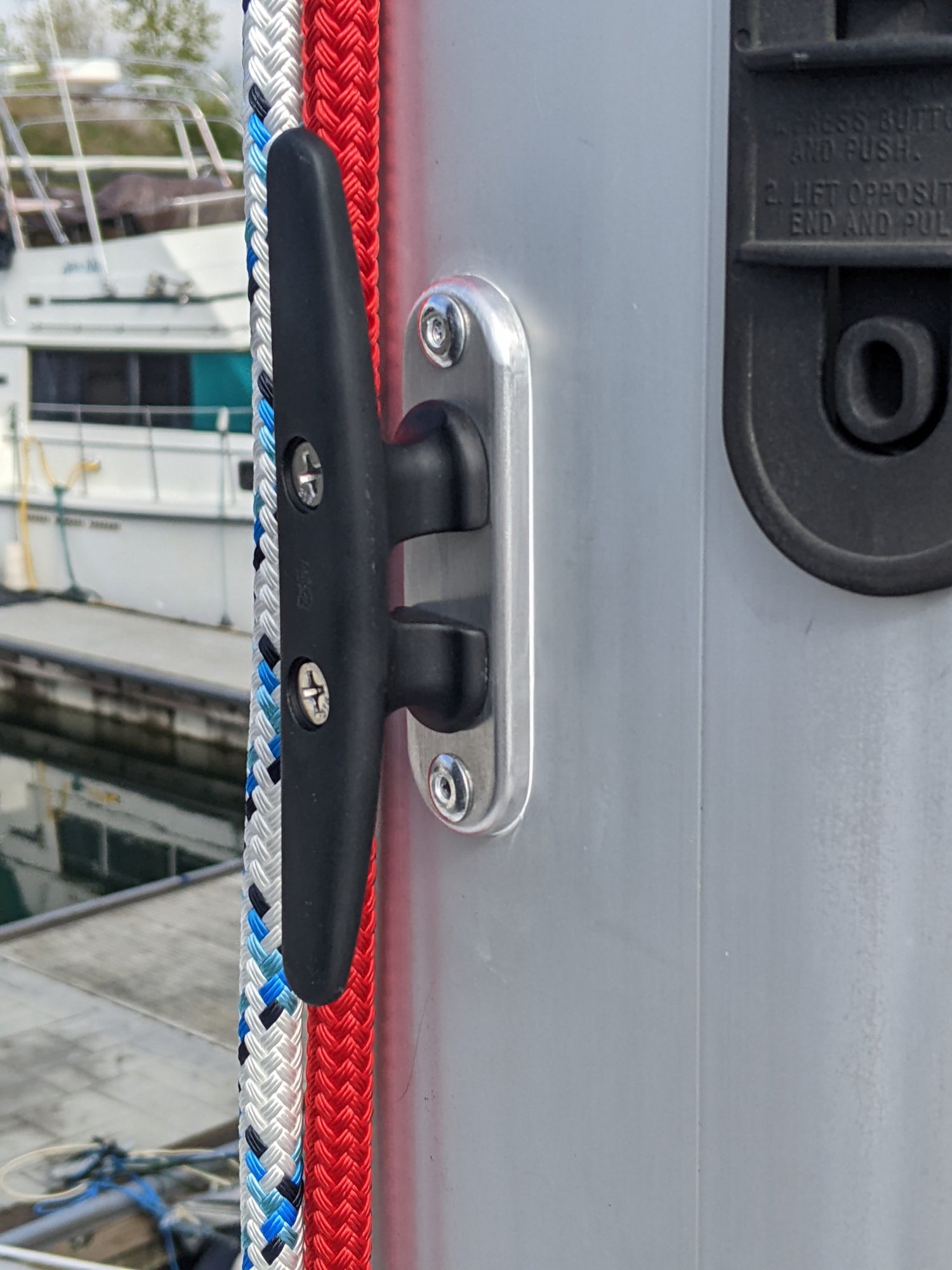

I decided to mount a horn cleat on the mast for the jib halyard (port side) and the main halyard (starboard side). This frees up a clutch on both sides of the cockpit so I ran the topping lift line in place of the main halyard. I don't have any specific use in mind for the freed up clutch on the port side yet but having the jib halyard coiled at the mast reduces the clutter in the cockpit a bit. Both the headsail and the main are on furlers so the halyards are seldom used.
The attached photo shows the cleat mounted on the port side. I made the base plate from 1/4" aluminum bar which is drilled for the 1/4" blind rivets holding it to the mast. The cleat is attached to the base plate with two 316 stainless 1/4-20 machine screws (with never-sieze compound on the threads). I did put a thin coat of 5200 sealant between the base plate and the mast just to reduce the likelihood of water ingress behind the plate.
