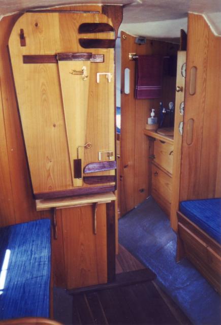

Dog , If we have to count sweat equity into the cost of a boat repair or refit then they are all too expensive.
I was really addressing the question to Mainesail for his response to Jim's statement that a new boat had to be perfect. I had suggested that with a sound hull and a new engine and rigging and all other systems in good repair did you not have a new boat?
I rebuilt my boat just to have a boat made as I wanted on the inside and I bought the hull shape that I wanted. I could have purchased a very good boat for the price I put into this one but I believe that I have functionally a new boat it just happens to sit in a forty year old hull.

Dog , I saved that boat from the chainsaws. I paid 5 thousand for a hull the spars and four good sails delivered to my yard. I worked on it for about 8 or 9 years and made slow but steady progress. All ove one winter was spent designing and building the dinette table and dish cabinet unit.
