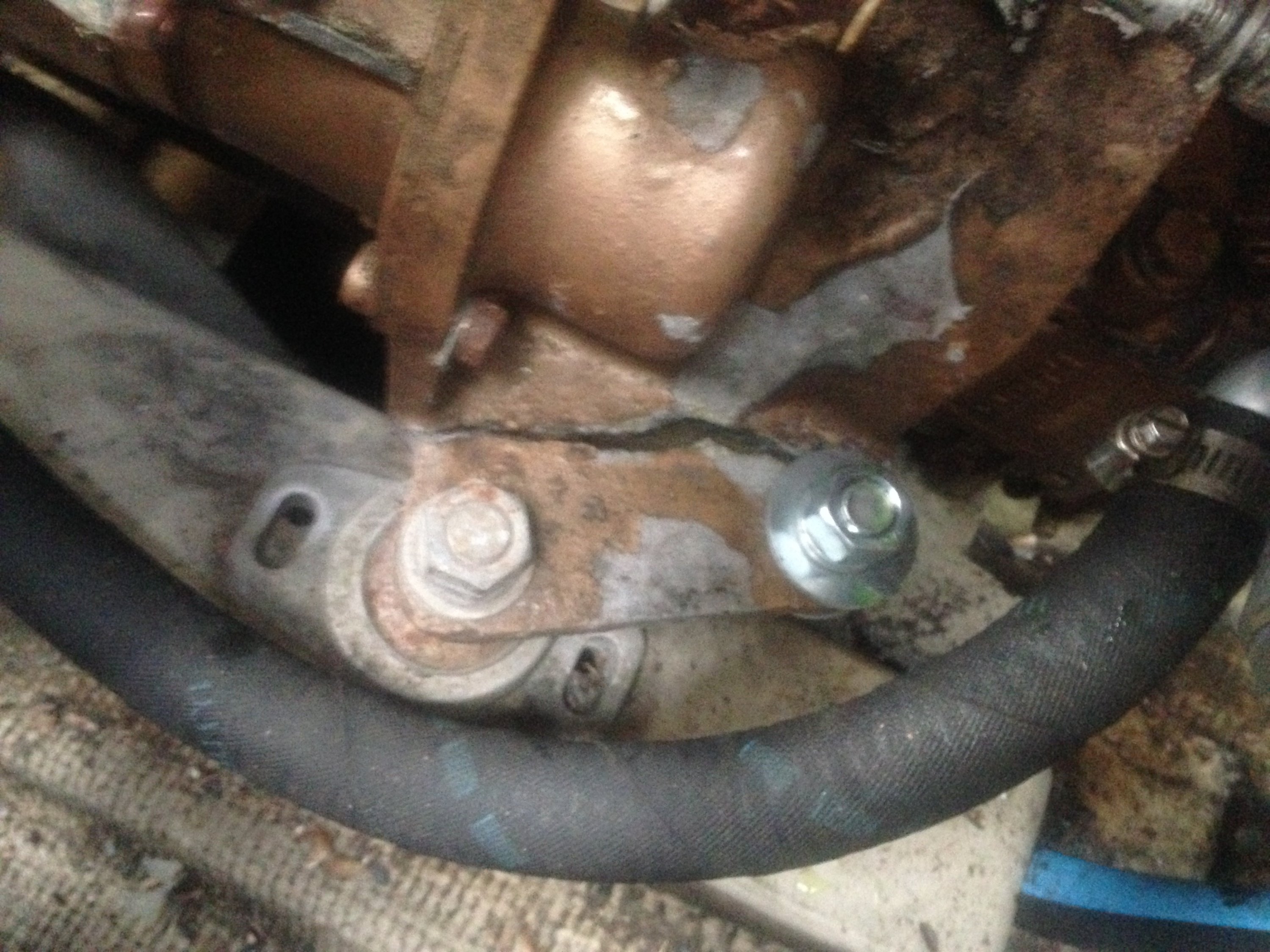

IMG_0730.JPG IMG_0726.JPG Here's a few pics. Notice the motor mount shifted after I removed the mounting bolts and disconnected the shaft coupling so the fracture is much more pronounced. That 5/8 bolt actually held the motor up so it wasn't bouncing up and down and vibrating too severely. Did a 10 mile run up to the boatyard like that.

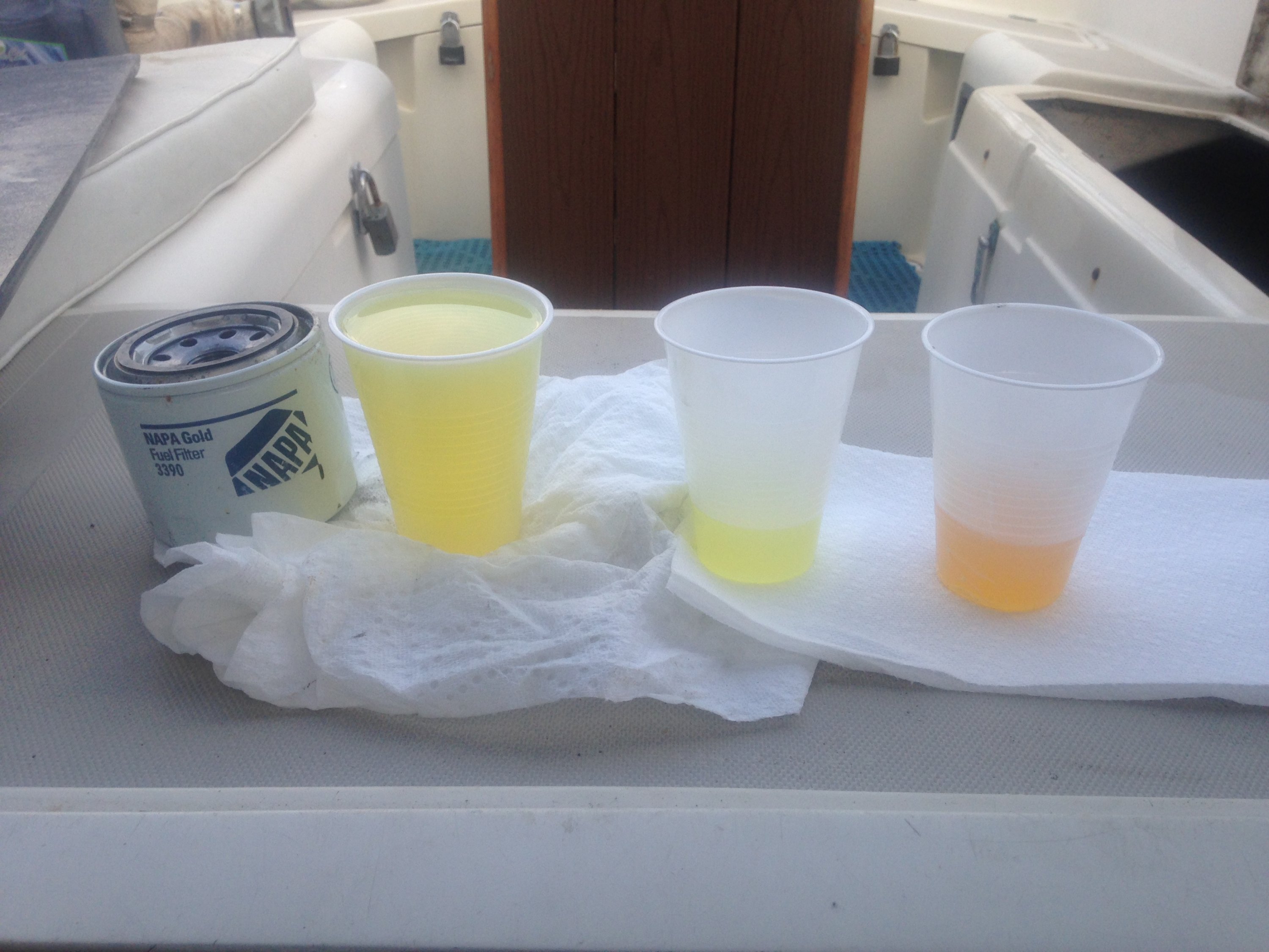

New phenomena for interested parties. The fuel drained from my return line after the injectors is a different color than the fuel going into the secondary (on engine) filter or the fuel in the secondary filter. Any idea why it changes color in the engine pump or going by the injectors? Heat?? The cup on the right is the from the return line right after the injectors.

Looks more like the fender washer held the motor up. It is a shame that the bell housing cracked because judging by the picture, your motor looks like it is in good condition. I have had to reach in the stringers to remove the old motor mounts on my M25. It was an uncomfortable, greasy, dirty job.
Again, I would seriously consider replacing the cutlass bearing while you are doing the repower because it has likely been damaged from the motor mis-alignment. The prop shaft should be inspected to assure that it is true, and that there is no scoring.

Is it possible that you have added road use diesel into the last tank?
Off road (marine, construction and home heating oil) diesel contains a red dye that is used to identify that the road use tax has not been paid. If your Kenworth shows up with red dye in the fuel filter you are in deep trouble.

The fuel should all be the same color. It is constantly being pumped out and back into the tank by the lift pump.

Regardless of where the fuel came from I ran the boat for four hours on Saturday. The fuel still in the lines is a different color after the injectors than the color after the secondary filter. My picture shows the difference. I buy my fuel in 5 gallon tanks and pump it through a Racor going into the tank.
