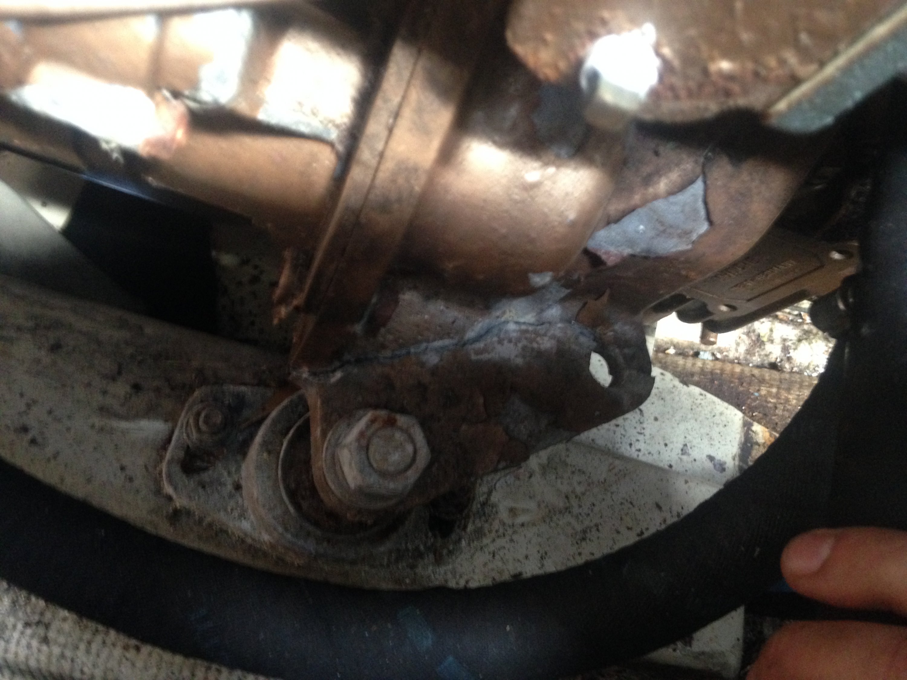

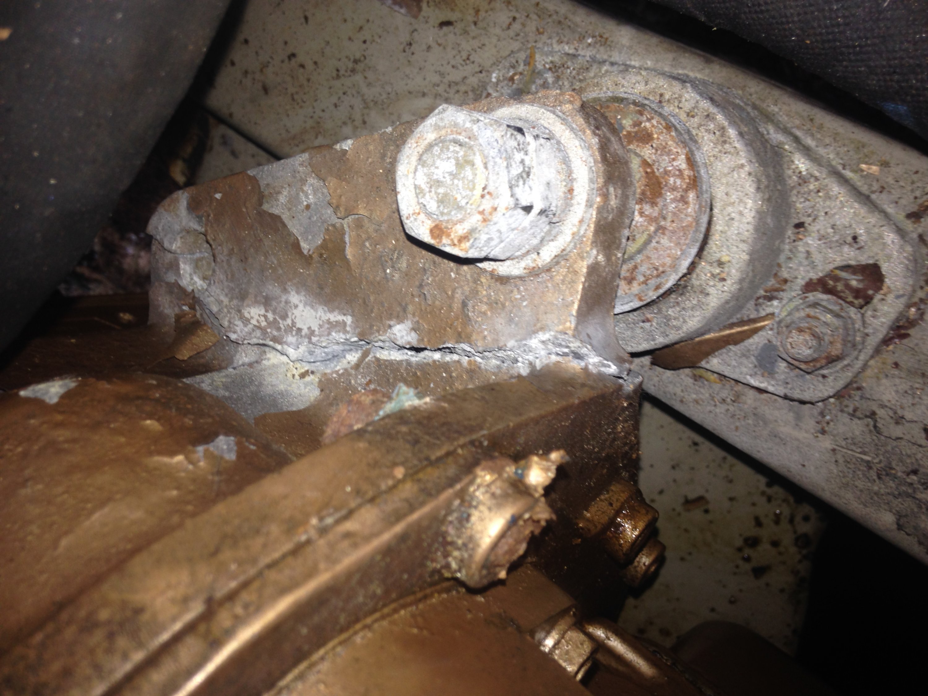

I started doing a shaft alignment yesterday and was astonished to find the aft port flange off the bell housing where the motor mount connects was fractured completely in half. This is a Universal M25 motor. The fracture did not originate in the hole for the motor mount. Thus the motor is completely disconnected from that motor mount. This is all part of the bell housing casting. A new bell housing is around 750 bucks plus all the work of R &R. Given the 31 year age of the motor I am considering repowering versus fixing this motor, with consideration that the starter, seals, alternator, etc are all as old as the motor. Anyone here re-powered their 34 or 35 and if so with what and what hurdles did you encounter in the process? I am considering a Beta 25 or M25XPB but reviews on the M25XPB show some issues. Any other suggestions?

You can always take your current bell housing to a welder for repair and it won't be close to $750. If I had to repower my M25 I'd go with a Beta - and shoot for 30 hp as I am currently slightly underpowered.

It appears to be an aluminum casting as I don't see rust in the fracture. Welding might weaken it from the heat effected zone. It looks like the stress riser from the intersection with the bell section was the initiation site? I also see some oil or trans fluid on the bottom of the housing so a seal is probably leaking likely from excess engine vibes.

Looks like a bracket could be fabricated that would use a couple of existing bellhousing/block bolts and have a component from which to support the motor at the mount.. a small semicircle of steel with a piece of plate welded to it and a hole in that plate to attach to the elastic mount.. Bolts would have to be replaced with slightly longer ones..
Edit: you'd still have to pull the housing to get at it.. There is a technique called "Metal Stitching" that ya may want to investigate.. would repair the part with no welding..

Hopefully you can get it repaired with a weld.

That should be an easy part to weld -- a decent welder will correctly anneal the part so as not to weaken it. Also I would add a 3/8" gusset perpendicular and across the fracture and tie it in to the starter hump of the bell housing for additional strength.
