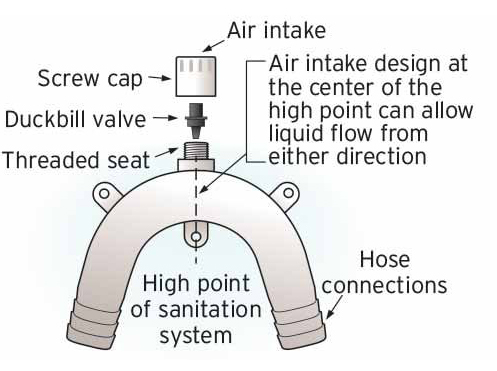

The "Valve" is just a tiny check valve type and no springs.
This illustration (courtesy of BOATUS) should help. (click on it to see it full size).
And btw, the loop in the toilet INTAKE needs to be installed between the pump and the bowl, which requires replacing the short piece of hose the mfr uses to connect 'em with hoses long enough to put the loop at the height it needs to be.
--Peggie
