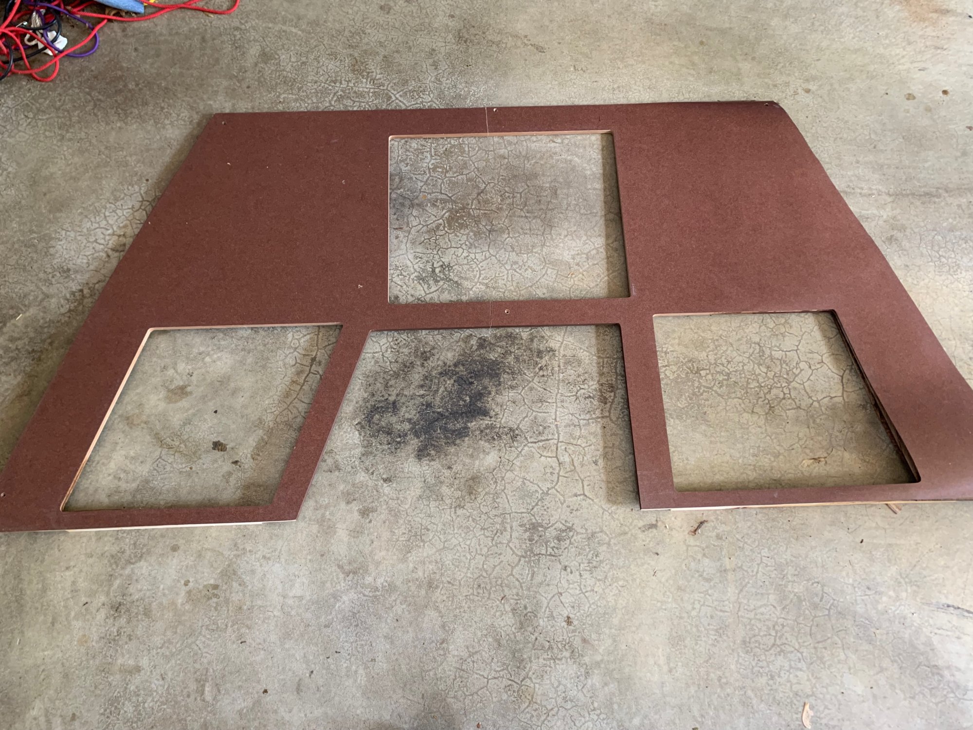

Several years ago, I had a leak in the anchor locker, and the drips somehow migrated to where the soft hull liner met the V-berth platform. This platform (the place where the cushions sit) is/was made of plywood with a brown layer laminated on both sides (linoleum?), and the leak caused the plywood to completely delaminate.

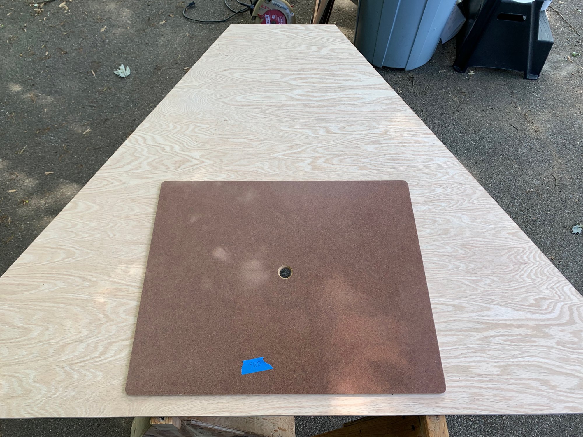

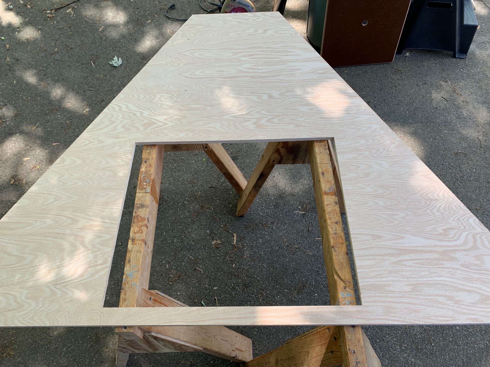

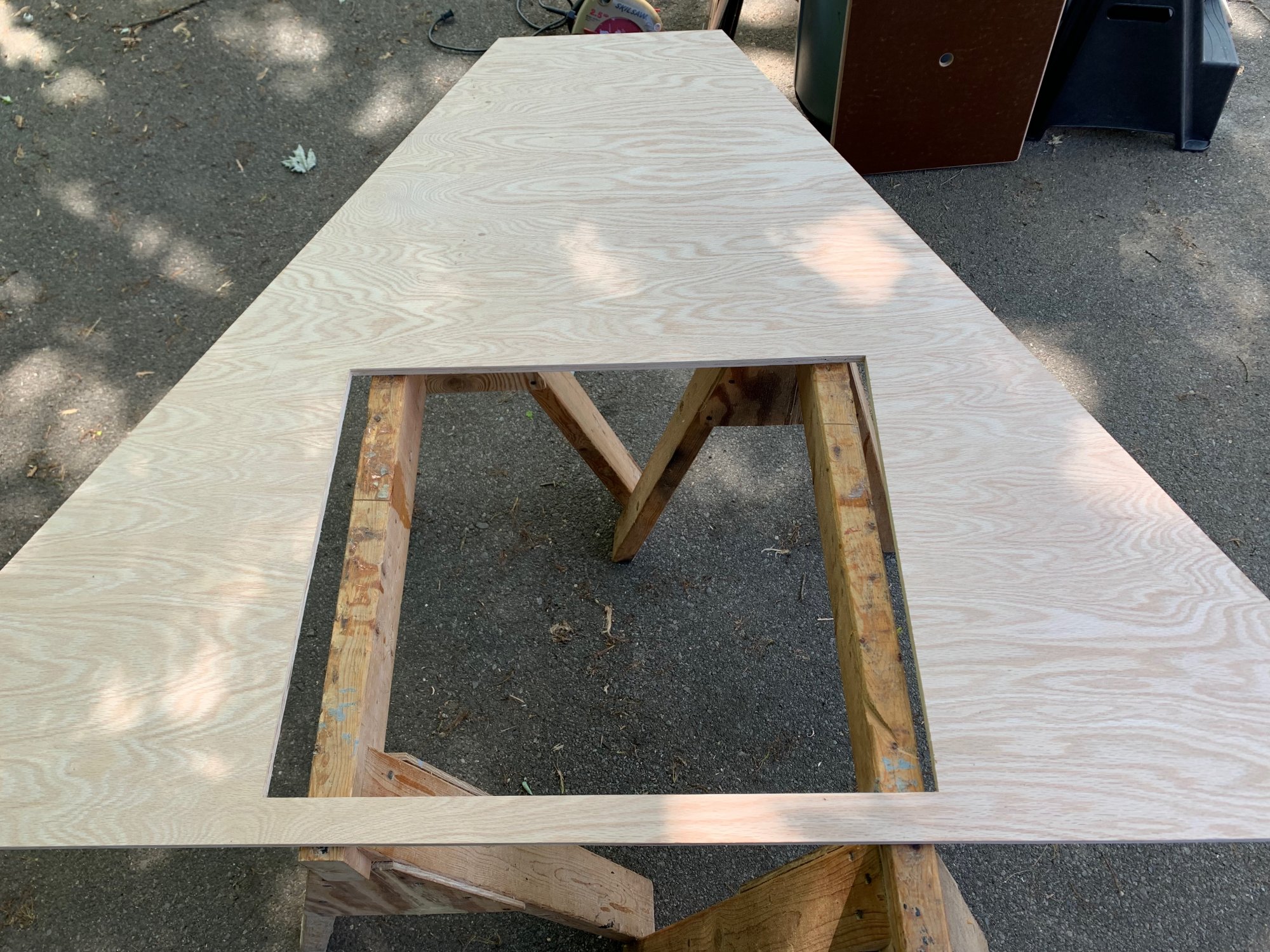

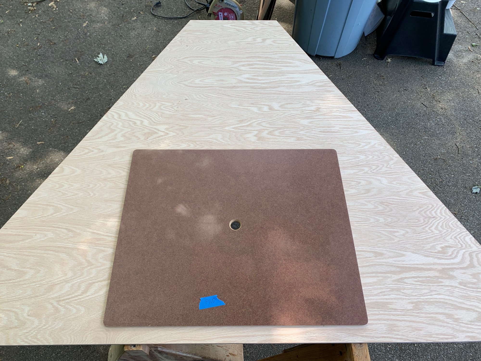

So: I"m replacing the whole platform with some 1/2" red oak plywood, which I will coat with 2 layers of epoxy to waterproof it. My question is this: should I re-use the 4 old hatch covers vs. using the plywood that I cut out of the holes as the new hatch covers? To explain: the old hatch covers have a flange on all edges, so they actually sit 1/2 on top of the platform, maybe 1/4" proud. The new wood covers would be cut-outs, so I'd have to use a plywood strip glued/screwed along the joint underneath to keep the covers from falling through. My only worry is whether this strip will be strong enough to hold the weight of a person. I'd actually prefer to use the new wood covers, since it would look better and the entire platform would be flush, but it's got to hold the weight.

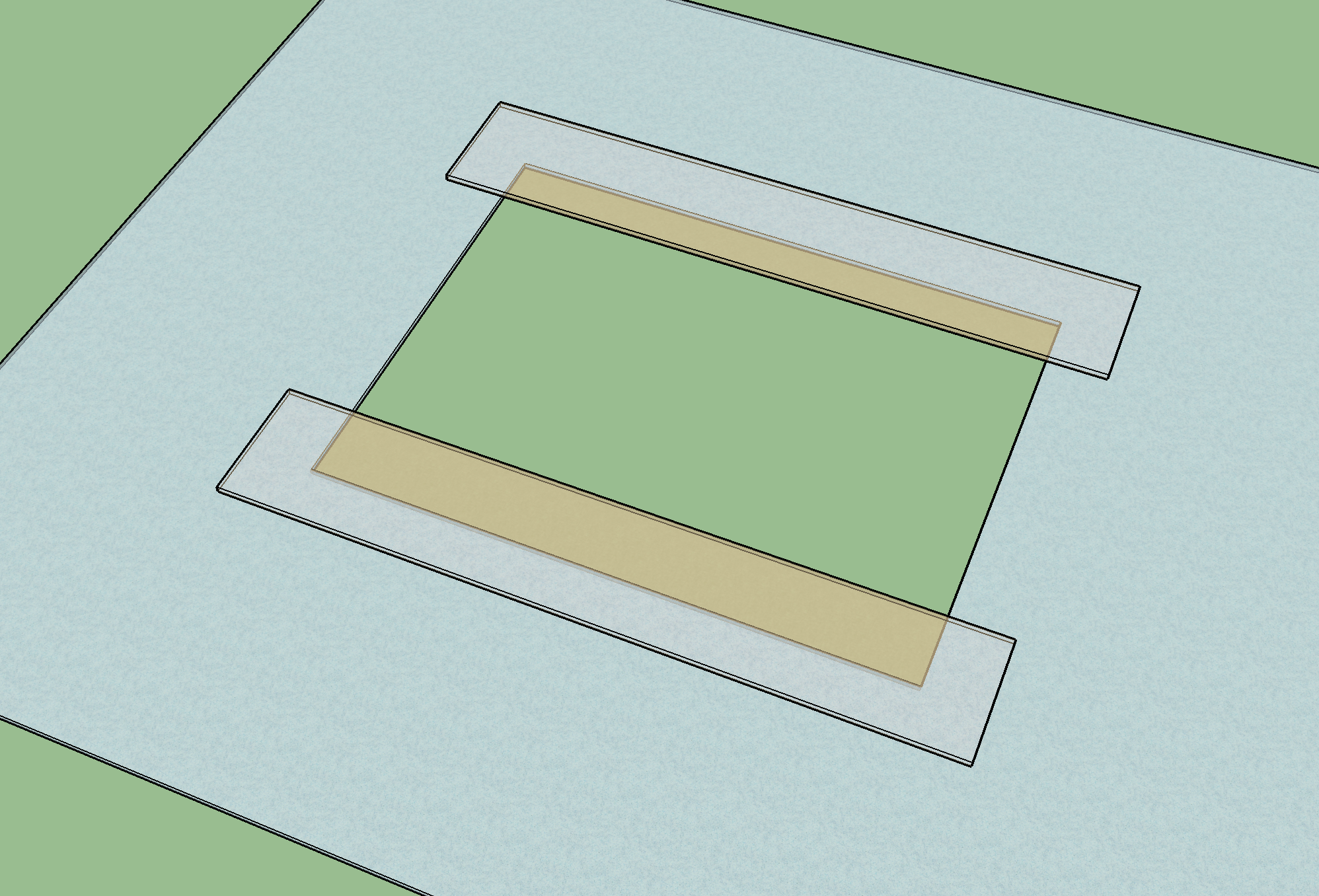

I would use your cutouts and glue/screw some backing strips under the deck to keep the lids from falling in. Your could just do the 4 corners on a diagonal.

If you are worried the glue won't hold, use flat head bolts with nut and washer on the underside. Glued and bolted won't go anywhere.

The original lids on my old h34 have a *cleat* under the top platform. Essentially a half inch by two inch piece of hardwood screwed in from the top so that half of the hardwood supports the lid. The lid is flush on top. There are cleats on the long sides of the opening . The settees in the cabin are done that way and are fine for supporting folks.

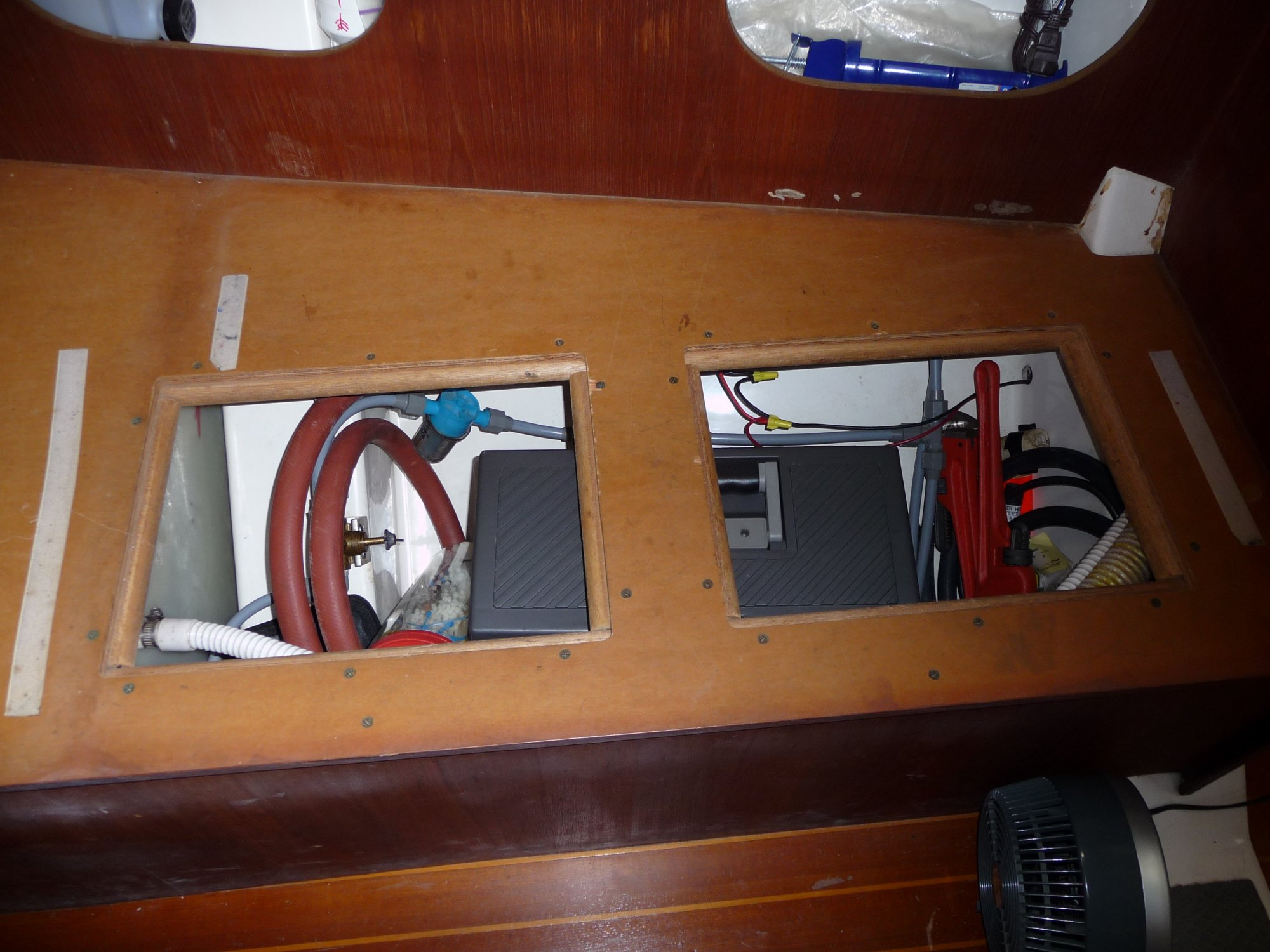

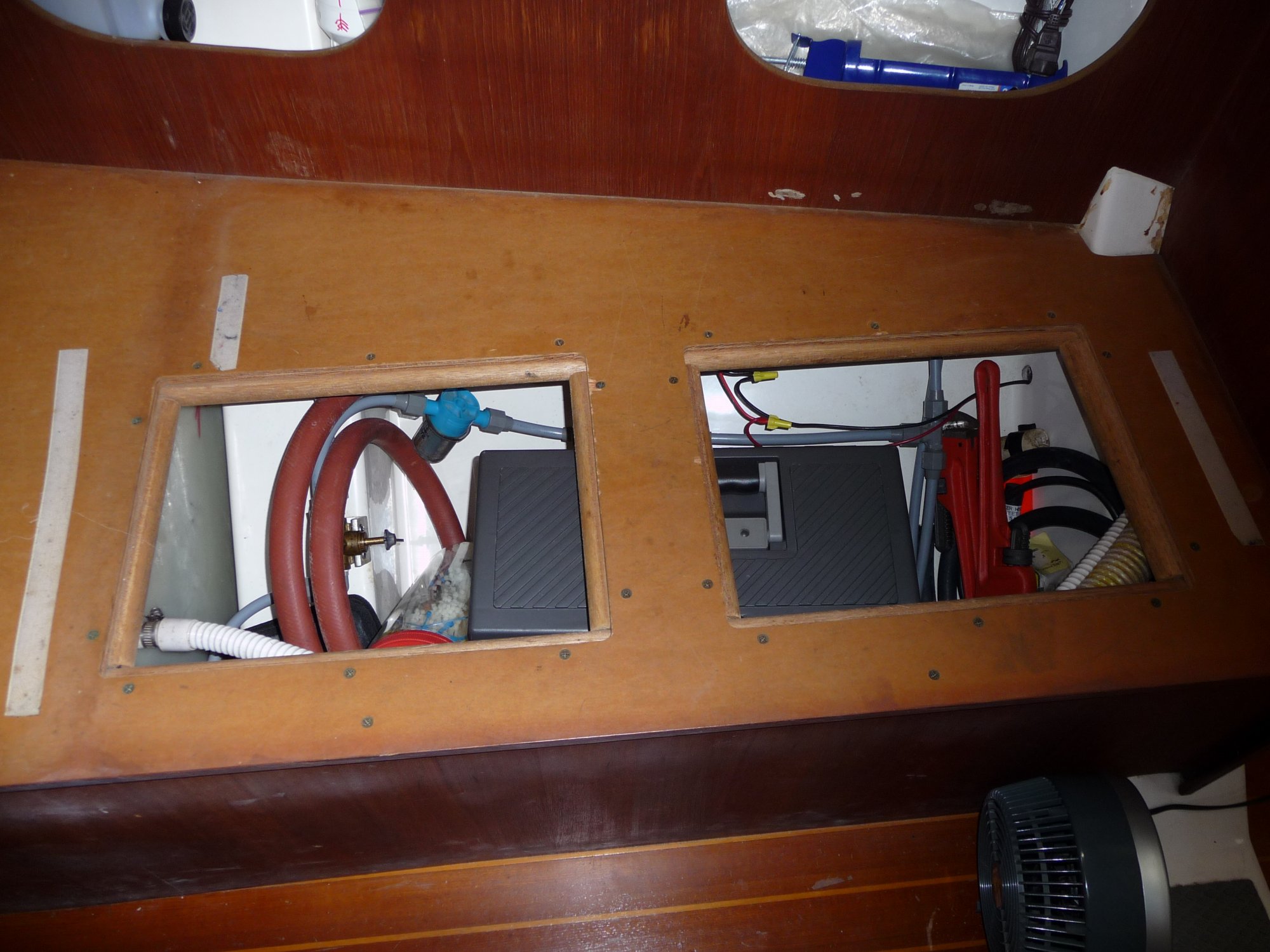

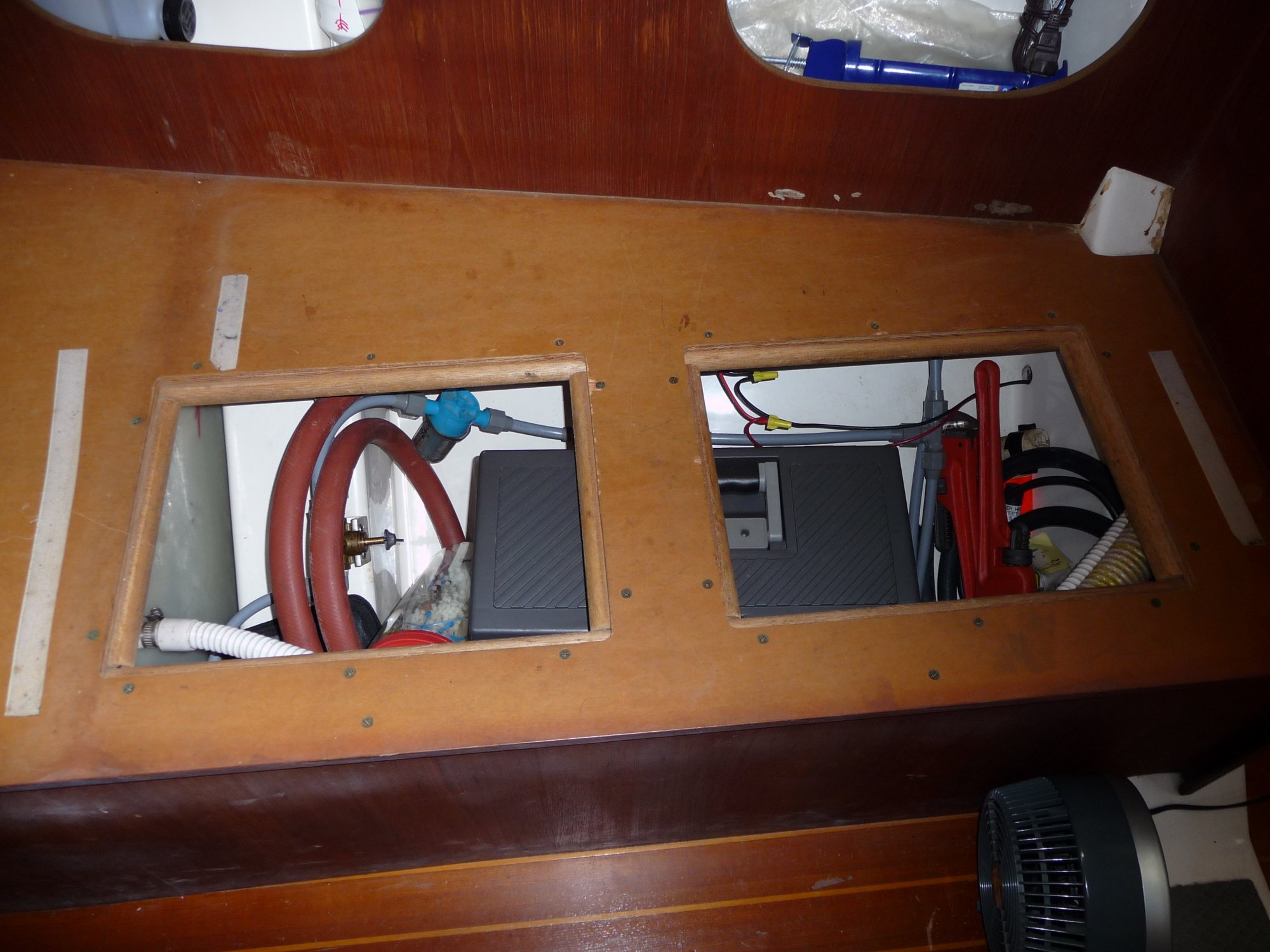

Here is a picture of the cleats that have the lids flush with the surface.. I noted that the cleats were on two sides, but I see in the picture that all four sides of the opening have the backing plates. The edges of the plates are rounded off (bull nosed) so stuff doesn't snag .. I weigh around 240 pounds and this has not failed in the 40 years that the old girl has been around .

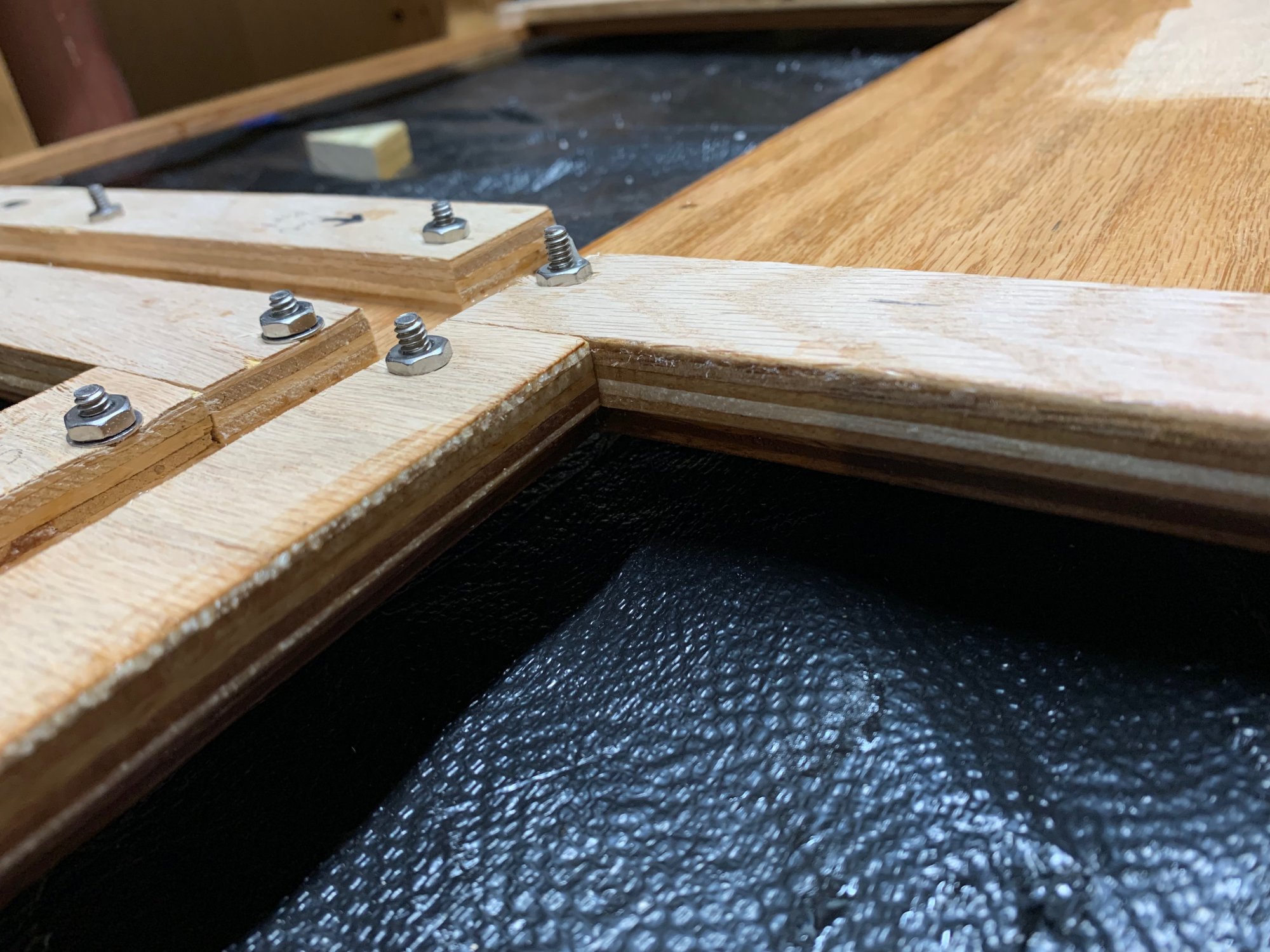

Thanks. I think I'll use 2" of 1/2" plywood with bolts and epoxy. Should work well.

I would use the cutout but put strips on the bottom of the main piece that go all the way across the hole. Much stronger this way. Flush is the way to go. I can notice small imperfections under my hybrid mattress at home

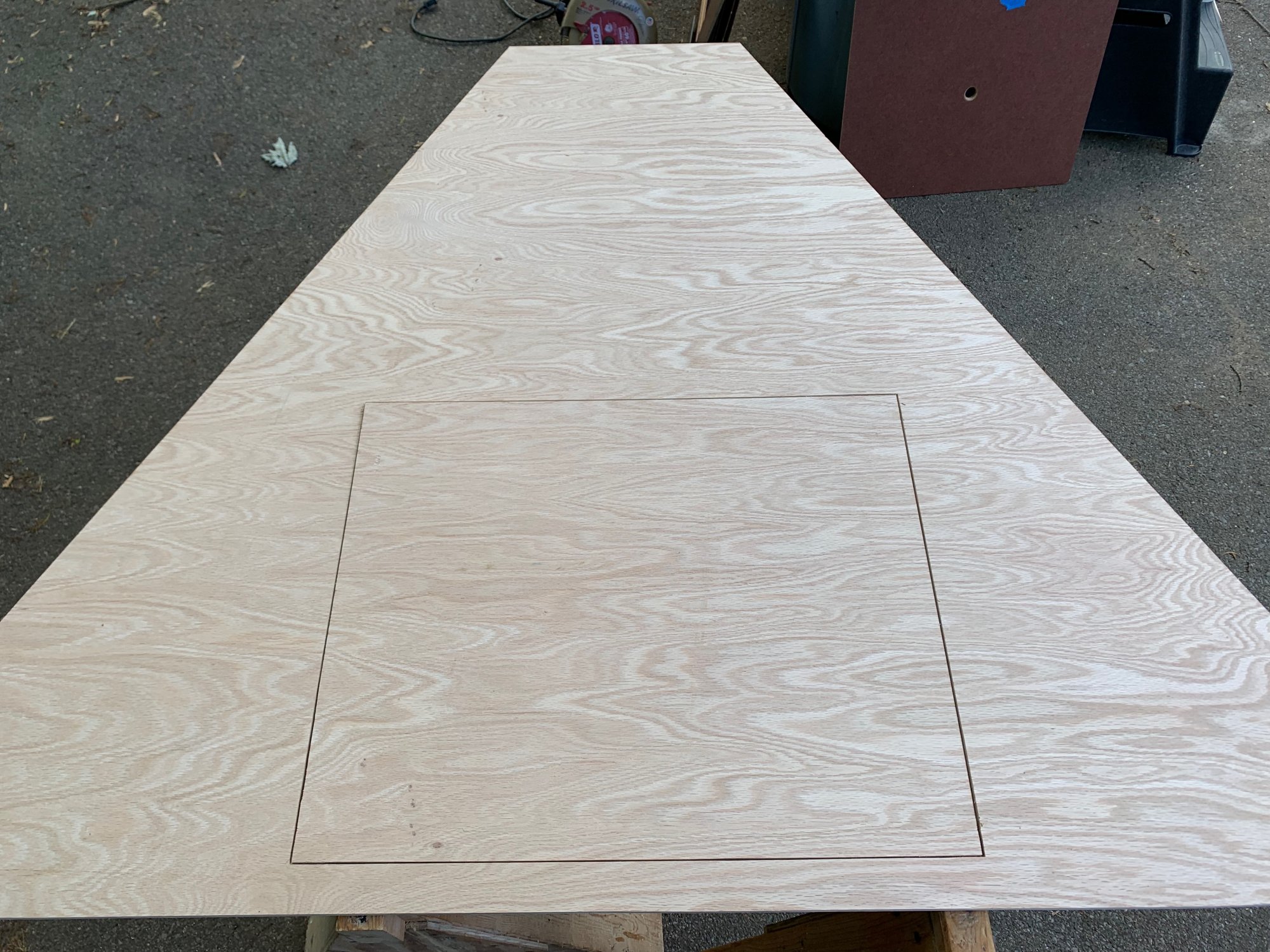

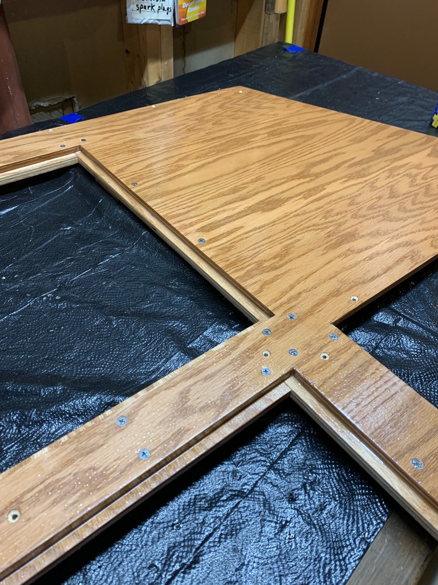

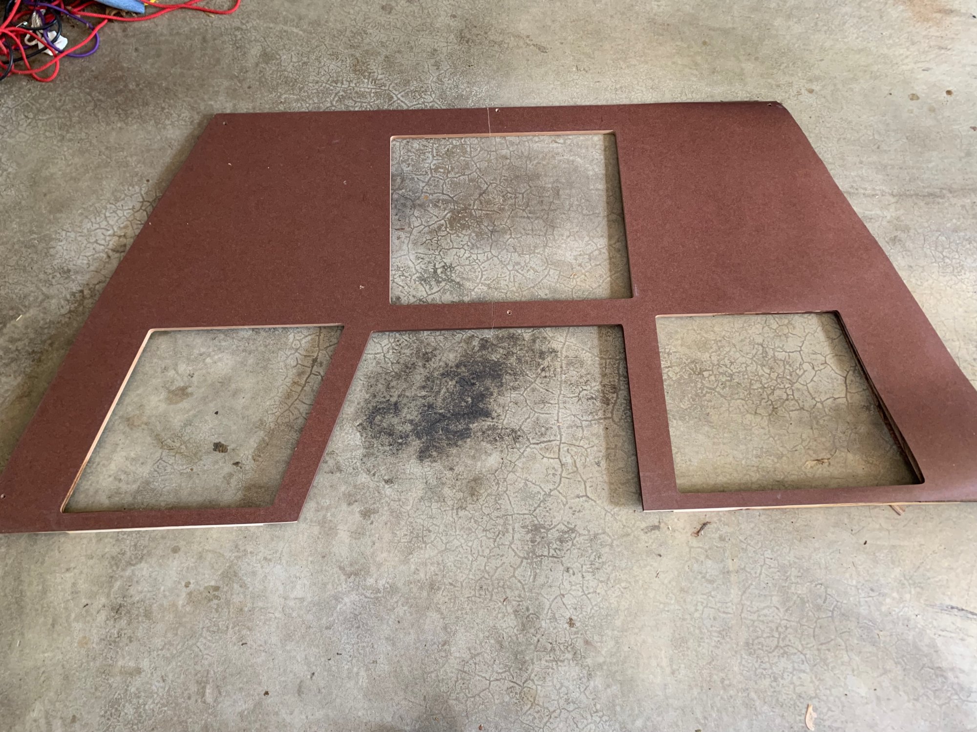

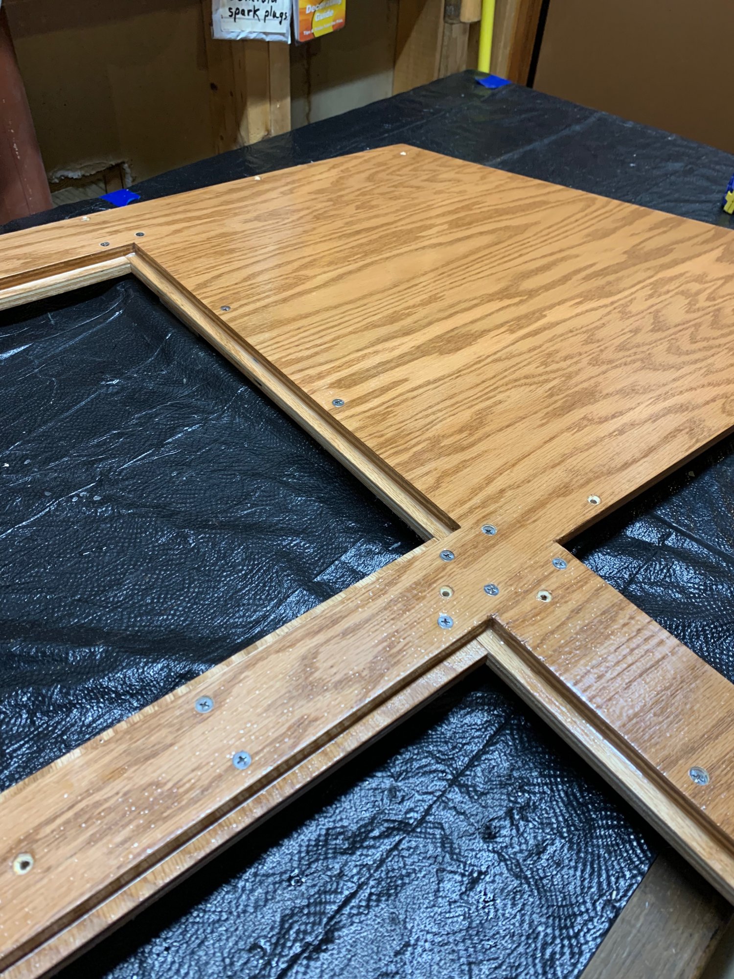

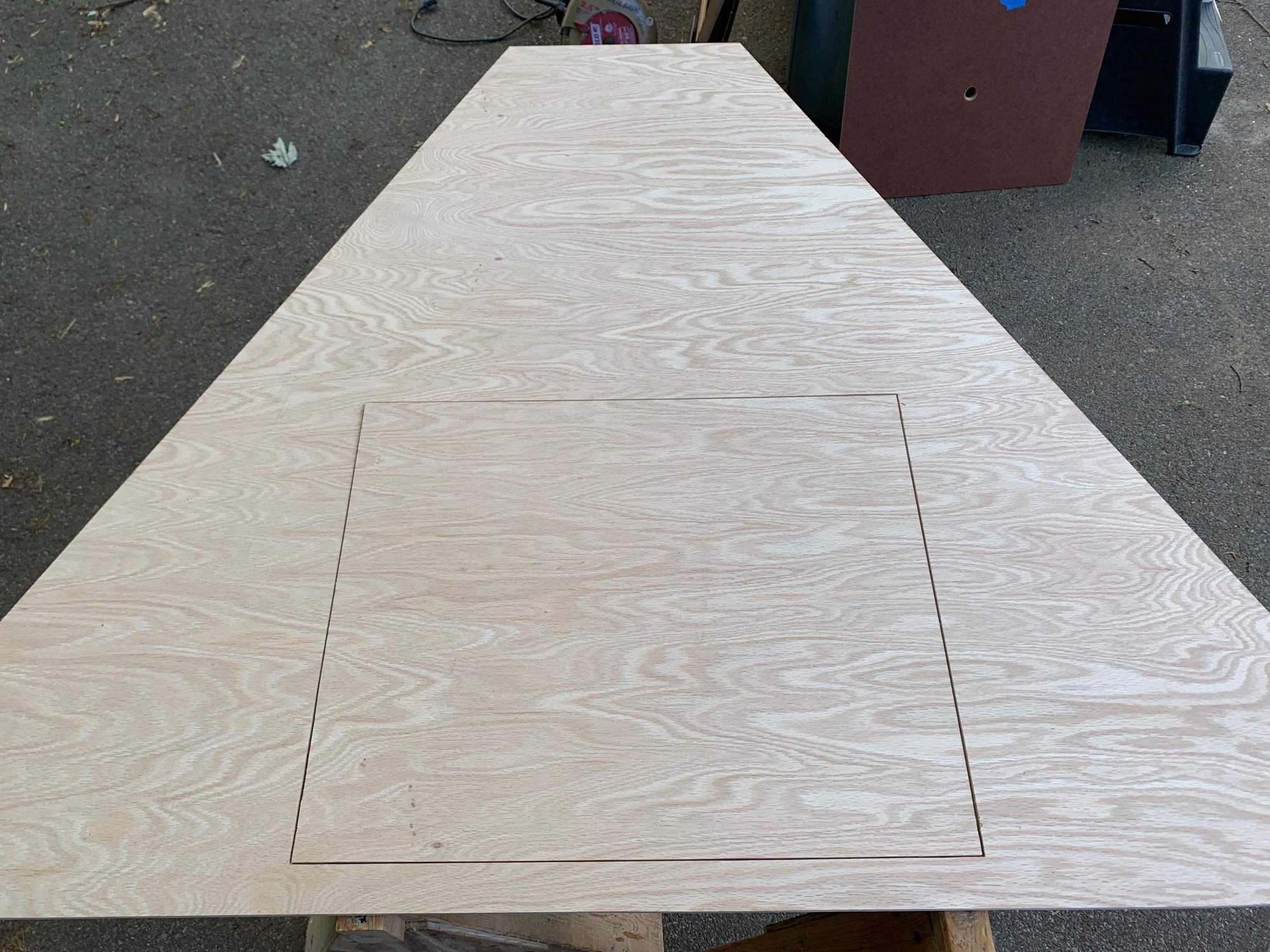

Thanks for the replies. I did lots of work over the weekend, mainly trimming the 3 sections to fit in the boat: the forward piece is in the picture above, and the old aft piece is the last of 4 pictures. As you may be able to see, the aft piece (the brown colored thing with 3 hatches and one filler section), I had to cut in 2 to get it out of the boat. Clearly, they installed it before the deck went on. So I have 3 sections to fit, and a few more access hatches to cut. It should all go smoothly, but it's pretty fiddly work to cut out the access hatches when you want both the larger piece and the access hatch to be perfect. I've got a system down now, though, so it's going ok.
On other news, I probably need to get the bottom painted and launch before finishing all of this, since I'm paying for dry storage by the day. Also, I can sail and still use the aft cabin while working on the v-berth, even if the finish work takes a few weeks.

No, I'm just going to go with water-based stain and 2 coats of epoxy (maybe more on the edges). I think/hope that the natural wood will look better than the brown stuff on the rare occasions when the cushions aren't on top of it.
BTW: it does look like the brown laminate was extra glued on top of 1/2" plywood, as the original was actually thicker than normal plywood. (Of course, 1/2" plywood isn't really 0.5 inches, but whatever: I measured both with calipers.) I considered going with thicker plywood, but 5/8" seemed overkill. I decided it didn't really matter, as the surface has good support from the vertical bulkheads and the tabbed-in support along the hull, and I'll probably put in some extra bracing in a few places that wasn't there originally.

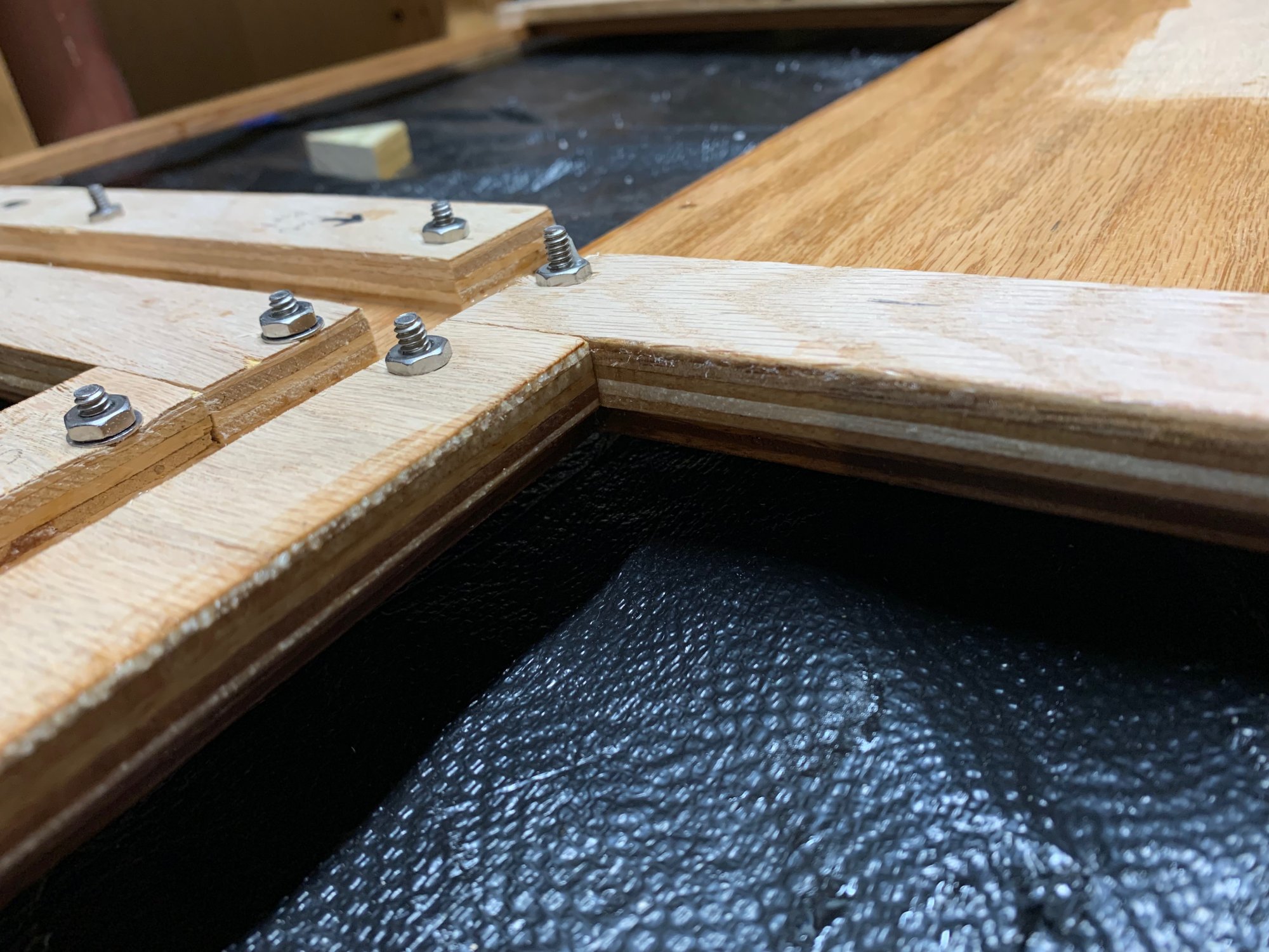

Quick question: I'm thinking about grinding off the extra length of the 10-24 1-1/4" stainless machine screws that I used to attach the wood strips (in addition to thickened epoxy). The protruding shafts and the nuts are hidden inside lockers, so it's not all that important, but I still feel like it would be worth it. My question is: what tool should I use to make the shortest work of this?
I have a rotary Dremel tool (that I inherited and have never used) and a much larger reciprocating Dremel tool (one with a large selection of flat blades). I also have a bench grinder, but would prefer not to remove all the screws. I do not have a traditional large hand-held grinder.

for the bolt ends, either use shorter ones(I know more expenses) rent or buy a cheap angle grinder (can find cheap if used)
Your profile doesn’t mention where about you are located, I am sure you could find a generous soul to lend you one, then you just buy a grinding disk and go from there.
The small rotating dremel might not like you with that task, but with the other one and good blades, it is possible
good luck

Honestly, I usually just use a hack saw with a good fine tooth metal blade in it.... It doesn't take long cutting off bolts and there are not fines flying all over... A file then takes off the end burr...
dj

Well, the obvious answer is "just try using what you've got", which I'll probably do. If it were 2 or 3 bolts, I'd do the hacksaw thing, or use the bench grinder. We're talking 4 screws per wood strip times maybe 14 strips, and I'm less enthusiastic about doing that the slow manual way...
