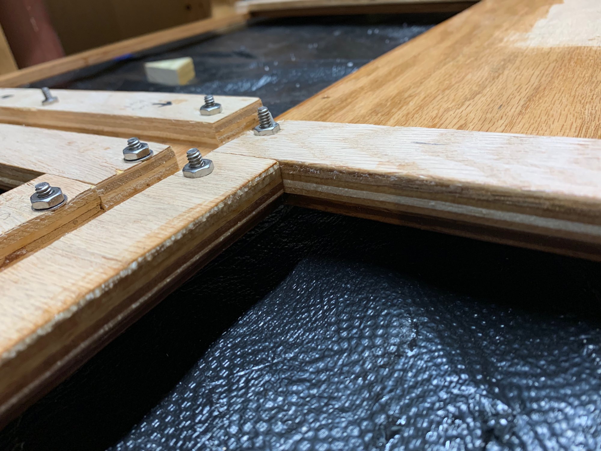

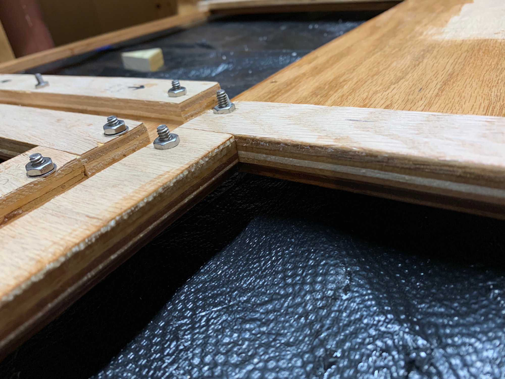

So this is taking way longer than it should, but it's getting close to being done. I'll have some better pictures of the finished V-berth platform when... it's finished, but:
Quick question: I'm thinking about grinding off the extra length of the 10-24 1-1/4" stainless machine screws that I used to attach the wood strips (in addition to thickened epoxy). The protruding shafts and the nuts are hidden inside lockers, so it's not all that important, but I still feel like it would be worth it. My question is: what tool should I use to make the shortest work of this?
I have a rotary Dremel tool (that I inherited and have never used) and a much larger reciprocating Dremel tool (one with a large selection of flat blades). I also have a bench grinder, but would prefer not to remove all the screws. I do not have a traditional large hand-held grinder.
Acorn nuts and possibly some washers if the lengths are off would be the easiest. Use a drill/impact to tighten them down if you want to save time. If I didn't want to spend any money and as little time as possible, I'd use and angle grinder. 5-10 seconds per screw.

Well, I did ask for advice on what's easiest. I'll try a hacksaw. :)

...the final answer is: bought some carbide blades for the reciprocating tool. It took about 5-7 seconds each, with minimal effort. Did leave the cutoffs just about glowing red, though. Thanks for the input!

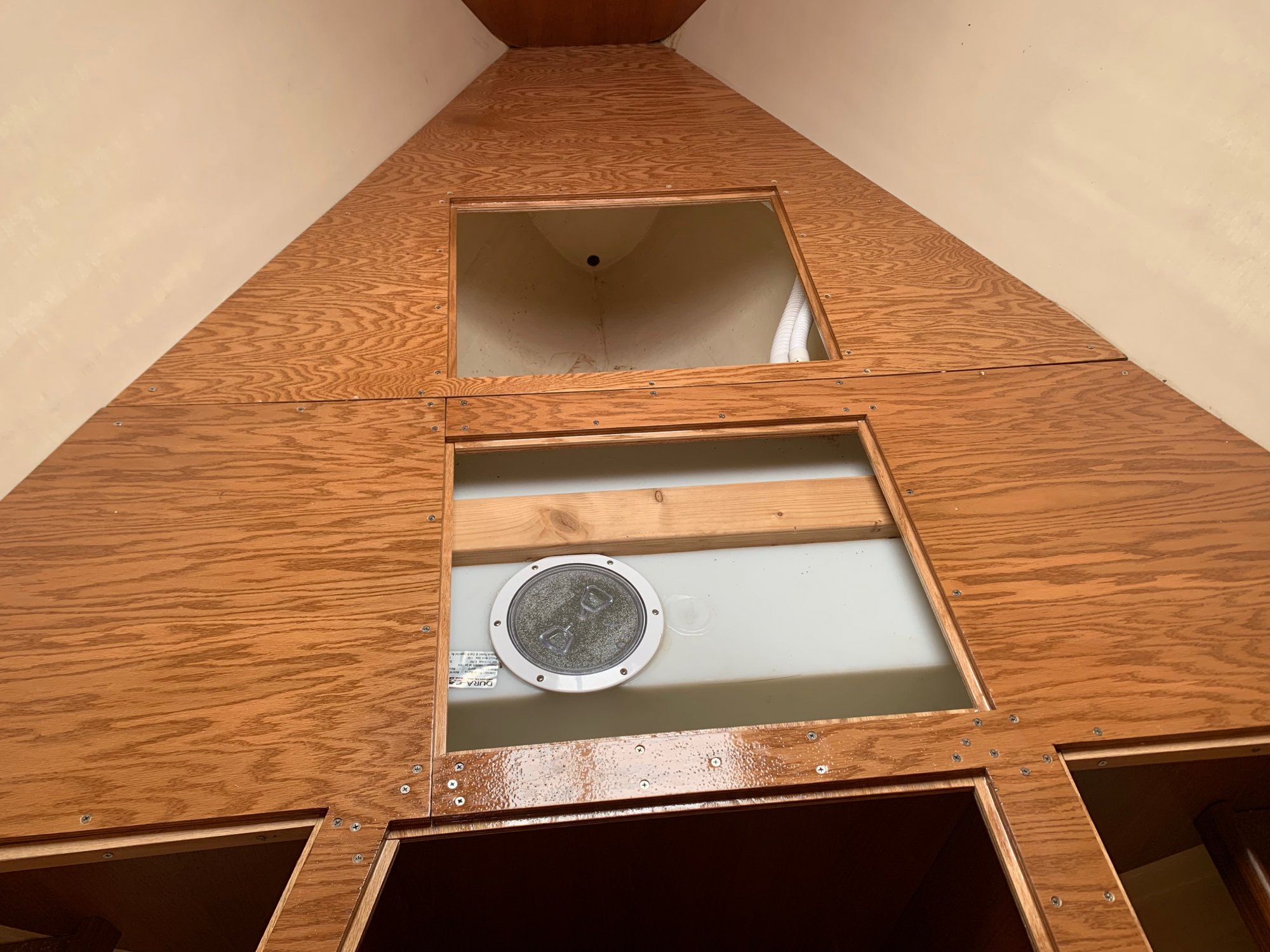

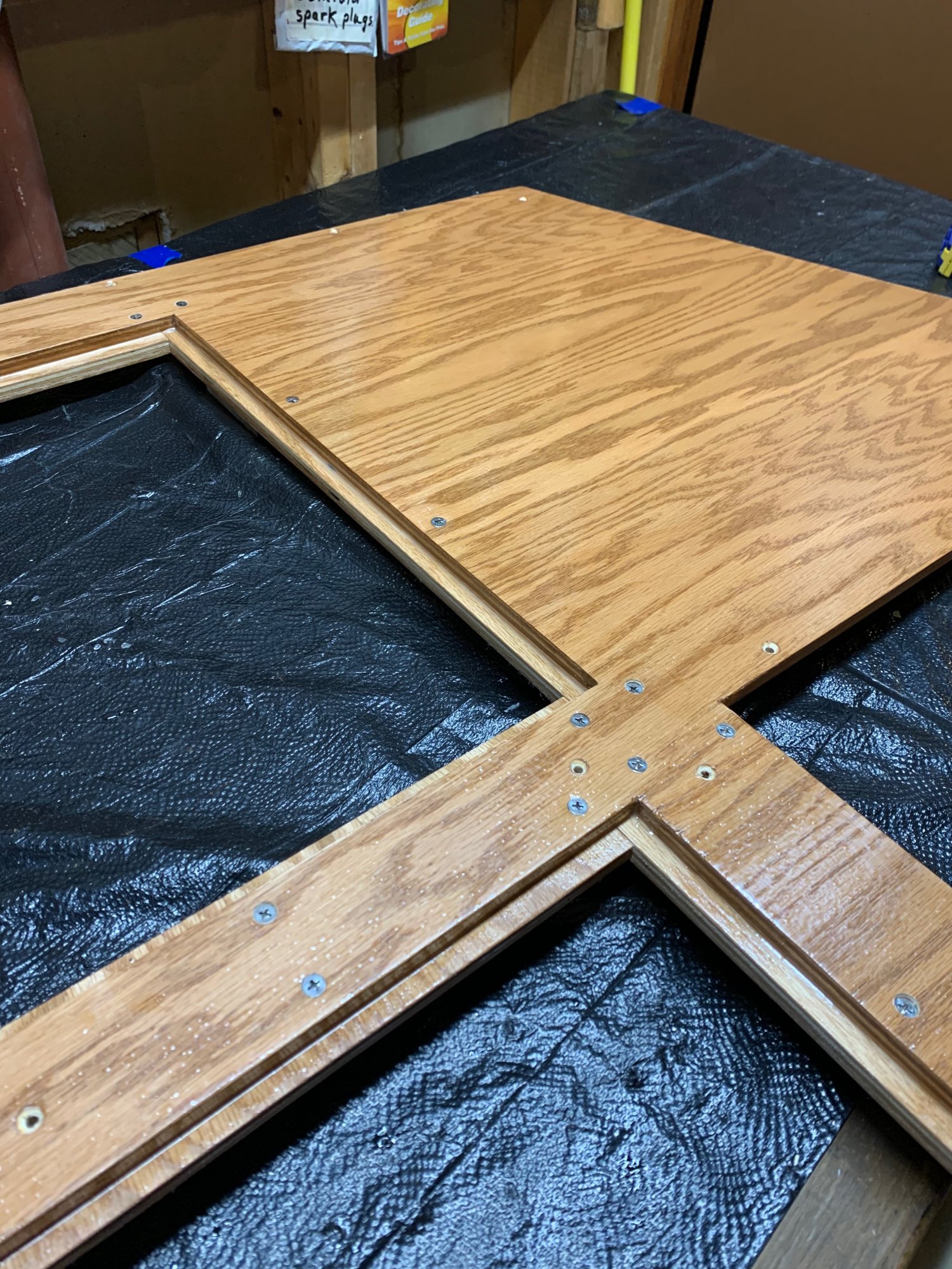

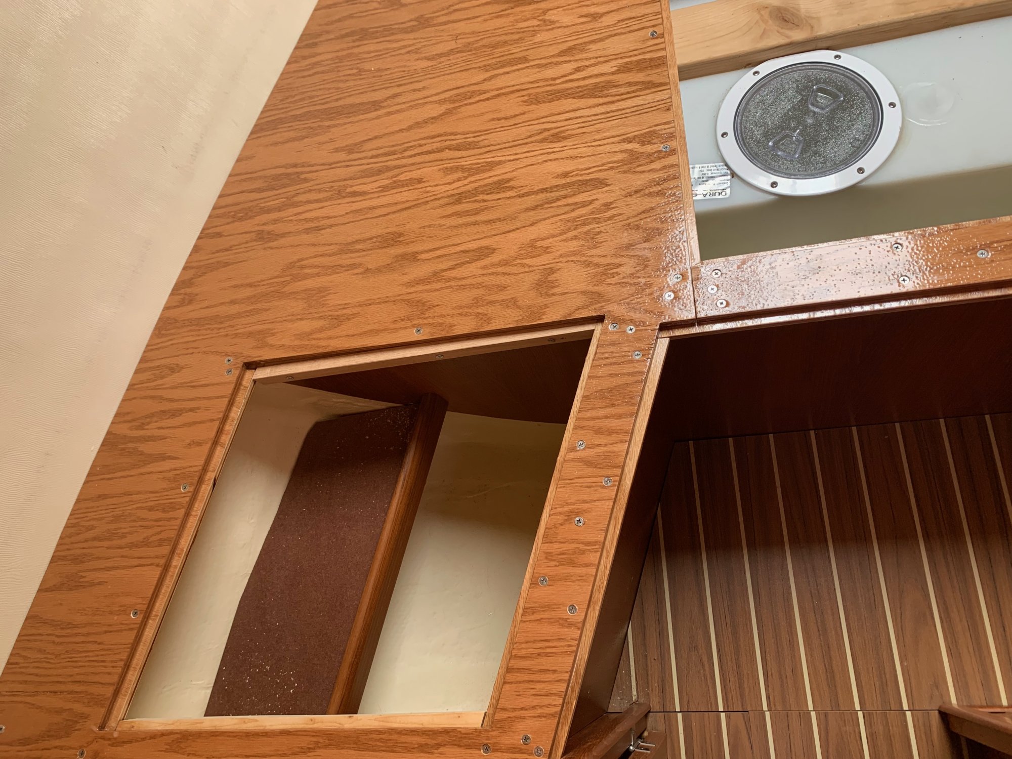

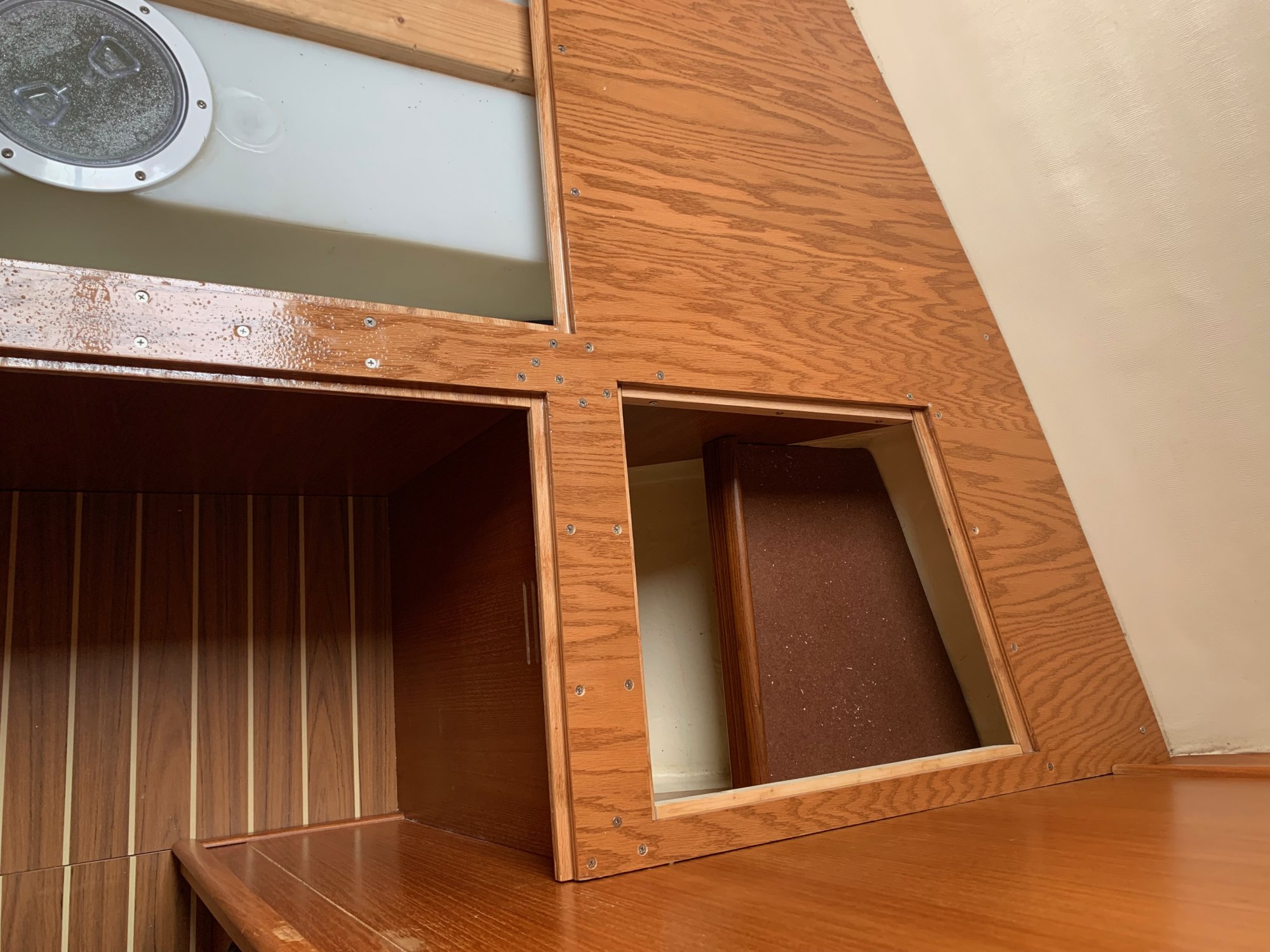

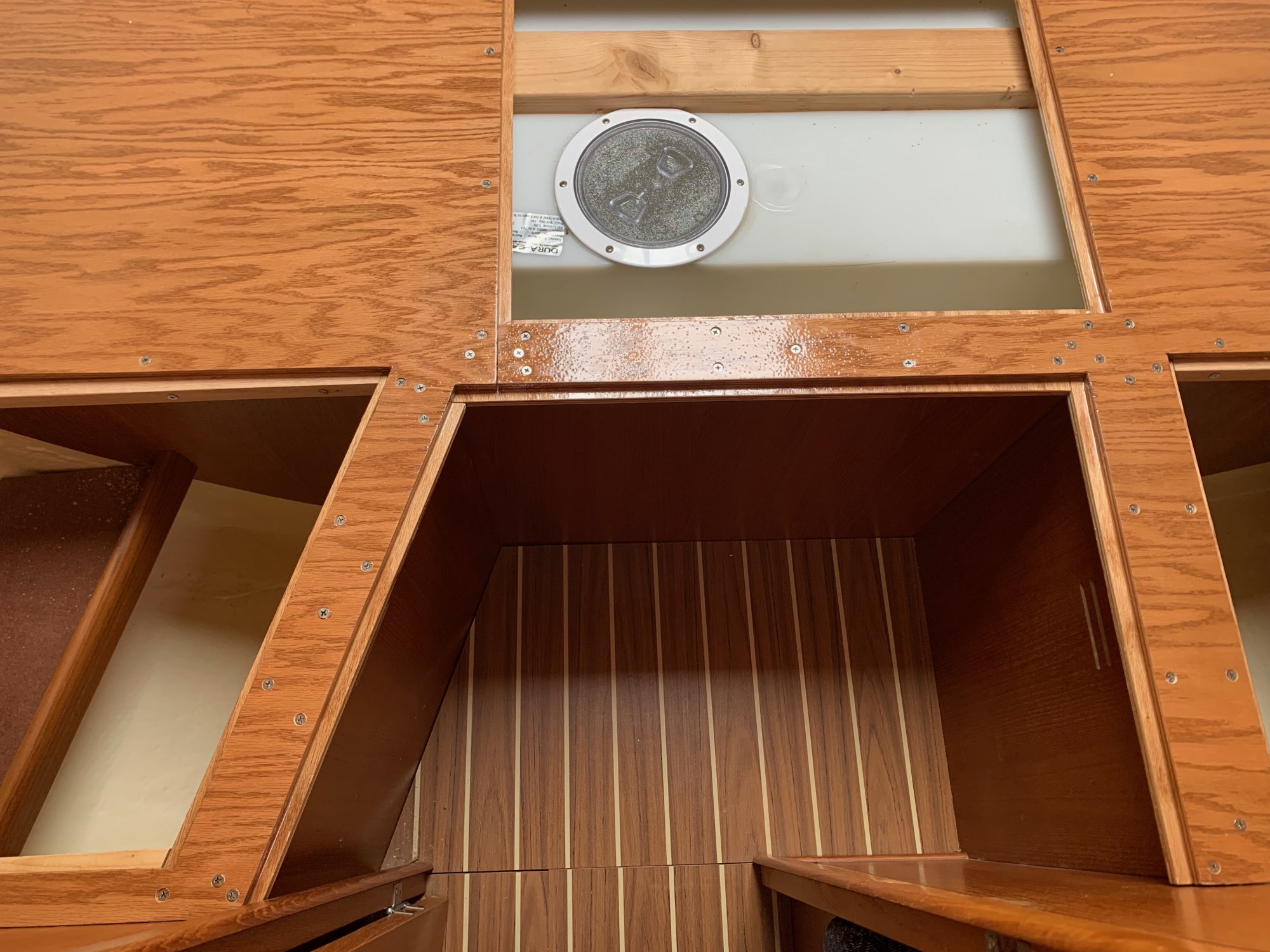

Nearly final install. It's hard to explain, but there are thin plywood flanges glued and epoxied along most of the edges of the hatch openings. But there were 5 edges where it just wouldn't work, so I had to bolt the flange to a bulkhead. I just finished that today, and screwed down the whole platform for the upcoming traditional Memorial Day trip. A few pictures:
I still owe the project a final coat of epoxy, as well as some stain and epoxy on the strips I installed today (bolted to the bulkheads), but it should be fine for awhile as is. This project was _way_ more work than I expected. Coating the wood with epoxy is much harder than using (say) Minwax Polycrylic, but I was hoping it would be better for waterproofing.The existing finish has way more small bubbles than I feel good about, so it needs a final sanding and a final rolled-and-tipped coating.
