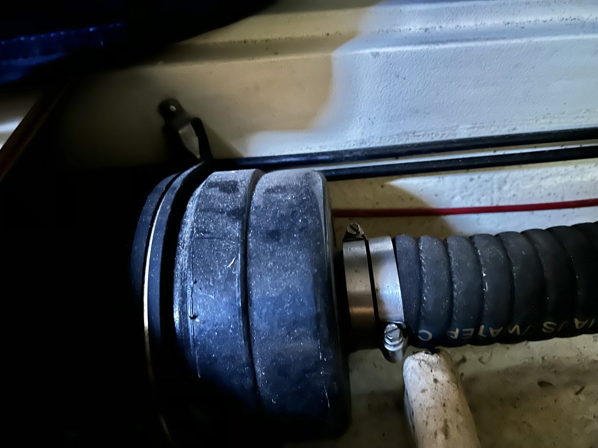

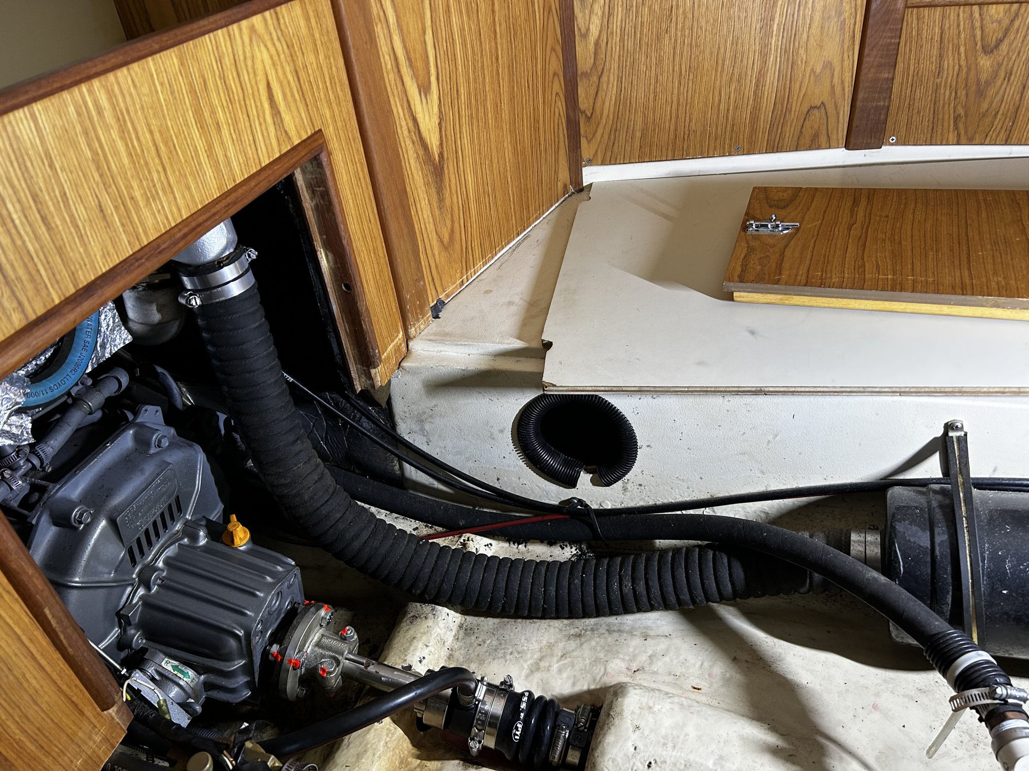

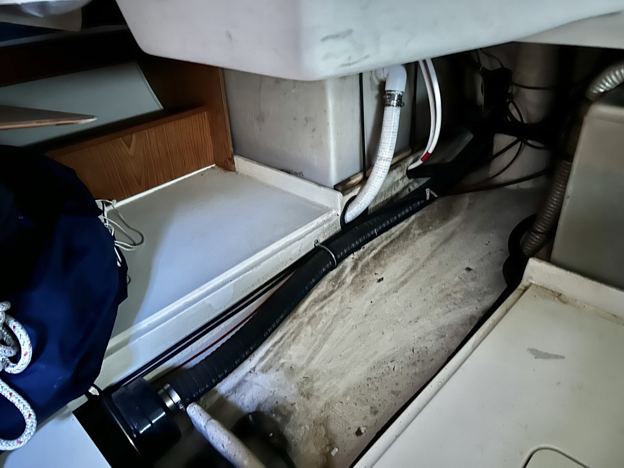

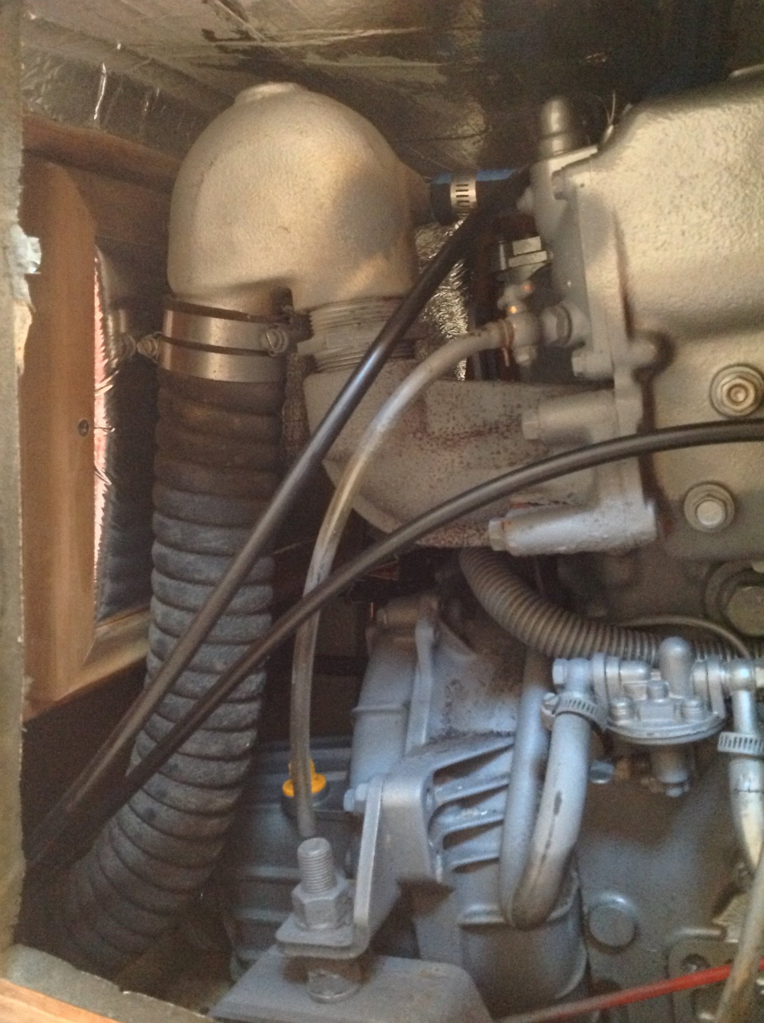

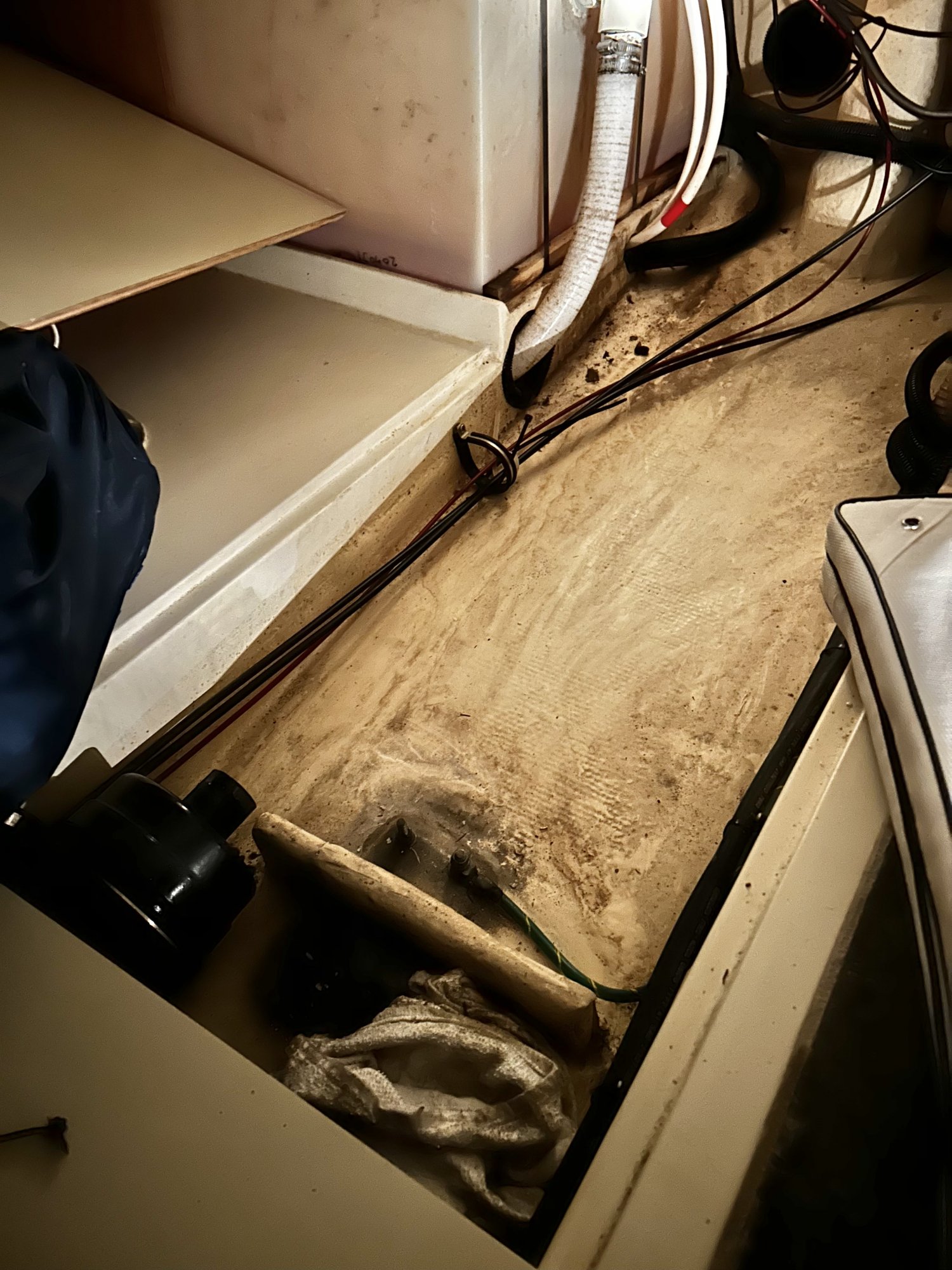

On my 2000 Hunter 340, I have to replace the Wet Exhaust Hose from the Muffler to Hull exit. It developed a pinhole or crack, naturally behind the hose where I can‘t see it.
It’s leaking in the rear starboard locker. Fortunately it looks like a straight run from the muffler to the rear locker until the loop.
I’ve asked here on the SBO site, I would to know the Inside Dimension and approximately the length of new hose needed from anyone who has done this job and any guidance you can offer.

It is most likely 2" ID. To get a fairly accurate length you can run a plumbing snake (or garden hose in a pinch) through the hose, but you'll need to disconnect it from the muffler and probably where it exits the hull. At that time, you can measure the ID. Add a bit of length to the new hose so you don't come up short.
Mar 6, 2008
1,517
The information you are looking for should be stamped on the hose itself regarding the diameter. I took mine out and stretched it on the ground and measured it. It was 12 feet.

Thanks Brian / Joe. That’s what I thought when I looked at it this morning.
To be honest I wasn’t in a very good mood when I wrote this post. Seeing a small puddle under the hose where it exits the into the locker just ps..d me off.

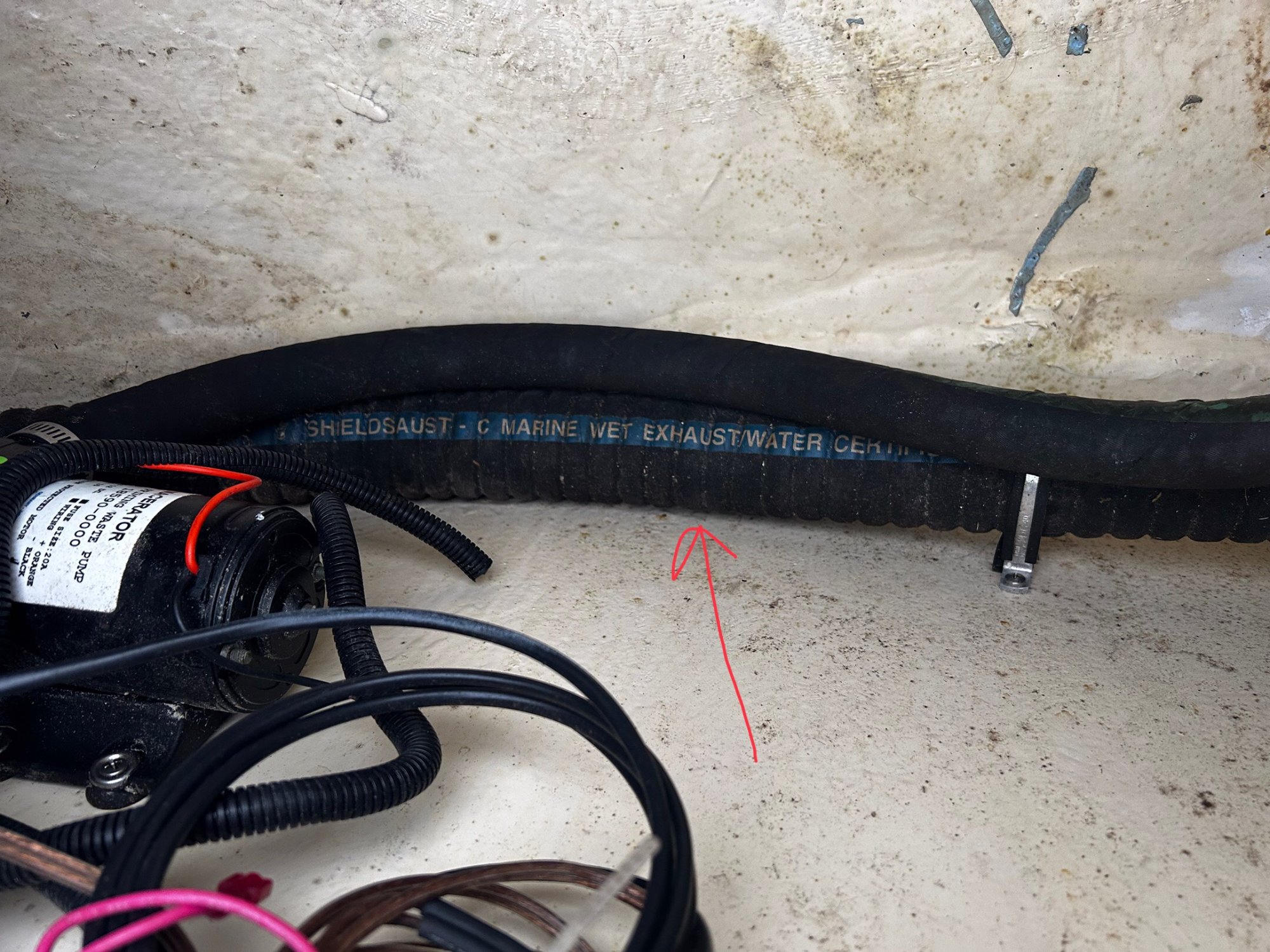

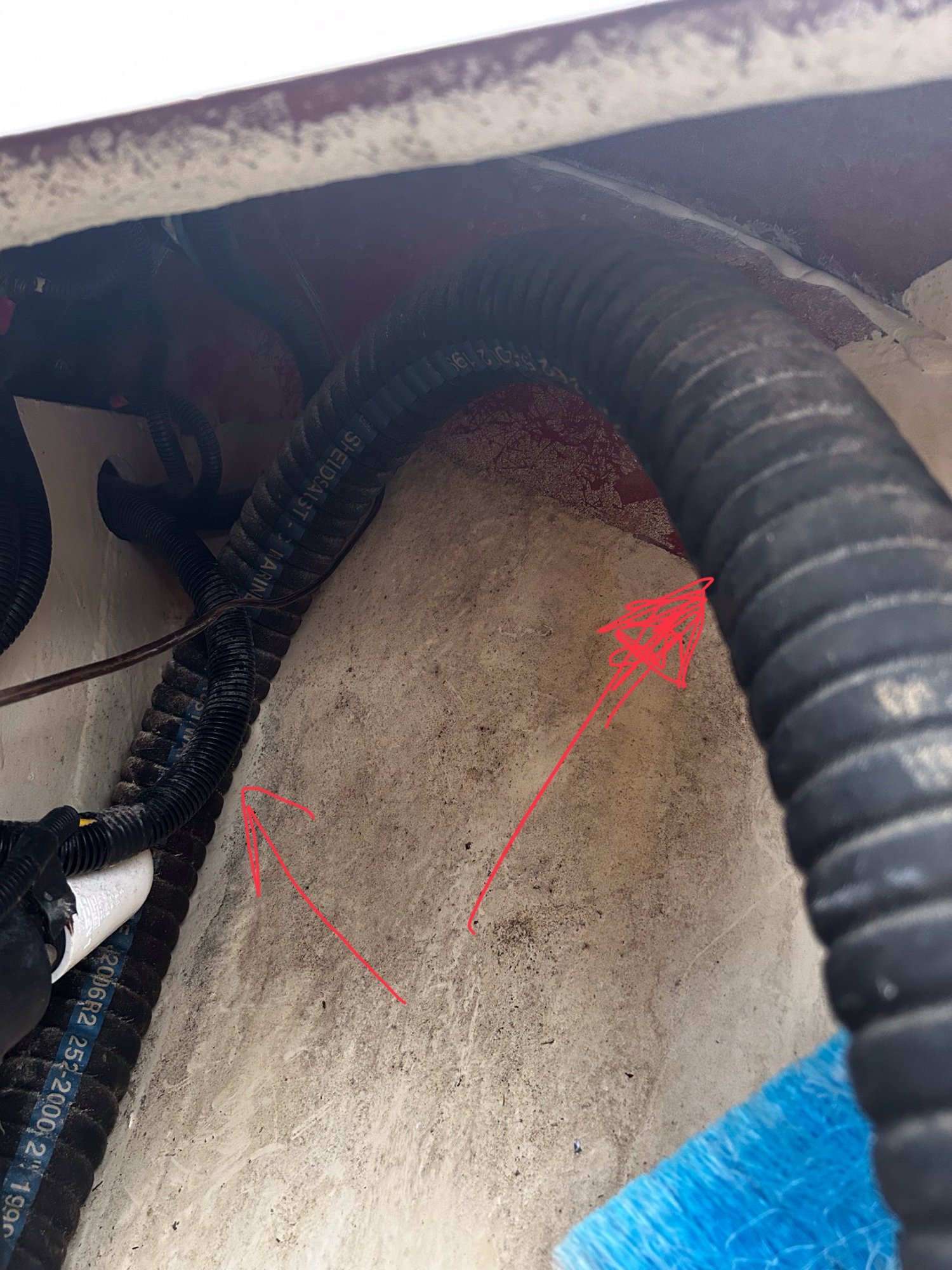

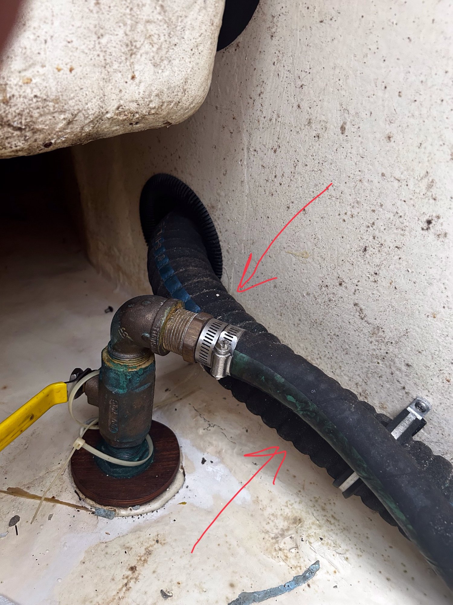

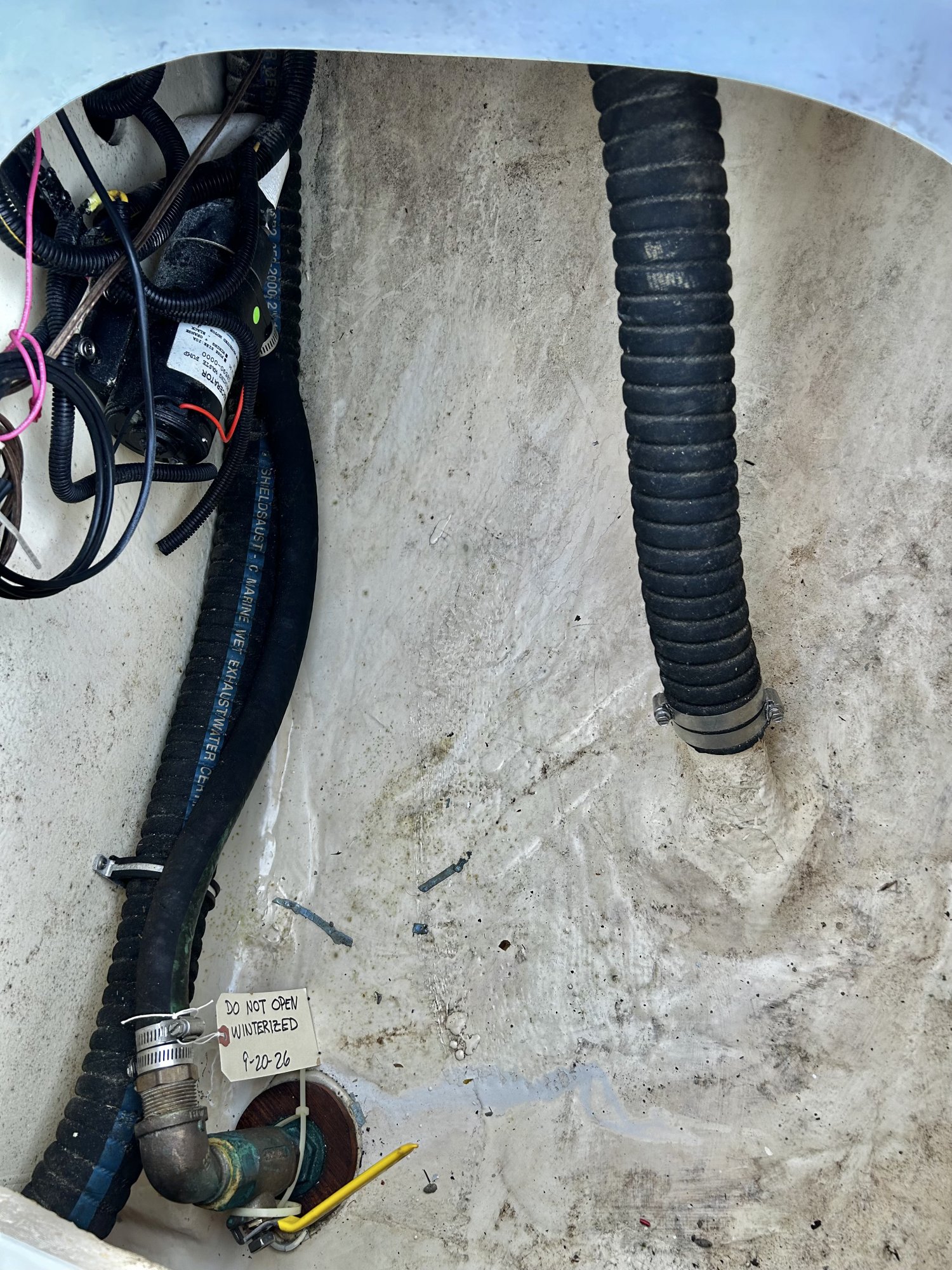

The arrows in my photos are NOT where the leaks are coming from, they’re only there to point out the hose itself. As someone thought it was the macerater hose I was talking about.
The leak is actually at the left side of the top of the loop and it drips down the hose and forms the puddle. Not a lot, but a leak for sure.
My plan was to do as you suggested when the boat comes out next week. Disconnect the ends and run a snake in it.
My concern is it a one man job. Any sealants involved.

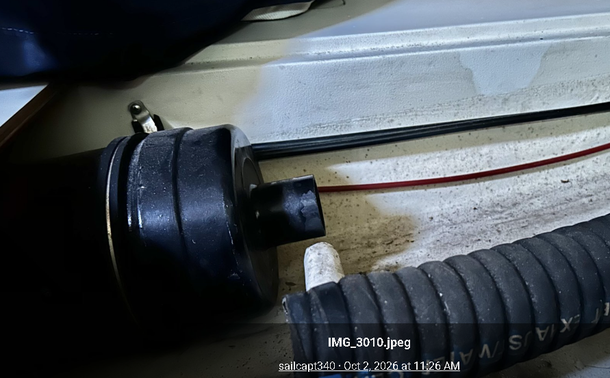

I did try to find a marking on it somewhere telling me the dimension but, if you can believe it, whoever put this in managed to lay the entire hose with only the words you can see showing in my photos. So frustrating!
I didn’t want to take off too many of the brackets holding it in place and start moving the hose. If this is brittle in any other areas other than the high side now, I didn’t want a disaster on my hands while still in the water.

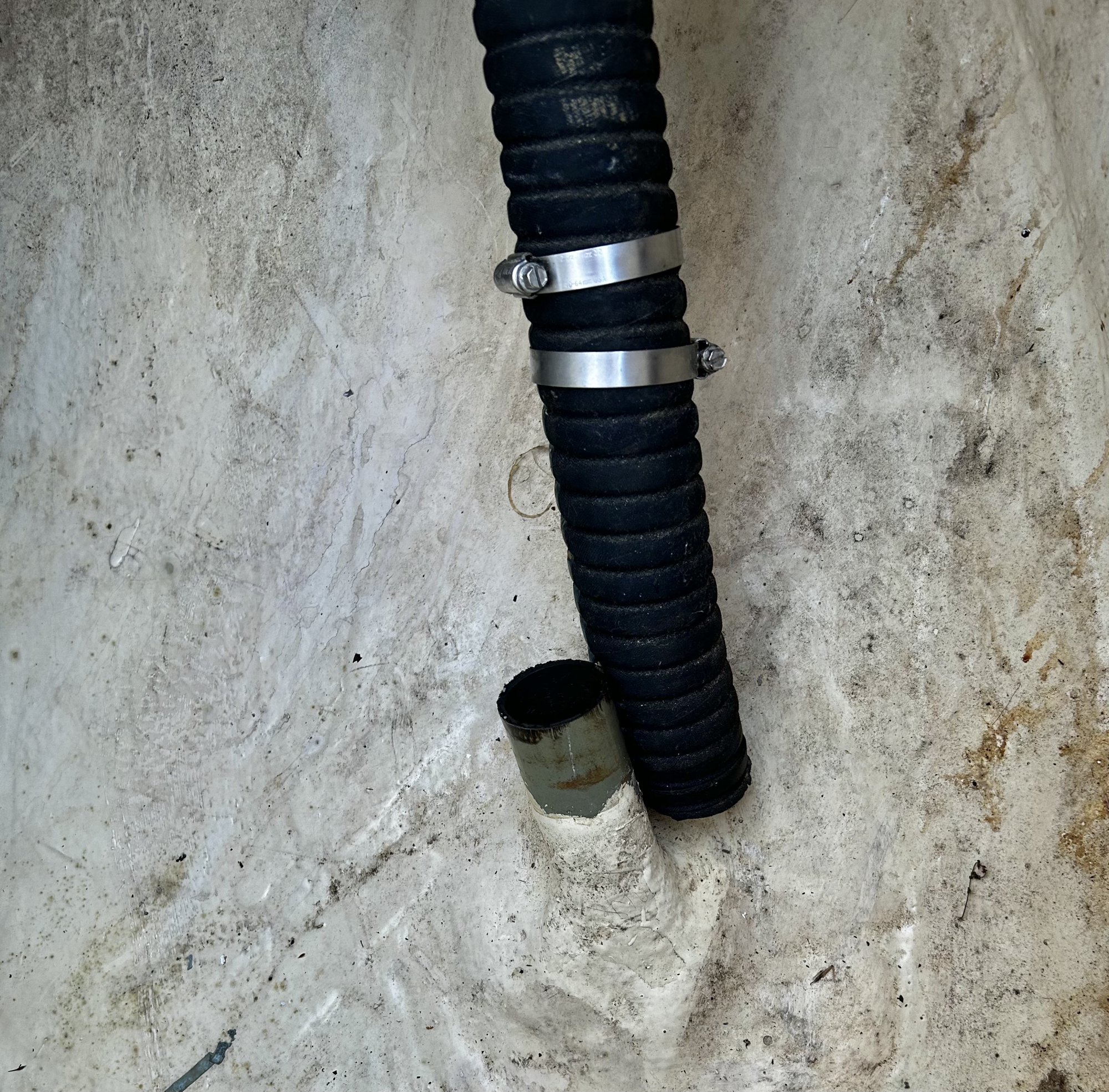

One man job which I installed about 5 years ago. Absolutely no sealants anywhere. The hose in the loop looks different than the other hose upstream. The protruding reinforcing wire is likely what caused your leaks.
Follow the instructions above for length.
The hose next to your macerator is the factory install which came with my boat. Lasted 20 years without any complaints. Don't cut corners here with $$$ as you're not worried about the water leaks, it's the CO leaks which will get you first.

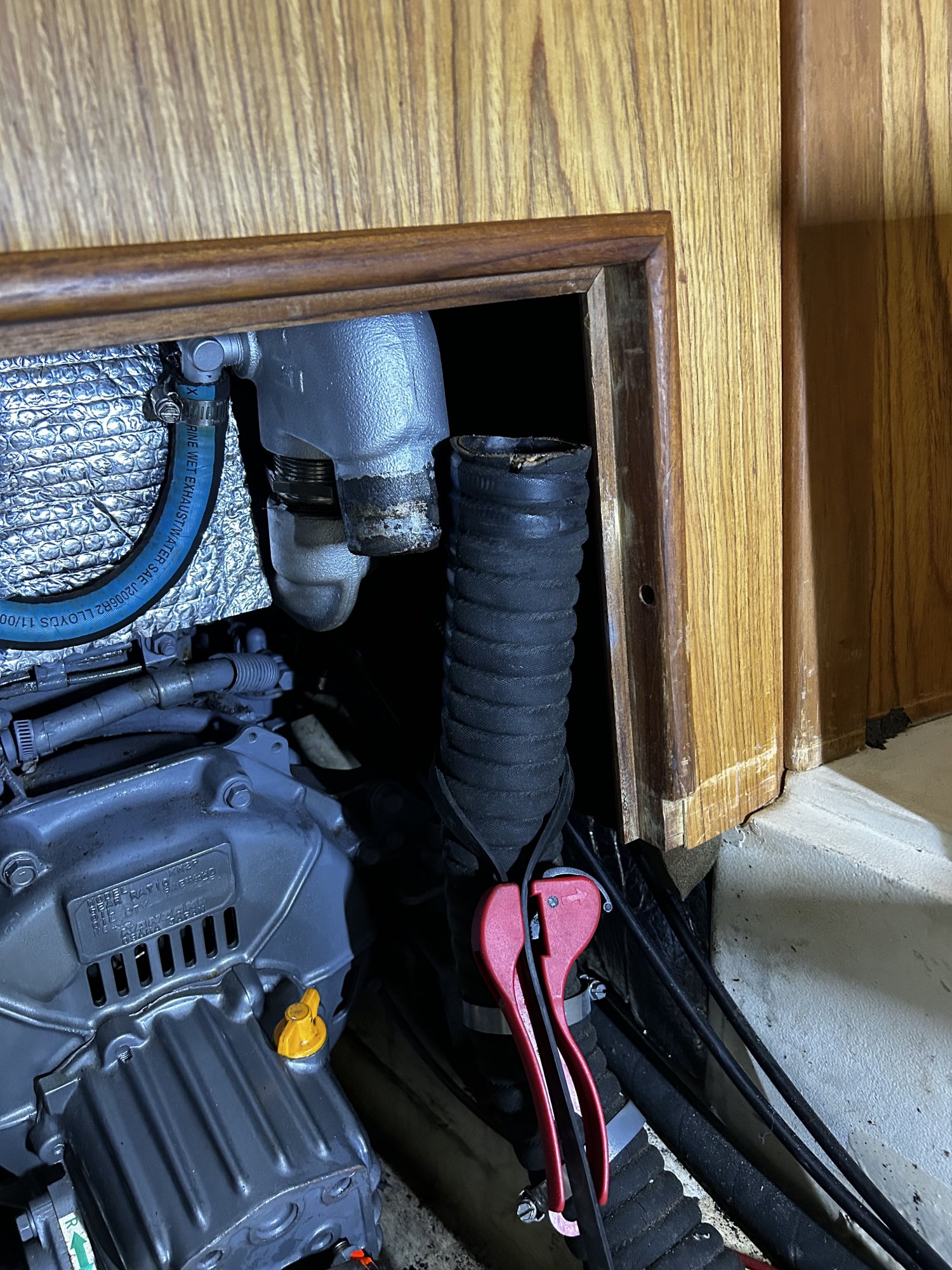

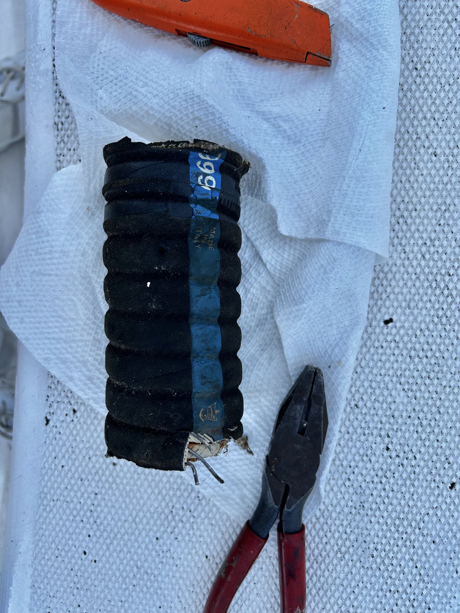

Good news to report…..This morning I removed the hose from the clamp securing it to the side wall and removed the clamps from the muffler. This gave me some play in the hose to be able to twist it a bit.
It only required a good pair of gripping gloves and the hose twisted off the muffler.
Same was true for the hull exhaust tube. A few good twists and the hose slid right up and off. No need for my hose picks at all.
I was going to remove the hose completely from the boat but as luck had it my razor knife only had 1 blade in it. They dull up real quick cutting through this hose.
I keep the spares inside the knife but NO not this time. So I was able to remove a section of the hose to match up to a new one.
Also I needed my wire snips to cleanly cut the wire inside the wall of the hose (when the new one goes on). Didn’t have a wire snips either.
My intention was to remove the hose today but that stopped dead in its tracks.
A rough estimate of length by running a tape measure up and through the hose measured almost 13 feet.
All in all so far not a bad job.

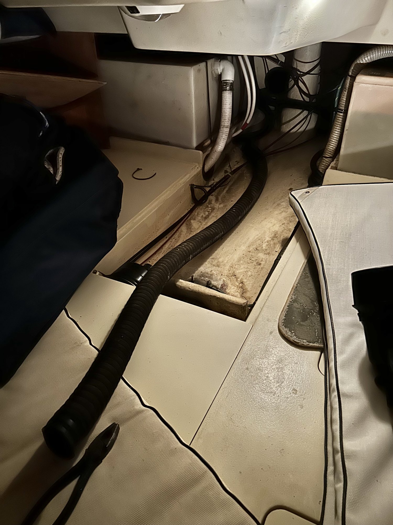

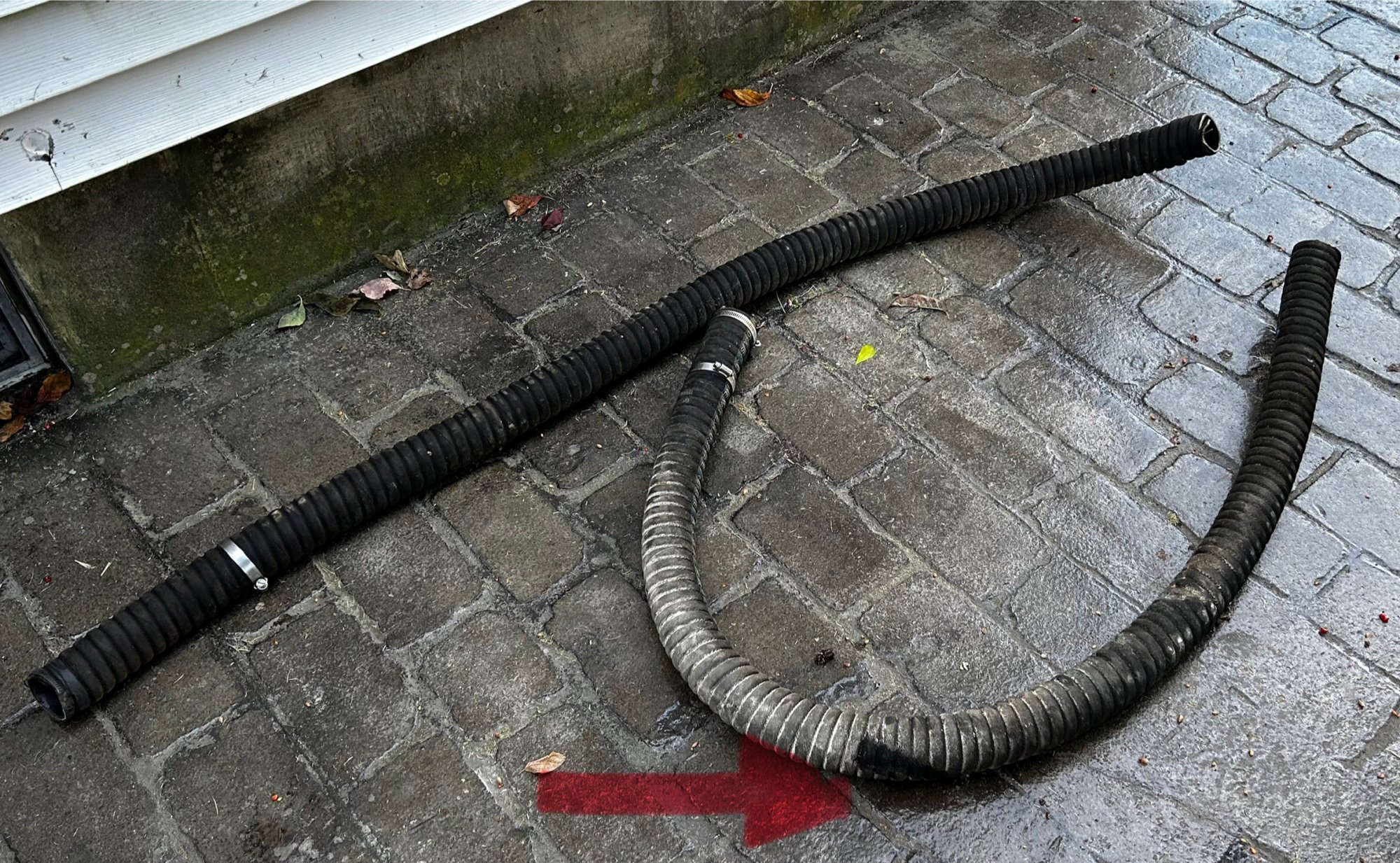

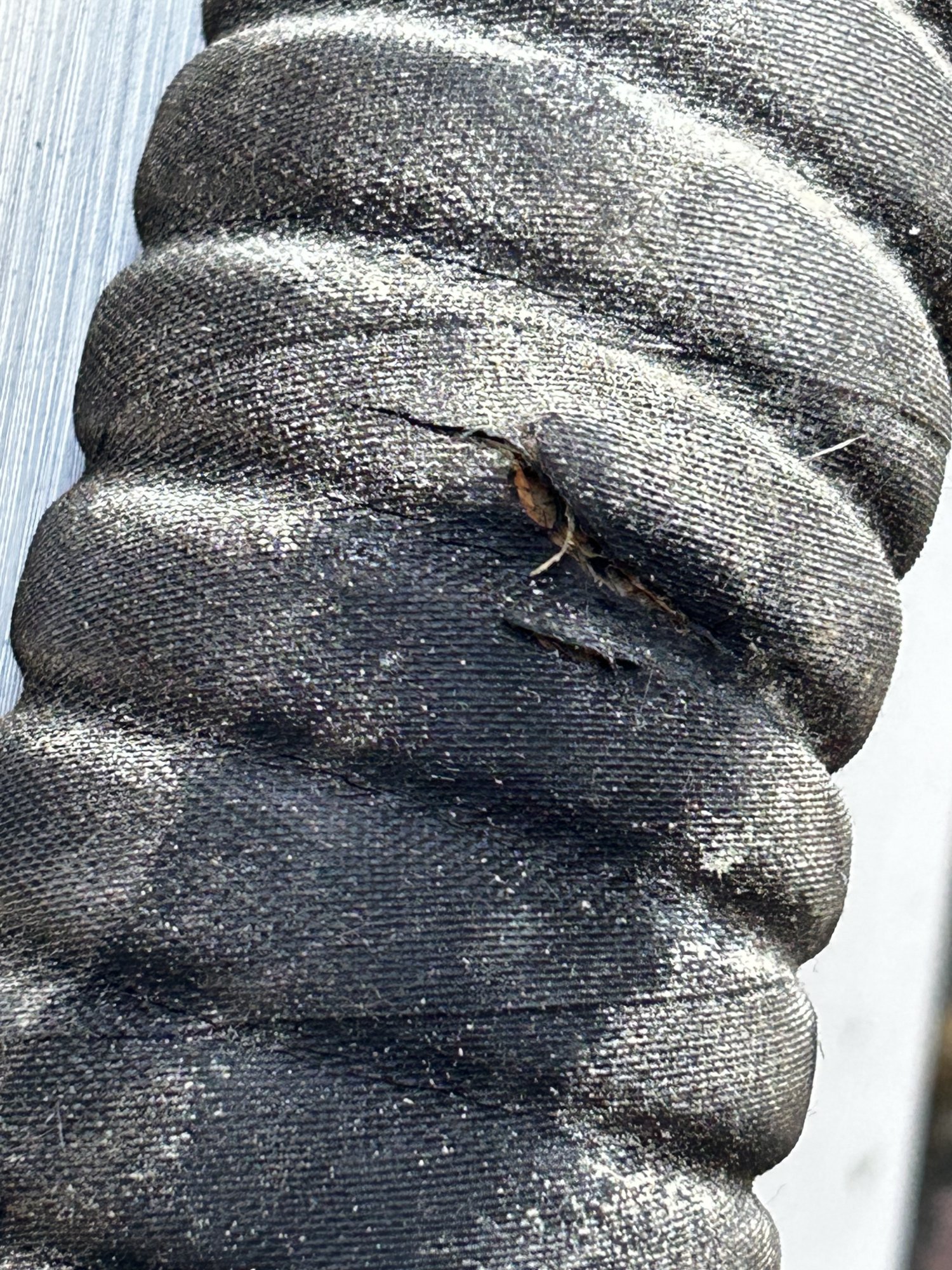

Removed the hose from the boat early this morning. It came out in 2 pieces. It was stiff but flexible enough to pull it out of the rear lazerette.
On closer examination you can see it is very cracked and brittle.
As I thought the leak was at the top of the loop and in the back out of sight, but not just a pin hole. The wire reinforcement made its way through in a slice.
Actual measurements is 12 feet.

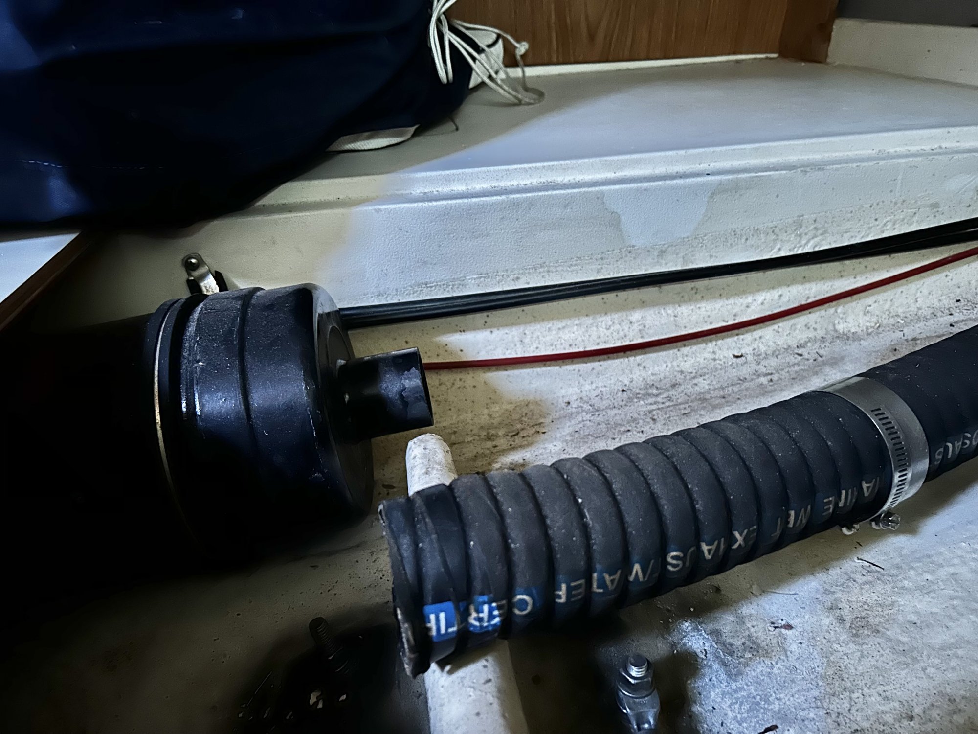

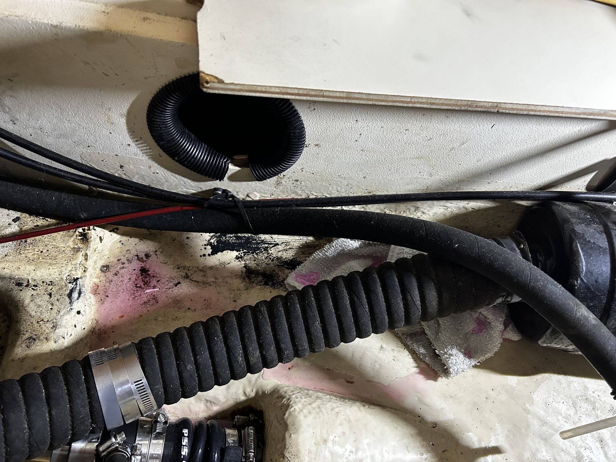

I took the section of hose from the mixing elbow to the muffler out this morning. The mixing elbow side required the use of a oil filter wrench for better leverage, but it came free easily. The muffler side only needs a slight twist and it slides right off.
My plan to cut a slice in the hose to try and minimize the antifreeze cleanup wasn’t needed. The natural bend in the hose held the antifreeze inside until I could pour it out into a bucket. A small amount does come out of the muffler but is easy enough to clean up.
All the hose is now off the boat. Now to go and get some new hose and clamps.

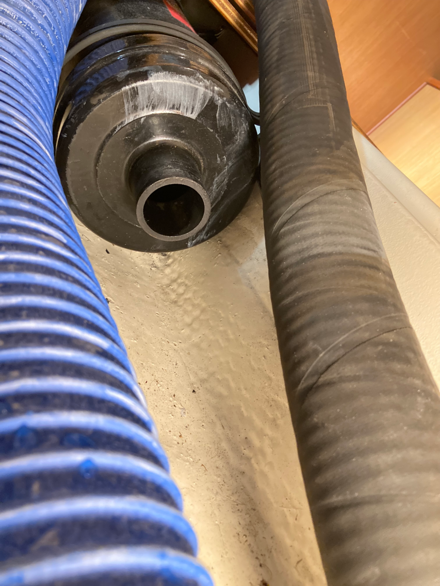

Follow up question regarding my wet exhaust hose replacement.
Since the hoses are off, I have turned the Muffler over to inspect the underside and found no rusting, corrosion or obvious signs of deterioration to the muffler itself.
Would I need to replace this as well as the hoses, since the entire system is apart? Have others replaced their Muffler when you did a hose replacement?
Form the look of yours :
It's about the same as mine :
Which is some form of bloody thick, resilient plastic :
I think the muffler will outlast the boat by many years as long as there's a good flow of sea water through it at all times (aka. cool).

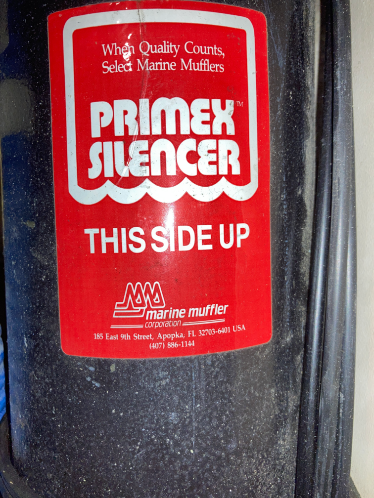

I did check here on the SBO site and couldn’t find a compatible muffler listed for my 27 HP Yanmar 3GM30F . So I sent out a message to them also…..Mike got back with the “current” muffler for this year and model boat if one is needed
“records show Primex Silencer that the H340 used an Marine Muffler MC-020-0001 fiberglass muffler that has 2" inlet and 2" outlet and Marine Muffler went out of business years ago. It sounds from your description that your is in good condition and probably does not need replacing. If you at some point need to replace that muffler I am sure that Centek would have one that compatible.”
