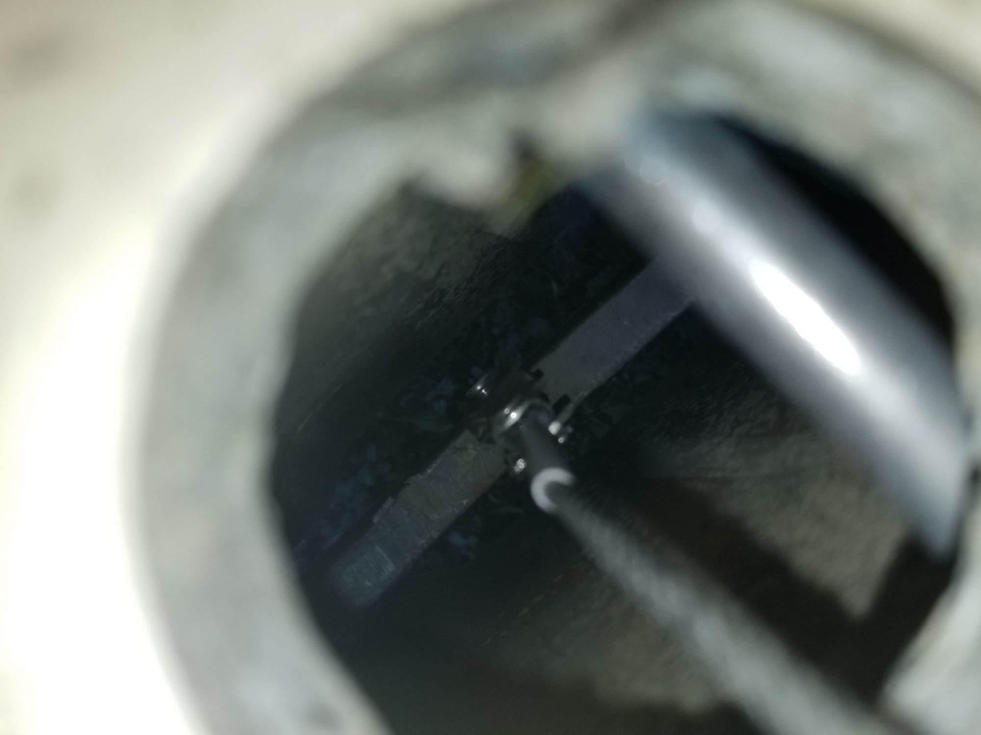

Findings41 pictures show the job very well. That is essentially how the Balboa keel is attached to the cable. You can order so SS plates from McMaster and drill the holes yourself.

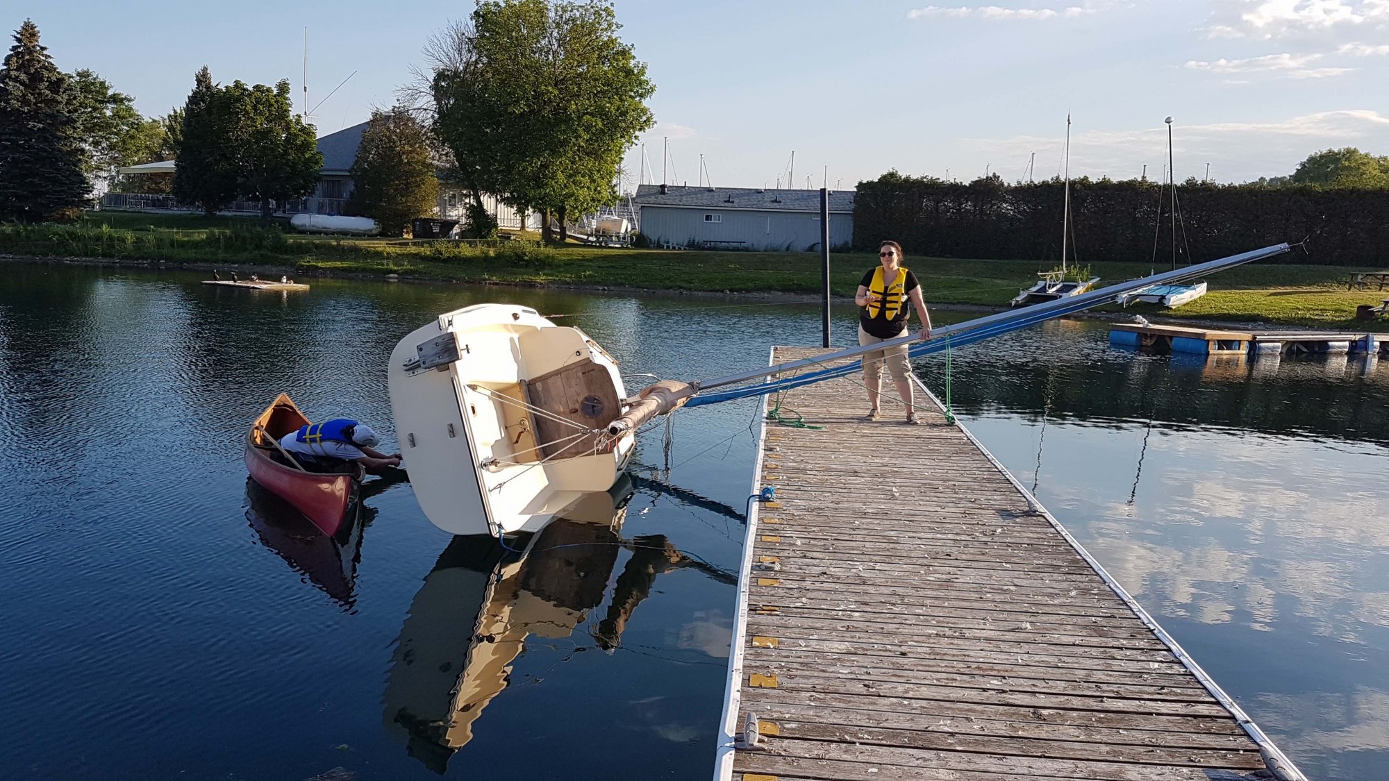

Hey finding41 - I just replaced my Siren17's keel wire as well (in the water!) I lead the cable the way it was previously, aft of the steel roller in the hole - now I'm second guessing that because the last owner (my grandpa) was notoriously careless about the way he did repairs. Does yours go fore or aft of the roller?

The cable goes aft of the roller (guide pin) like is shown in the photo. I also have a Siren 17, and it is rigged the same way.

Thanks! It was fun to tip it over though.

Great photo... I've thought about doing something similar to bottom paint in the water. You've given me some ideas.

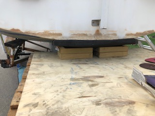

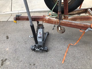

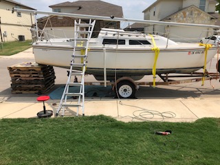

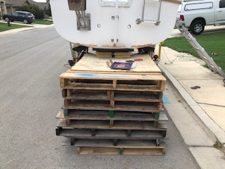

I haven't read the other replies but I saw this on another site and put my own spin on it. A guy made 2 stands out of 2x4's to support the stern bottom. He lowered the trailer to the lowest point and then placed the stands underneath and then jacked up the front of the trailer with a floor jack. I will raise the back end and drop your keel to expose the fitting and you can hook up your new cable. My spin.... I used a stack of pallets and padded the contact point with a 3" kneeling pad from Home Depot. Works great and it is easy.
