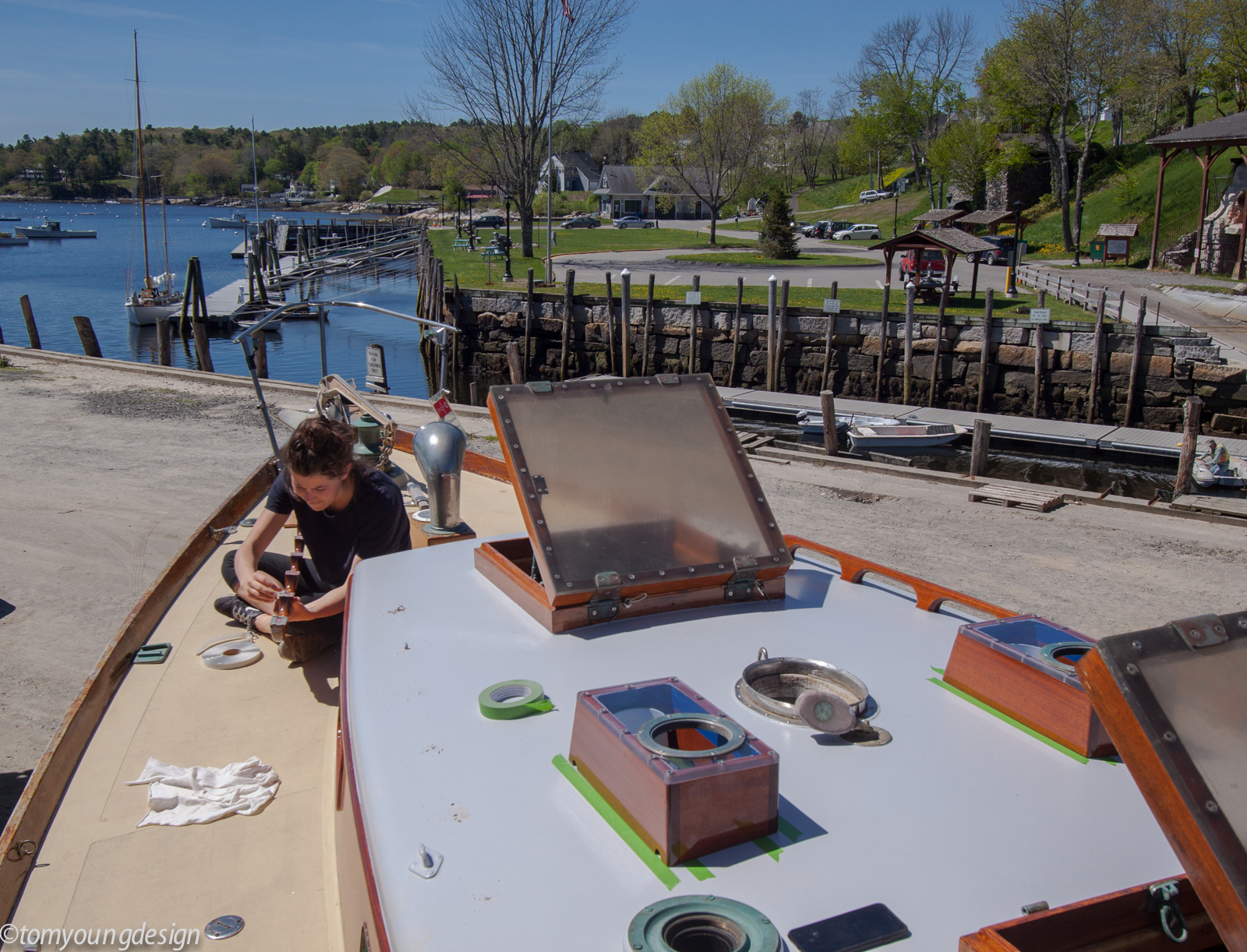

It's hard to tell what the OP is attempting, without photos. I used Butyl tape for the first time last spring re-bedding handrails and dorade ventilator boxes.
I liked it! But I knew these mating surfaces, close with little or no gap, were suitable. It did a great job of sealing the leak prone mating surfaces of typical handrails. The best plus was the lack of mess I'm used to with tube sealants.
I'll still be using tube sealants when it comes to bedding wood to fiberglass or wood to wood, when I need void filling properties. I can't tell if the piece(s) that the OP is trying to mount and seal, wouldn't benefit from a sealant that fills larger voids. Butyl tape is a great sealant, but it doesn't replace all sealants.
The only thing I haven't figured out with butyl tape is how clean up the squeeze out. I haven't done that yet. :) Any tips?
14,293
Take a small piece of butyl tape and roll it into a ball. Then roll the ball along the squeeze out, it should pick up the extra. You may have to use a not terribly sharp knife (a dinner knife) to help separate it, but probably not. Any residual can be cleaned up with a mild solvent, like paint thinner.
