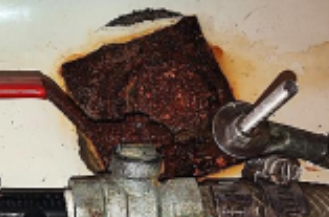

I'm the new owner of a 1991 Oceanis 370. One of the keelboats--an easily accessible one, with the lightning ground cable attached--is very rusty, while the others are all clean. I would like to replace it. Just wondering what would have caused this, and if this is an easy-ish DIY job?

With the corrosion that heavy and that uniform, my first guess would be that someone accidentally slipped in a plain carbon steel keel bolt during the initial boat construction. HOWEVER, having said that, the chance of also having the small reinforcing plate as accidental carbon steel as well really seems low on the probability scale. Got to wonder if somehow the lightning ground is involved when other bolts are in good health.
First thing to do, before you can even discuss this problem is to check it out with a magnet.
A bit of a bugger unless you're prepared to drop the keel.
I would suggest checking to see if there's water coming in from under the washer or just on top of the bolt from other sources within the boat. If nothing from underneath, you may want to consider installing a barrier to ensure the bolt stays dry. Permanently
No insult intended here but from your question, this problem is well above your pay grade. You likely excel in other areas however. You may want to bring in a pro (no dock rats here) for their opinion. Several questions to be looked into here i.e. does the loss of one bolt only compromise the keel along with several others questions.

No insult taken. That's why asked the question. :) I'm reasonably handy, but want to approach any keel repairs with caution. I had a survey done at time of purchase, and the surveyor's opinion was that this is not a significant immediate concern, but something I probably want to address in the near future. We just hauled out for winter storage, so now seems like a good time.

On second glance at your picture AND after the first of several coffees to get my head in gear, it looks like the SS post, nut, and washer for the lightning ground cable are happy enough and showing no corrosion, so that would seem to up the probability of the keel bolt being plain carbon steel. Your magnetic test will remove any guess work.

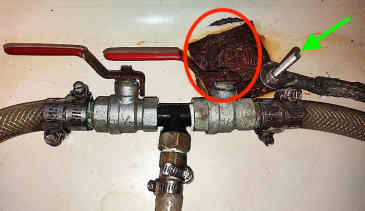

I have been looking at your image. I have several observations.
  1. The hoses and valves appear to be normal, but the metal handles on both have considerable rust. Do the valves operate smoothly? Are the rusted portions of the valve compromised?
  2. The area identified in the red circle, I believe, is the keel bolt, though, through the rust color, it is difficult to discern. Is it a coincidence that the rusted valve handle is directly above the area of rust? What caused the scratch in the gelcoat? Was something removed? Repaired? Is there a rusted metal plate being used to secure the keel bolt?
  3. The clean stainless steel bolt looks out of place. It appears too small to be a keel bolt for a 370 (37ft boat). Stainless would be a poor choice for a through bolt to transmit electricity to an anode or a lightning plate. Where does the wire go? To what other parts of the boat is the wire connected?

I agree that the purported keelbolt looks too small for a 37 foot boat. One would also expect to see more keelbolts in a picture from that distance. It is also odd that there are two clean valves in that location.
It could well be that there is electrical leakage from that black wire that caused the rust. It would be helpful to identify the square material that seems to be made of all rust.
24,942
Stu, from examining other Beneteau keel boat images, the square rust spot appears to be the keel bolt. It is sitting beneath the rusty handle stem of the valve.
The clean SS bolt appears to be an add-on attached to the metal plate. It seems to be providing a way to attach the bonding strap. Of Course, this is just my best guess based on examining several images of big boat Beneteau keel bolts and comparing them to the image above.

Lot of good observations here. Hopefully you'll figure this out soon. What we are seeing may be some modifications by the PO.
I have to ask what the valves and lines go to in your picture. The body of the valves look to be galvanized steel and the lines don't look like the lines one would use for sea water below the waterline. Being in the bilge, these are definitely below the waterline if they are seawater lines. I'd make sure that the seawater lines and all the fittings are rated for below the waterline.
I had the same thought. That doesn’t look like Beneteau factory hardware, and those fiber reinforced clear hoses are usually not rated for below waterline use.
