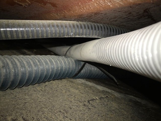

The real challenge lies under the shower floor. Hunter, in its infinite wisdom, zip tied together the sanitation hose and the sump hoses in an inaccessible position! You can pull all day to attempt to remove the hose but forget it! You must cut and remove the zip tie!
My approach was to cut an access hole at the point where the sanitation hose emerges from under the shower pan. This is accessed via the aft stateroom hatch closest to the engine.
After expanding the access hole, I inserted my iPhone camera and snapped a few photos to see exactly where the zip tie was located. Once located, I pulled the sanitation hose toward me and with a cutter in hand, felt around until I located the zip tie. Once located, I cut the zip tie and removed it. With that zip tie removed, the sanitation hose can now be removed.

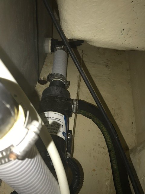

Next, I removed the sanitation hose from the macerator thru-hull. Use a pan to catch any discharge. Next, reach through the access in the aft cabin to access the clamps at the macerator pump. Remove those clamps. Remember to use a hair dryer if they are stuck on the fittings. My macerator hides came off the fittings pretty easy. Next, I pulled the macerator hose out the port transom locker and took it to the dumpster.
Next I ran a 4’ section of 1” Trident 101 hose through the port transom locker around the rudderpost and up to the macerator pump. I double clamped the hose to the macerator thru-hull and the macerator pump.

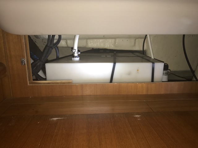

Next, I pushed the sanitation hose around the rudder post and up to the tank fitting. Measure and cut the sanitation hose to fit and double clamp to the tank fitting.
