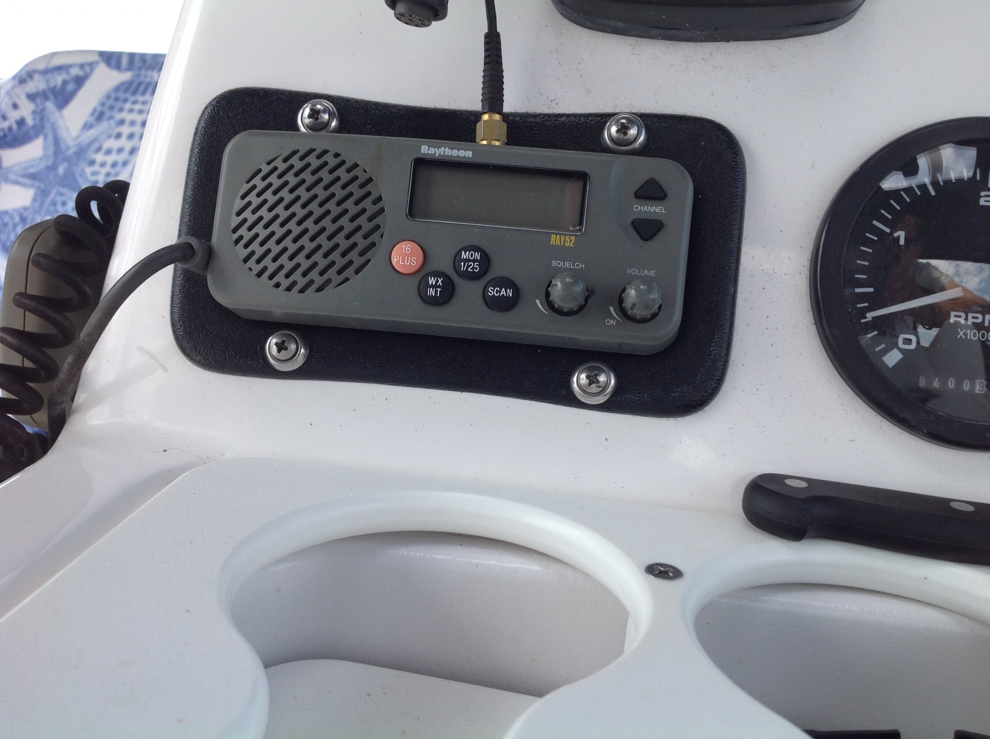

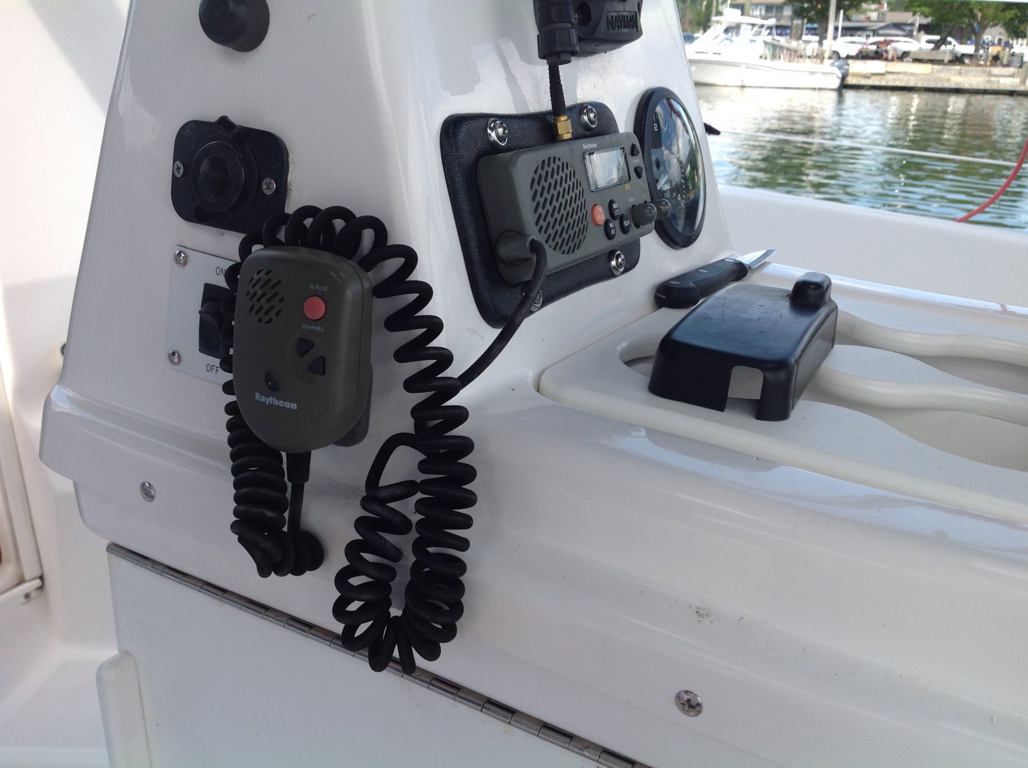

On my 2000 340, I have a Ray52 VHF radio. The cord has deteriorated and as it is hard wired to the unit it cannot be replaced.
What I would like to do is remove it and replace it with a Handheld Unit, outside in the cockpit area, that can be attached to the existing Power and Antenna cables and eliminate the Ray52 radio all together.

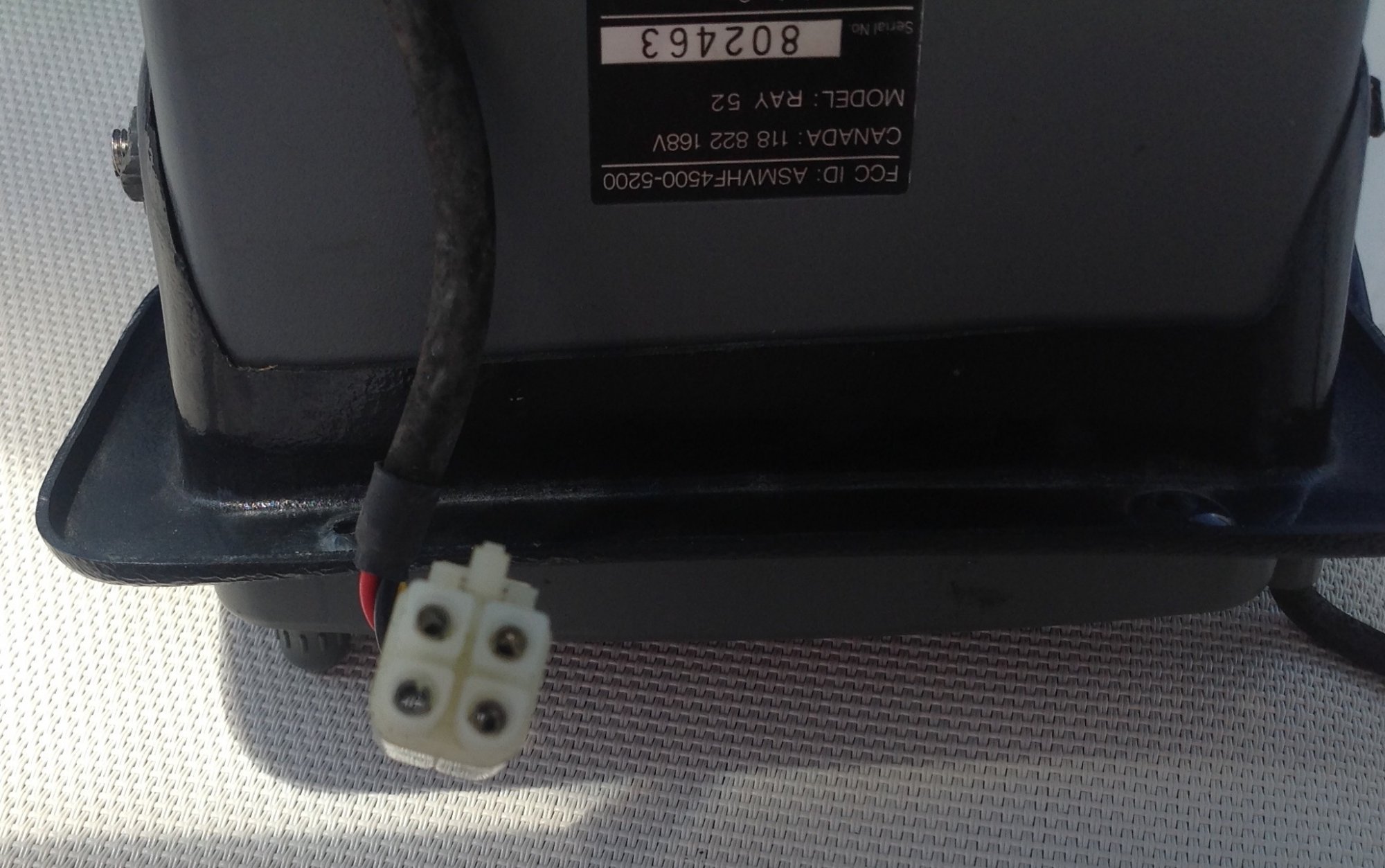

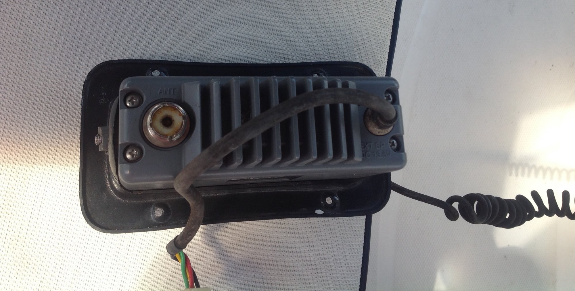

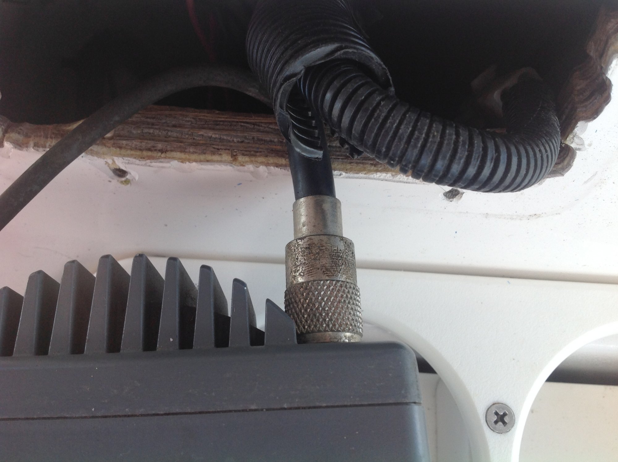

Heard back from Icom and Raymarine. Both say the VHF Antenna Connection is the same (PL259 End Fitting). But the electrical feed is another matter.....
"The good news is that the VHF antenna connection that plugs into your old Ray52 is called a PL259 and that is standard VHF antenna connection on the modern radios. The bad news is that nothing in the last 15-ish years has used the same powercord as the old Ray52 so your powercord would need to be replaced, but you could splice into your old run if that is still in working order. One change in all VHF radios due to changing DSC and SOLAS regulations is that all radios must be tied to a GPS to "drive" the DSC functions so our Ray 53, 63, and 73 radios all have built in GPS receivers so they are self sufficient so to speak and do not need to be tied to your chart plotter. The Ray53's mic is hardwired to the radio like your radio is, but the Ray63 and 73 have a detachable mic that can be plugged in a socket on the rear of the radio, if that is the level of separation that you desire. AS the main difference between the 63 and 73 is that the 73 also has an AIS receiver and a hailer built in, the 63 is closer feature wise to what you have."
So, for all those considering changing, only the power cord needs to be spliced into with a new end for the radio you choose.
Hope this information helps, it did for me.
PL259:
Original Powercord:
