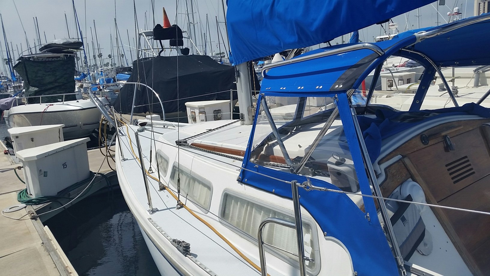

When I replaced my stanchions and lifelines last summer... I used Garhaurer Marine for the custom built stanchions... opting for the stronger welded base version. 4 regulars @ $70 2 gate braced @ $95. $470 total.
And after a lot of research I went with the hand swaged fittings from Downwind Marine online. These are the DIY type made by Johnson Marine..very good quality. This pelican hook gate latch, for instance, was only $47.81... including the threaded stud. the turnbuckle and stud run around $23... etc.
If you're looking for studs only, about $10.
I purchase the Johnson hand swage tool for $50, it's specifically made for this equipment.
I also purchased the uncoated, 3/16" 1x19 316 stainless wire from them @$1.10/ft ( NOT wire rope, NOT vinyl coated.) This is the same wire you would use for your standing rigging. It is no longer recommended to use vinyl coated wire for lifelines anymore... many race organizers specifically forbid it.
Here's the result:Impulse 7-17.jpg
