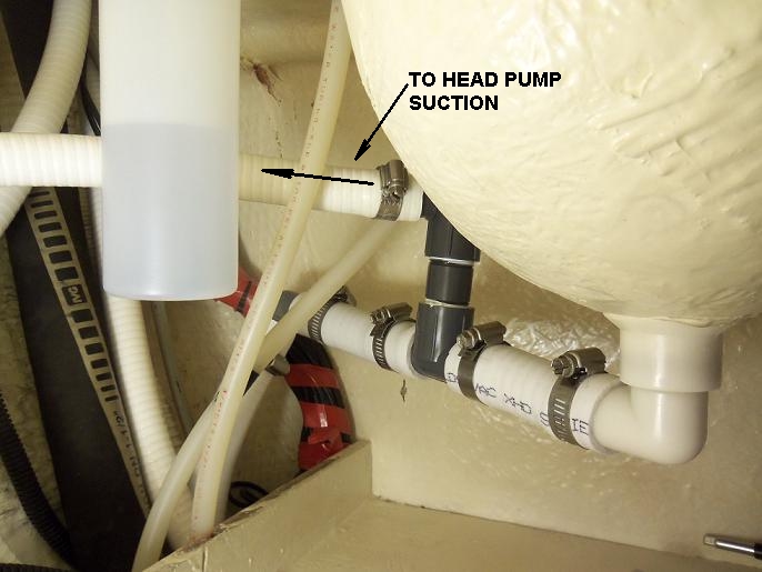

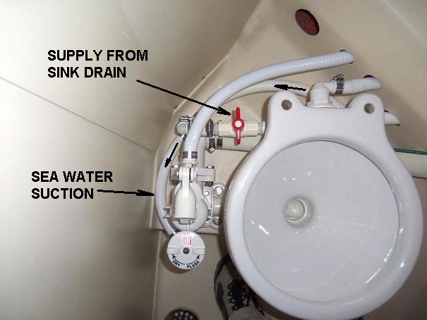

As far as fresh water to rinse out your hoses when leaving the boat for a period of time, I ran a line from the sink drain to the sea water suction hose (thanks to @Peggie Hall HeadMistress) to facilitate rinsing:
Close the sea water inlet thru hull and sink thru-hull (as you always do) and you're ready to rinse.
