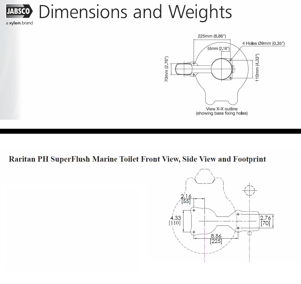

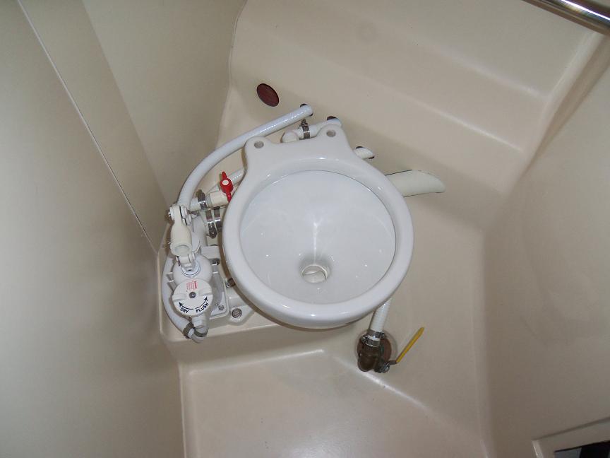

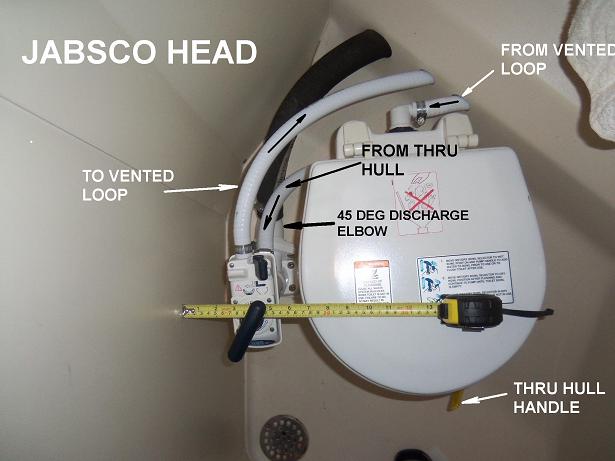

Just replaced the same toilet (1999 Jabsco) with a Raritan PH Superflush manual flush on my 1999 H-310.
I don't know where all of this myth-information comes from, but comparing the base bolt hole locations on the 1999 Jabsco to the 2020 Raritan, it was a perfect match:
Armed with these two drawings and not a bunch of ill informed opinions, the new Raritan was installed:
The only thing which presented a problem was the 1-1/2" discharge hose which had previously leaked at the attachment flange of the Jabsco. This was as good an opportunity as any to change the tight location of the hose as it penetrated the wall behind the head. This unused hole was covered with a SS polished disk to hide the offending culprit.
