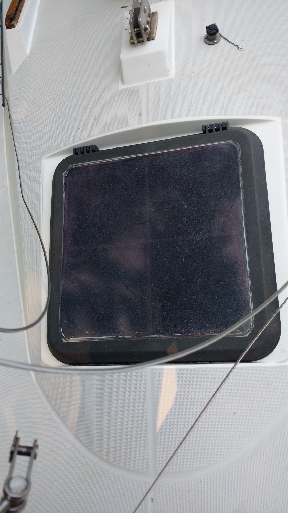

My forward hatch on my 1988 O’Day 192 is leaking a bit. After watching it closely I figured out that it was the adhesive between the clear lexan panel and the hatch itself that failed. For now I sealed the inside edge with butyl tape until it’s good enough weather to actually reseal it but now it got me thinking. The panel is cracked and crazed a ton and instead of just resealing it back in place maybe I can replace it.
Has anyone replaced just the Lexan? I’m thinking 1/8” smoked lexan is all I need and I can have a local machine shop cut it to size for me. On my hatch the lexan is only held in place with an adhesive so it would be easy to remove and replace (I think).
