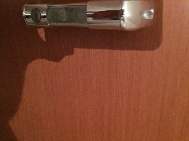

Replacing Halogen bulb in fixture

I tried that change also, but on the Beneteau parts site you can buy new LED fixtures that will probably fit the same mounting holes. Mine did.
Only want to replace the bulb not whole fixture

That's a little different from my 331's swiveling fixtures of that type, but *as I remember it*, the "panel" to the left--the side without the switch--unclips and gives you access. I replaced all of the bulbs on those little fixtures with LED replacements from marinebeam.com a couple of years ago, so you'd think I would know for sure but...

Thanks all took it off the bulkhead and end came off to provide access
