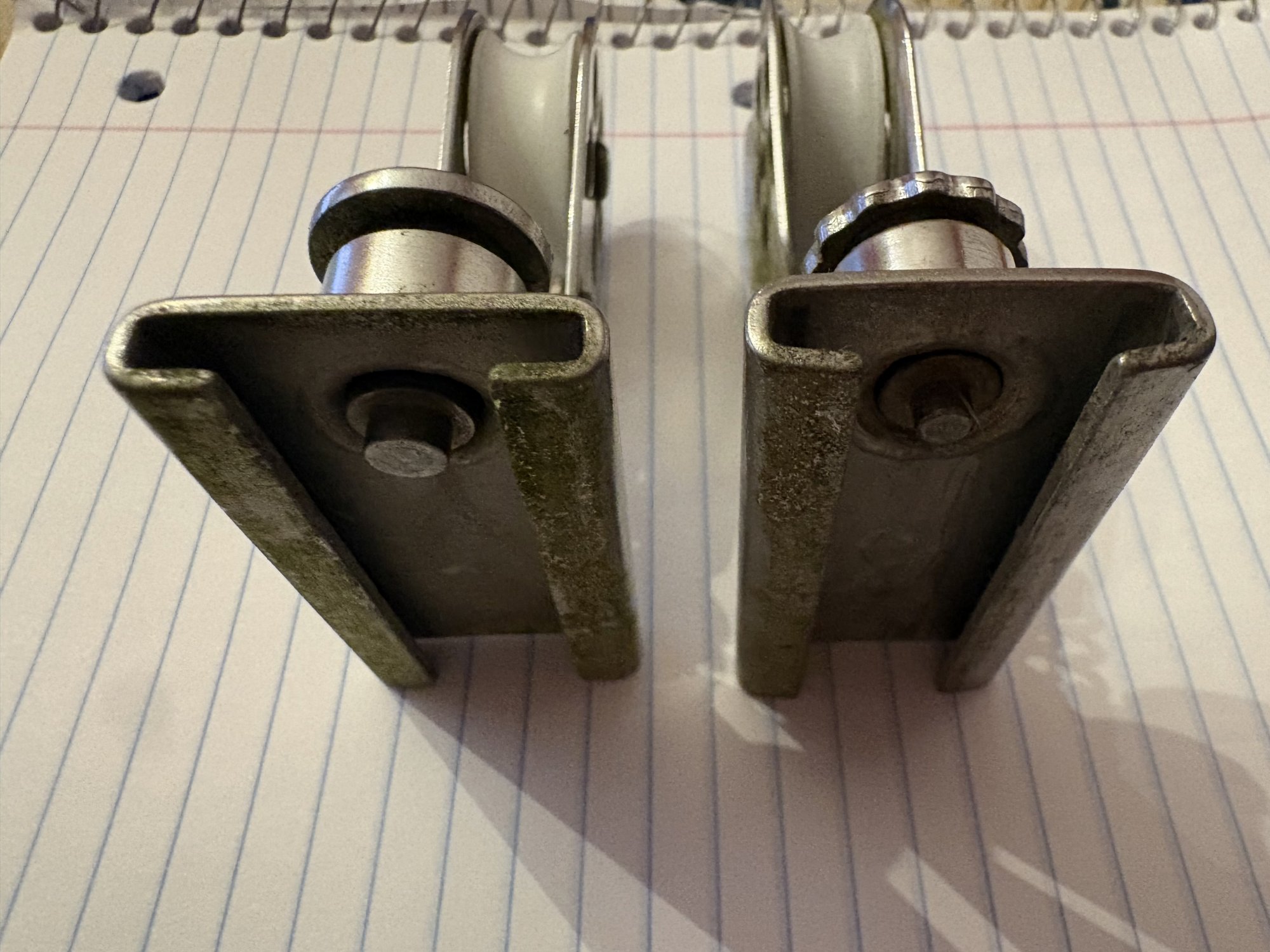

Thanks to everyone who wrote back. I managed to get the cars off both sides tonight, and I think I can see the problem. The car on the left is perfectly well behaved, no slipping, no rattling. The other one the right is sloppy and the narrow pin has ripped through the holes in the tracks. Now I need to find another of the left ones.... anyone?

It appears that they are two different types. The one on the left is spring loaded, the one on the right is a screw type. Most likely the screw type has resulted in the fatigue to the pin. ITWMB, I'd just buy a new spring type and throw away the screw type.
You can find car with white sheaves like that with Ronstan or Shaeffer, but Garhauer makes much less expensive but just as good if not better quality gear, although it looks different.
BONUS Request: your end tracks removal - screws or bolts????

Just buy a new slider from garhauer. 1" Track car slide $38.96 (a very fair price, btw)
If it's not the right size for your boat do a little searching. btw. don't freak out when you see the prices of some of your search results. Be patient and keep looking.

Just to wrap this up for anyone needing the same information in the future. Of the two end stops I tried, one screwed into a metal insert that was epoxied into the deck. I think this was original. The other bolt was just sitting in a hole with no metal tube and so no thread. Water had been ingressing through it and the aftermarket bolt was rusted through. I with stuff it with butyl tape and a new bolt, but it doesnt seem to need a thread to stay put.
I managed to get a great deal from the nice, helpful people at Shaefer so now I have matching cars. Thanks again to everyone who helped.
