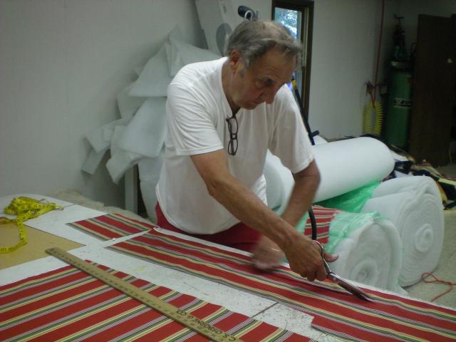

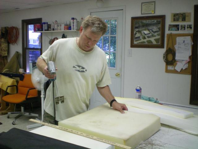

Kestle......thanks....no, but my father-in-law does........I hay elped....:dance: I can nearly lose fingers using my table saw, but the thought of driving a sewing needle through them gives me the willies:eek:.Momma picked out the fabric (sunbrella), and I did what I was told. Bro-in-law has upholstery supply business for the foam. Bob does fine work. That is the dacron in the background.

Those really look nice :dance:,
