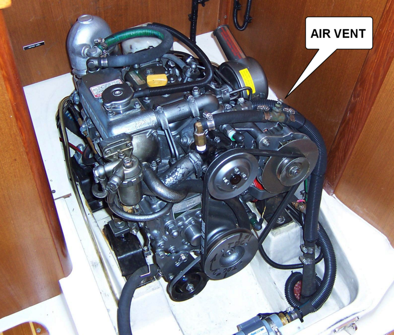

The first time I changed the AF in the cooling system of the Yanmar 2GM20F I dutifuly drained every drop out of every hose to and from the HEX. After that little exercise of filling everything with air, I had my doubts the engine would ever run more than a few minutes again. I had a temp. gauge on the system and all it ever did was overheat while I tried to purge all of the air while idling at the dock. I also had an air vent at the highest point in the system at the engine. No luck.
Eventually, I did get all of the air out but was almost purged from the marina for language unbecoming a member. ^$%#*&%!@ :cuss:.
Figured I'd never do that again in this lifetime. So ......................... seeing as how the engine was now running smoothly again temperaturewise, I would never disturb the lines to and from the HEX again.
Renewing the AF became a breeze after that. I drained the engine capacity of 3 liters of AF and did not disturb the hoses to/from the HEX. Refilling was a breeze and I purged what little air there was in the block through the air vent at the top of the engine. After that, any bubbles remaining would be so small as to be swept away into the top of the reservoir and from there into the AF overflow.
