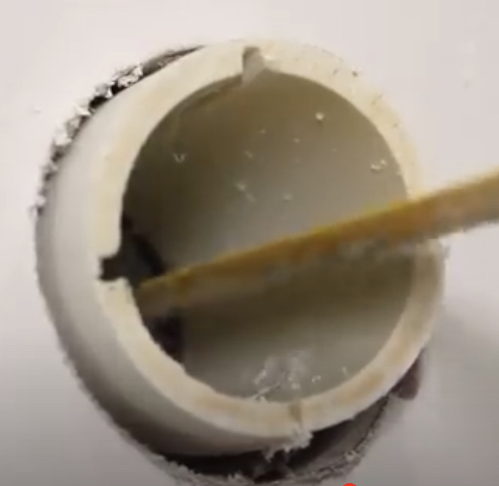

if you can’t leave in place and reuse with the new latch you might try something like a plumbers internal pipe wrench which would allow you to slowly twist it out or a make fine cuts along the barrel through he door with a hack saw blade to allow the diameter of the trim in the wood to be reduced and hopefully eliminating the tear out.
Cut trim similar to this:
