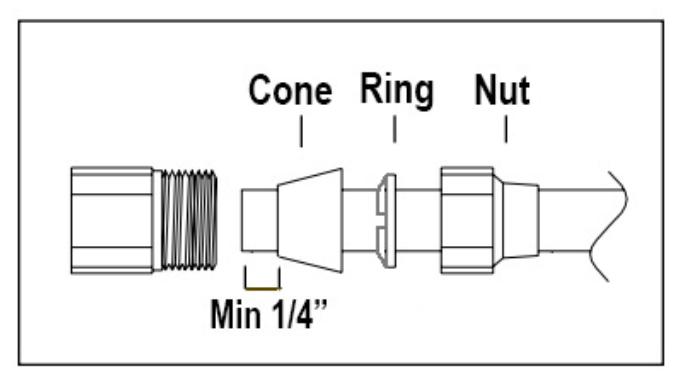

Hunter installed Zurn Qest fittings for the fittings of my water system in my 1999 H-310, however the tubing was all pex. The Qest fittings are the epitome of design but I see they also have a Zurn price tag ($$$$$$$). They are the ultimate to work with for ease of installation. I did some early renos on my water system and found that using press fittings allowed me to use most of the original tubing again. If the original install had been Pex bands it would have meant scrapping much of the original tubing.
Zurn push fitting
@john6206 , please send us a few pics of the fittings used on your boat's water tubing.
