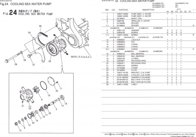

Don't know of anyone who could have made the conversion but you may try looking at the water pump used by the Yanmar 2gm20F to see if it could be adapted. You will likely have to fabricate a new mounting plate. The benefits from using the Yanmar pump would be the good accessibility of getting replacement and maintenance parts for it.

Thanks for the heads up you guys. I'll check out Depco and consider the Yanmar 2 GM.
It'll be a while before I can follow up on this, but will post the results of my quest here.
