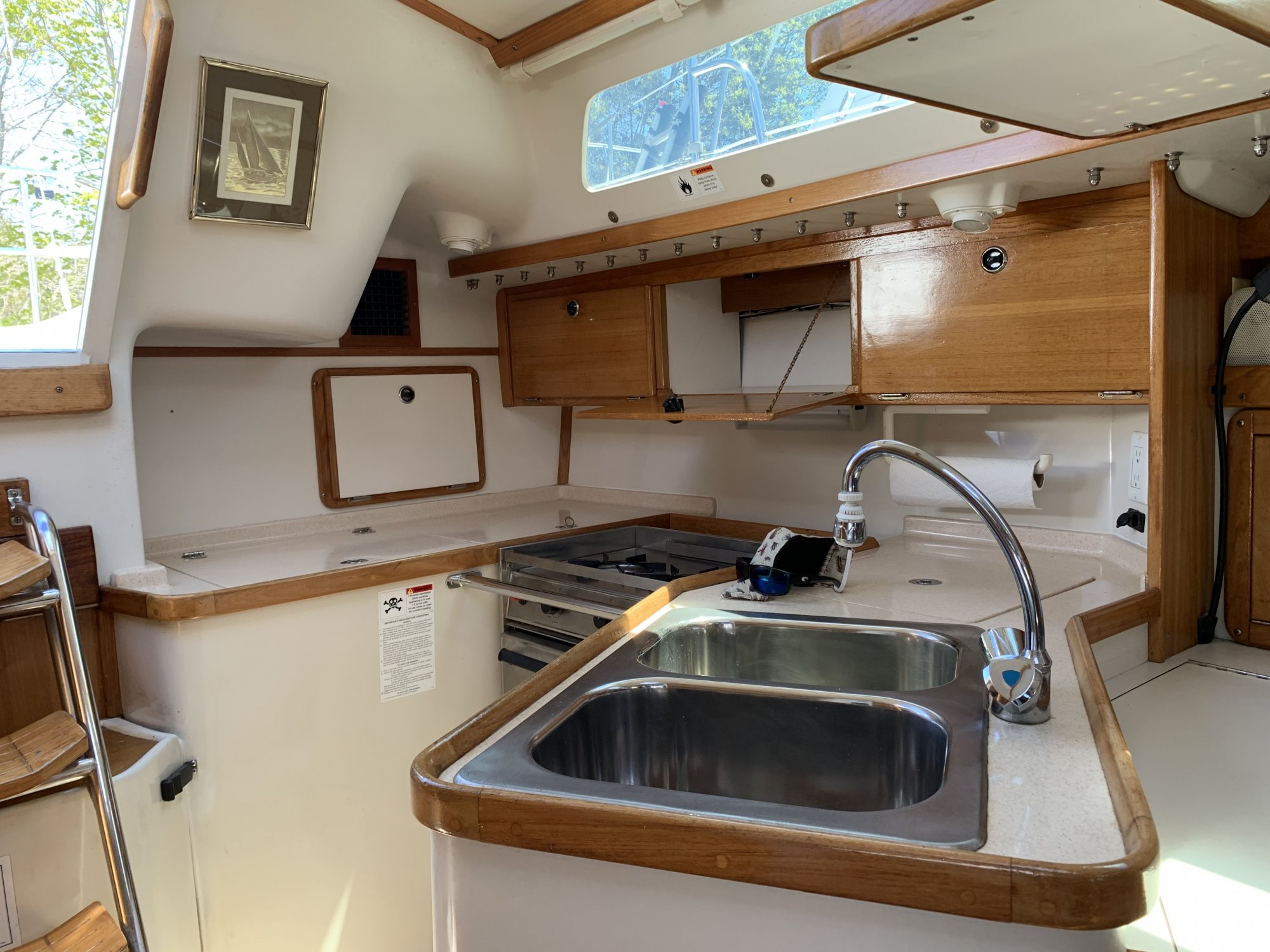

I hate my galley sink. The double basin is useless
and it's getting pretty ugly anyway. I'm thinking about this for replacement. It's less than half the price of the Catalina Direct replacement, I like the black color and I'm pretty sure it will fit with minor adjustments. It weighs 25 pounds tho. Any thoughts?

I like the double on my PDQ. Fitted with a tiny drainer for silverware and used for rinsing and drying, it was very convenient in the absence of a dishwasher. I grew up with a double sink and no dishwasher, so the rhythm is familiar. I'm thinking people have forgotten how double sinks work. Think of it as a drying rack that stuff can't fall out of.
The nice thing about stainless is that you won't break things when you drop them. I wouldn't want a hard sink on a boat. Yes, SS gets some dings, but I always figured a sink was like the sole of a shoe; it's going to get some wear, no problem. Did I mention I dislike hard sinks that can chip stuff?
10,133
Love my old original double on the H-34. Works when heeled on either tack. I have seawater plumbed to the little outlet at center. IMG_0101.JPG
