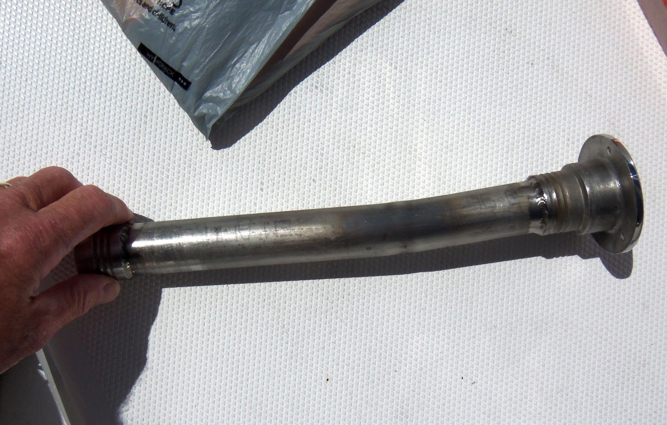

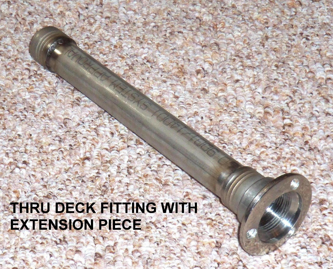

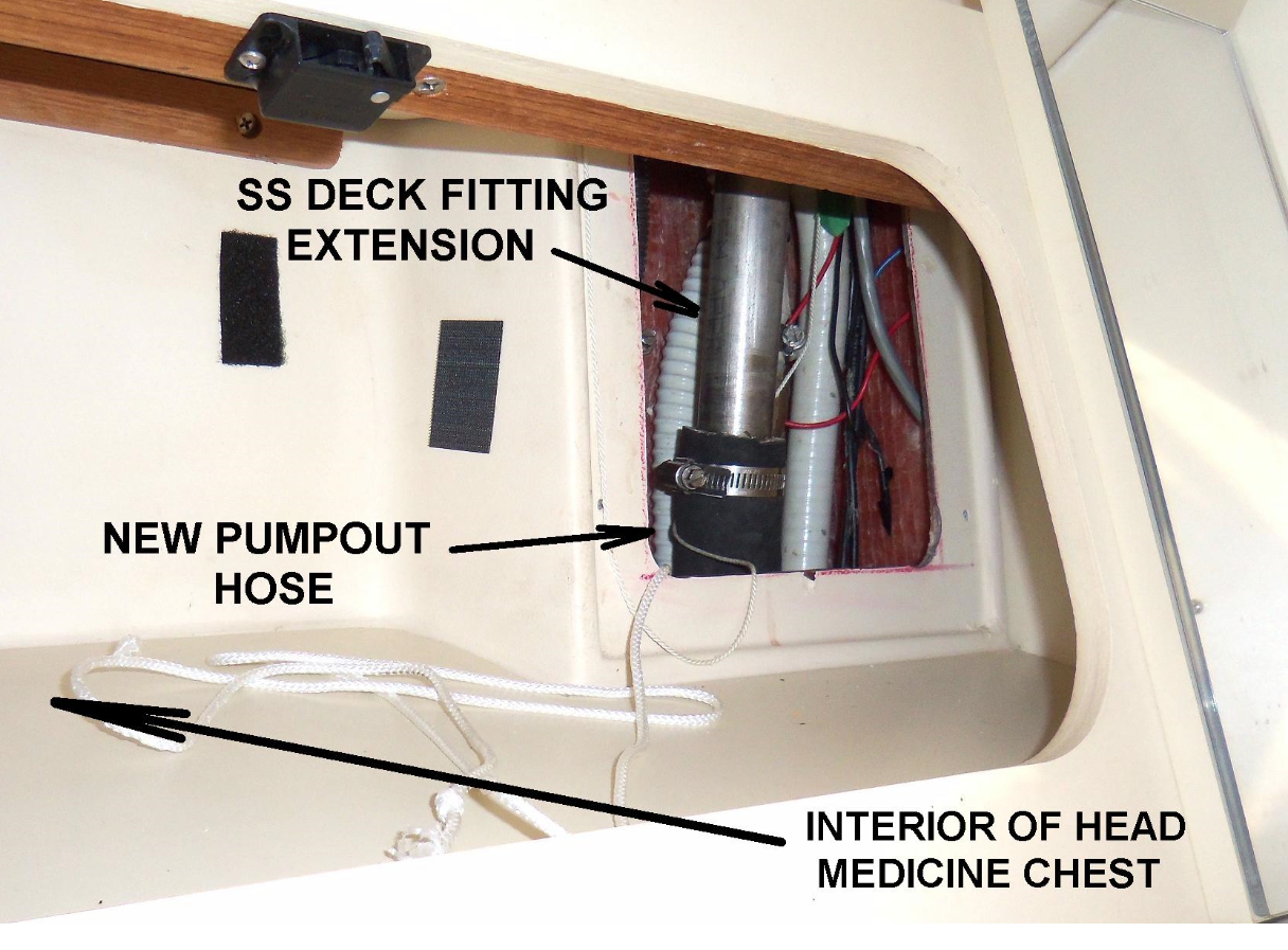

Not following your tribulations in dealing with the deck pump out fittings but here's my fabricated life saver for re-installing the pump out fitting and hose in an impossible location :
That was the most difficult part of the whole hose replacement job.

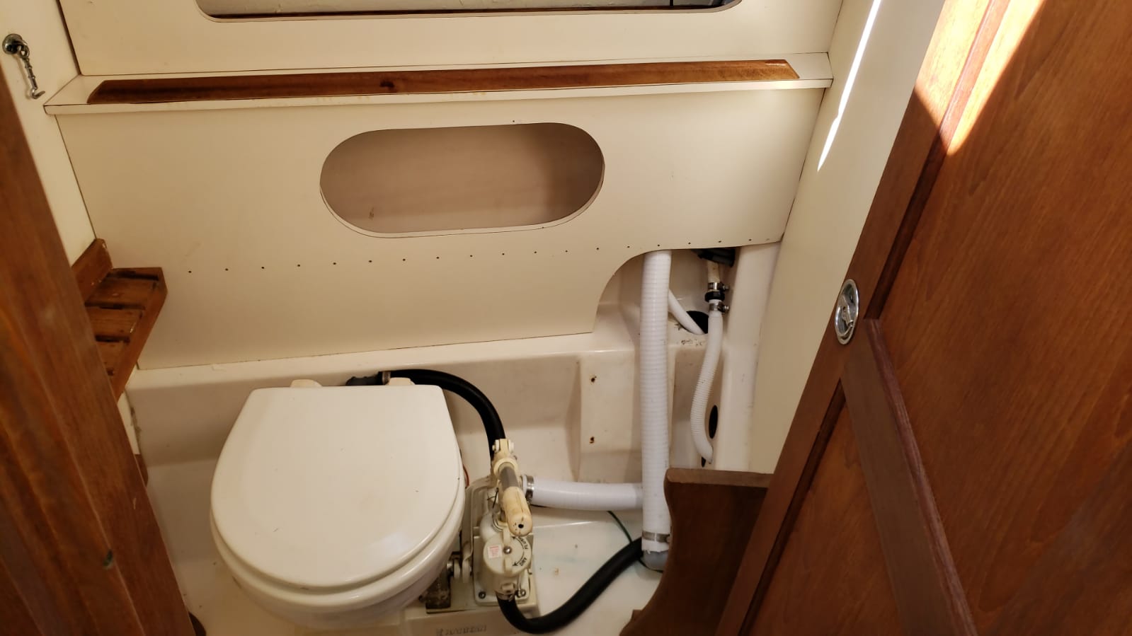

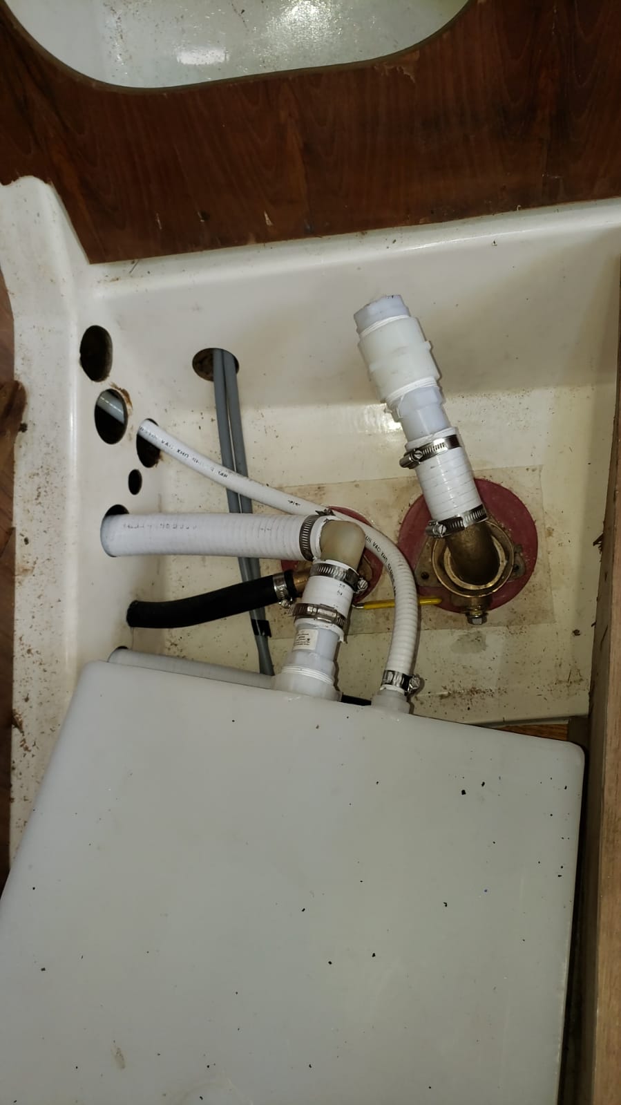

I broke the handle on the inlet valve for my head, so I decided it was time to replace all hoses and the tank which had its own problem. My only mistake was that since I hauled the boat to replace the inlet valve, I also had them replace the outlet - mistake! I only sail on the Chesapeake Bay and must use a pump out station, no over boarding waste. So my shinny new $500 (?) outlet valve got plugged off and will probably never be used. It also cleaned up my bathroom area since I removed the manual overboard pump.

Mike,
I’m looking at the install, and I have a concern.
You really should consider double hose clamp on these lines: especially the through hull ones. There is a lot written up on this.
Best of luck

Mike,
Best of luck
THANKS SO MUCH!!! WILL DO IMMEDIATELY.

Mike, I’m looking at the install, and I have a concern.
Best of luck
All sanitation hoses and any hose that connect to a below-waterline thru-hull should be double clamped. The screws should be 180 degrees apart--or at least 90 degrees apart if access makes 180 impossible orso impractical that it might as well be (if you put them on the same side the hose can pucker, which kinda defeats the purpose of using two).
