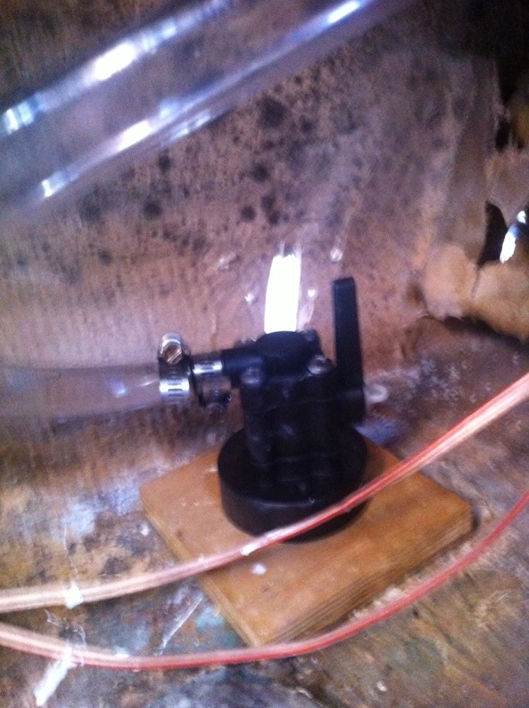

I replaced the valve under my sink last winter. Had the factory glassed in pipe as a thru hull. I drilled it out and replaced the entire thing with a Type 93 from Forespar. $64 and a tube of sealant as well as some resin coated plywood backing. Under $100 plus labor.
