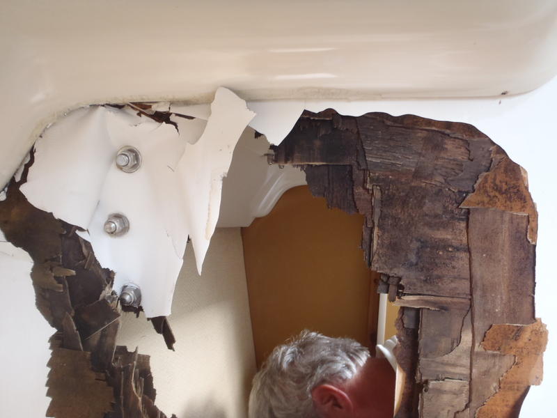

Hey all,
i have a 25' Oday and the plywood bulkhead which the shrouds are attached to has rotted out and the attachment plate pulled away from the plywood ( what was left of it anyway ). I've cut out the entire piece of plywood, since 60% of it was wet and ruined. I still have the portion of it which is next to the hull which is fiberglassed to the hull left to figure out. Anyway, to my question, any ever replace this plywood or similar structural pieces with marine grade polymer plywood? I've searched online and found a couple of manufacturers and it's not clear what the structural specs are for the polymer boards. i.e. are they similar in specs to plywood for a given thickness... The plywood used on my boat is 1/2". I plan to call the 800 number to ask this, but figured i'd throw it out there.
pic of the "through" hole attached.
btw, the cause of the wet plywood, i believe was water leakage from the deck plate following the plate down into the cabin where the plywood is. I'm guessing this happened over several years and since the plywood was poly-ed and painted over time, it didn't get noticed.
Don

Chances are you also have rot in the deck core around the chainplate. Make sure you fix that while your at it. Can't help with specs on the lumber

how you going to fasten it to the hull i don't think you can glass it in with that material it wont bond to the plastic on less it is frp......i would go back with more ply wood and stop the source of the leak..it may be strong enough but i don't think it will bond to the hull with fiberglass cloth and resin the poly material that is

Thanks to both of you... man! this hole keeps gettin' bigger and bigger!! :)
i'll call the manufacturer about whether i can fiberglass it to the hull. although you're probably right...

Why not just use marine plywood? Your boat is probably over 30 years old so the plywood will last a long time. Use butyl tape from Maine Sail to seal the chain plates. I doubt you will ever fix it again. Try using an oscillating tool with a wood and metal cutting blade. It will go through the fiberglass and plywood like butter. Then the same tool with an abrasive blade will prepare the hull for the new bulkhead attachment. Good luck with the fix.

Marine ply, epoxied (not polyester resin), sistered to sound existing bulkhead, or better, a complete bulkhead replacement. This is an important structural element of your boat.

You need a composite board with high tensile and compression strength plus high modulus. Starbright or other plastics are not adequate with 10% of the modulus of marine plywood. IMHO you need a composite. Search for G10 epoxy-glass laminates. You will need to cut or grind out the old lamination from plywood to hull and then epoxy glass tab the new G10 bulkhead or chainplate knees. Here is how I did it on my boat, an Irwin 31 Citation. It is not cheap or easy, but it is bullet proof (literally). By the way, I replaced the floor stringers with 1" thick G10 and the plywood floor in my shallow bilge with 1/4" pultruded vinyl-glass composite too so I never have to worry about bilge rot.
Exactly what I did on my 23. I didn't have nearly this kind of rot and was lucky to have only a few inches diameter of core rotted around the chain plate area. I used okoume marine grade plywood and sealed the edges with CPES. Maine Sail's butyl tape is working extremely well, no leaks after four years.
One big difference is that the bulkheads are not tabbed in on a 23. Most examples I've read in the inter webs have just cut the bulkheads out flush with the hull and then tabbed new ones back in.
