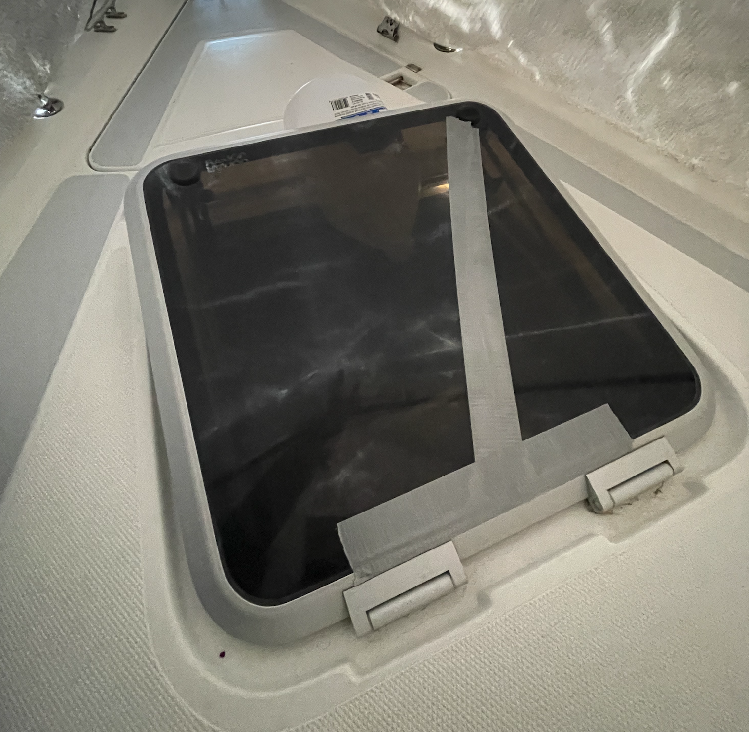

I have a 1994 Hunter 29.5 and the acrylic on the bow deck hatch cracked. Can I have someone just replace the acrylic, or do I need to buy a whole new hatch? Looks like it is a BOMAR 1039. About 20" opening.

The acrylic can be replaced. Contact Bomar they may have on precut and drilled. Or you can go to a local plastic supplier and have them cut or TAP Plastics.
Check the Hunter store here at SBO, they may stock the new lens.

Try and get the old piece of acylic out without breaking it into smaller pieces. Bring it to a local plastic (acrylic) fabricator. Probably can get a new piece cut to the exact same shape for under $100. Pretty easy to install in an afternoon. 1/4" thick bronze acrylic runs about $15 a sq./ft for material.
10,255
I replaced mine 8 years ago. I used TAP Plastics ; they cut the replacements perfectly and the price was good.. That order was for two small Bowmars and a small flat cover on a deck cubby.. Measure precisely or as Bad Orca says, carefully remove the old lens and take it to a local shop .. I used Dow 795 to rebed the new lenses.
