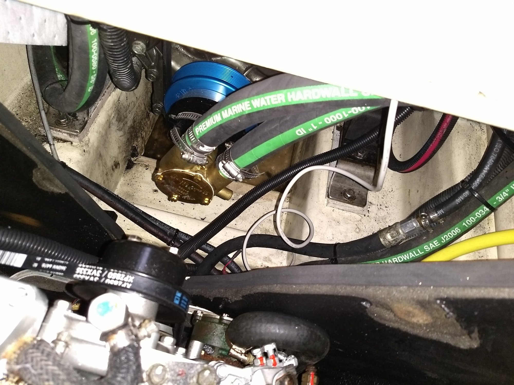

Before I modified my water pump as per Art Boas, it ONLY took me 2 hours to change the impeller. That was at the dock with the A/C blasting to help keep the sweat running into my eyes. I now expect it to take 10 minutes or less. See photo below, what a difference!
I use Long Reach Hose Grip Pliers, 37909 from Harbor Freight, $14.99 to pull impeller. Works well.
