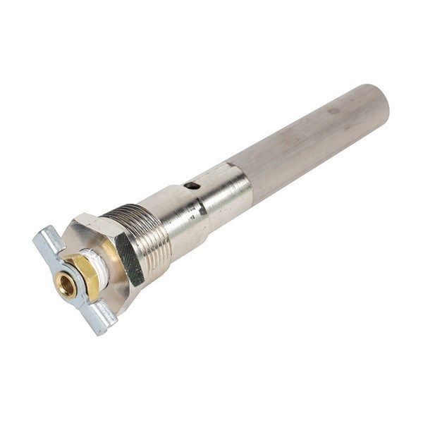

Camco Water Heater Anode Rod with Drain
These Camco Water Heater Anode Rods extend the life of your water heater and protect it from corrosion. This assembly features the replaceable magnesium anode, a brass plug, 3/4" NPT threads and a pit cock style drain. The NPT thread is what is important. If you get one let me know how it fits. I'm trying to find a source here in Canada (Toronto)

Just read your info. Was there something you where pointing out. My Tank didn't come with a Anode so I wanted to put one in. The Drain type made a lot of sense. The drain plug part is brass which I think would be OK. (I think). The info I got about the Interior is this ....

Are you sure you want BRASS on a boat? Bronze, yes...but brass for just about anything but a bell is usually considered a no-no 'cuz it corrodes...bronze doesn't. If the brass comes in contact with the aluminum, that could be a problem too.
So methinks you need to have a chat with the water heater mfr before buying the anode with drain.

I talked to a rep from Camco and he said that the only brass piece in the anode is the actual value itself which has no connection to the body of the tank in or out. He pointed out that if you look at the photo you can see the set up of the Anode Construction.
