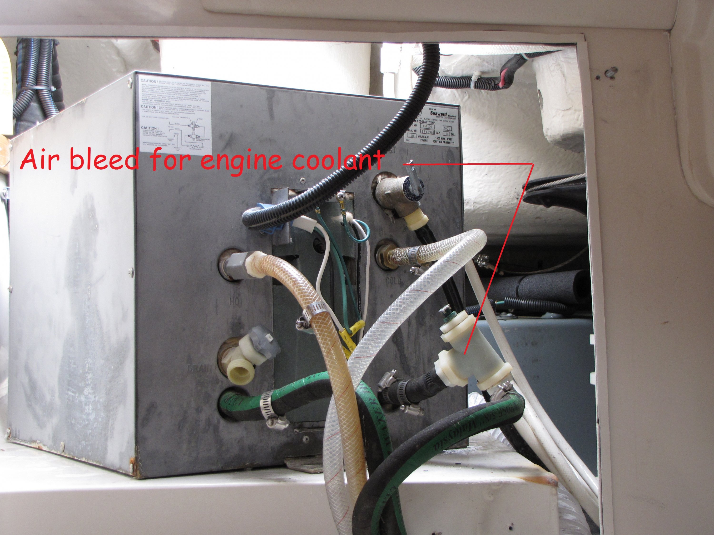

Paulj, what is that white plastic valve connected to the engine hose by the hot water heater? Is that a shut off valve? I am also replacing my water heater and would like to replace that valve. Is that a home depot item or Catalina item?
Thanks, Russ

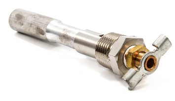

Hi guys. I was told that there is a Drain/Anoid Value for the Hot Water Heater you can get. Anyone here of this?
Cheers

Hi KZW:
I wasn't clear enough:banghead:. The Anode I was looking for is a combination drain/anode. I stupidly misplaced the info so I'm out searching about for some info that leads to a purchase of this product.:(

May 2, 2012
276
Catalina 310 Toronto, Ontario
Hi KZW:
Here is an image of what I was looking for. This is for a Camco heater. I was told there is one that will fit the Seaward heater.

I tried to take the drain valve out to see what was left of the anode after I pulled the HWH, but it was frozen in.

2 Old Pirates,
Sorry, I didn't know a combination drain and anode existed! If you find a source, please post.

23,320
Find any Seaward water heater vendor. SureMarine in Seattle IIRC is one. Google it. Good luck.
23,320
It's only if you have BAD local drinking water.
