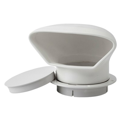

I'm thinking about doing the same on my 44 DS. Defender currently has some of these on sale.
Anyone know the size of the hole through the deck for the existing dorade?
The 4" size says that the 'above deck cutout' is 4 3/4"

..........Anyone know the size of the hole through the deck for the existing dorade? The 4" size says that the 'above deck cutout' is 4 3/4"
I can help IF same as on my Hunter 46, which had a 4" SeaDog cowl and required a 4-3/4" cutout. I replaced mine with stainless steel cowls last year.

Mine looks exactly like the one at the link below from ebay. And it agrees that it is a 4 3/4" cut out. Nice.

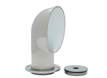

Thanks! Those look really nice. The soft plastic on my original one looks pretty sad at this point.

On my current boat I have one of the Buchan stainless dorade vents. Very nice piece of equipment for not that much more than the crappy plastic ones.
