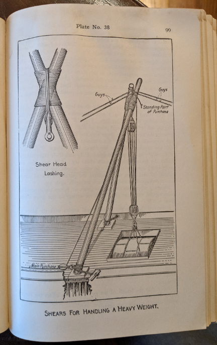

Don't know if anything like this gives you any ideas... The block and tackle could work, but I'd forego the "authenticity" and use an electric winch... I'd flip this 90 degrees, run the feet near the gunwale, and have it articulate back over your companionway, raise the batteries high enough, to clear, then move to where you can drop it down without hitting anything.... OH crap! just remembered you said you have the boat covered...
In the words of Lily Tomlin.. "Never mind"....
