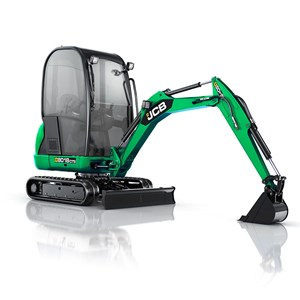

Last month we rented an excavator for some yard cleanup work in Virginia. Cost $300 a day. Maybe you could rent one by the hour for less.. put it in the bucket and lower it into your truck bed (or whatever). I just did a search for Charleston area and this one is $330/day
If you have room between the boats, you could drive this up to the cockpit, raise the arm, put the battery in the bucket, close the jaw to secure it and then drive it where you need it.
