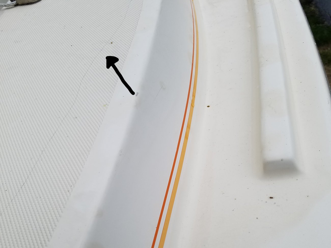

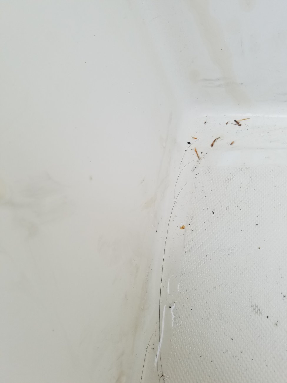

I do hope you may be able to offer some guidance regarding crack repairs on the coaming, the cockpit sole, and the cockpit drain area of my O'day 19. (please see attached pictures)
Your input will be greatly appreciated.

BG, those don't look like bad cracks to me... most likely, it's just stress cracks in old gelcoat. Take a Dremel-type hand tool with one of those curved conical grinding heads, then grind out the crack. Get down to the fiberglass underneath, and make sure that's not damaged. If it is, you'll need to grind out whatever FG is damaged, and it's more of a repair.
What scares me is trying to fill the gelcoat back in. I'm more engineer than I am artist, and the thought of mixing gelcoat to match the existing stuff scares the bejeezees out of me. By the time I get the color settled, the gelcoat will have been cured for a week. That's one reason I settled on using epoxy instead of polyester or vinylester for my repairs, and painting over the hull. Forget about the other benefits of epoxy... I'll be there for a year and a half trying to match gelcoat colors. Instead, I'll just pick up another quart of Rustoleum Top Coat every season.

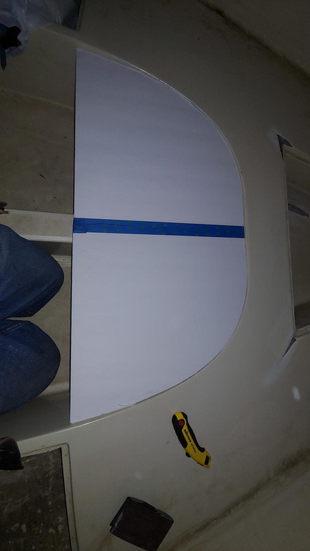

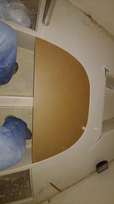

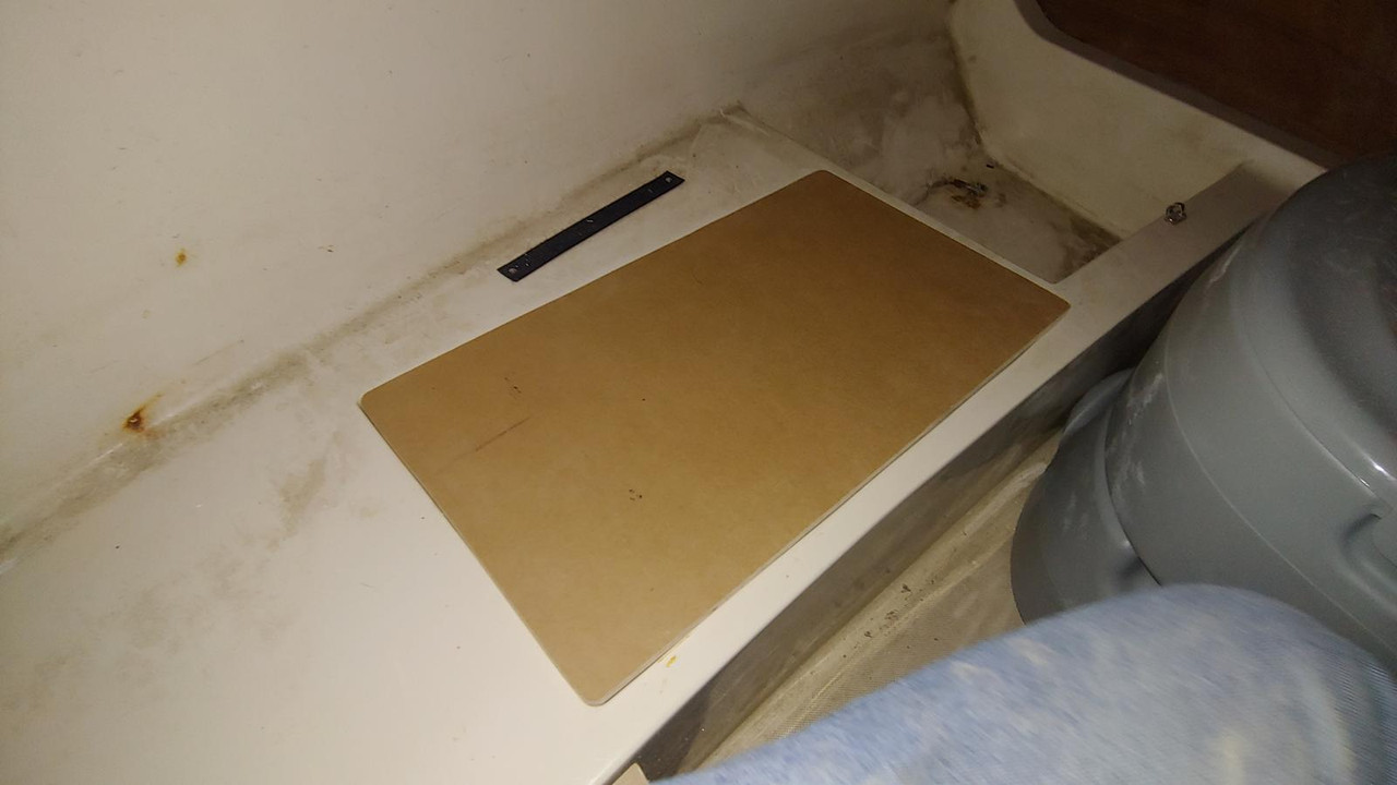

Cut out plywood covers for the cabin interior. Getting close and closer...

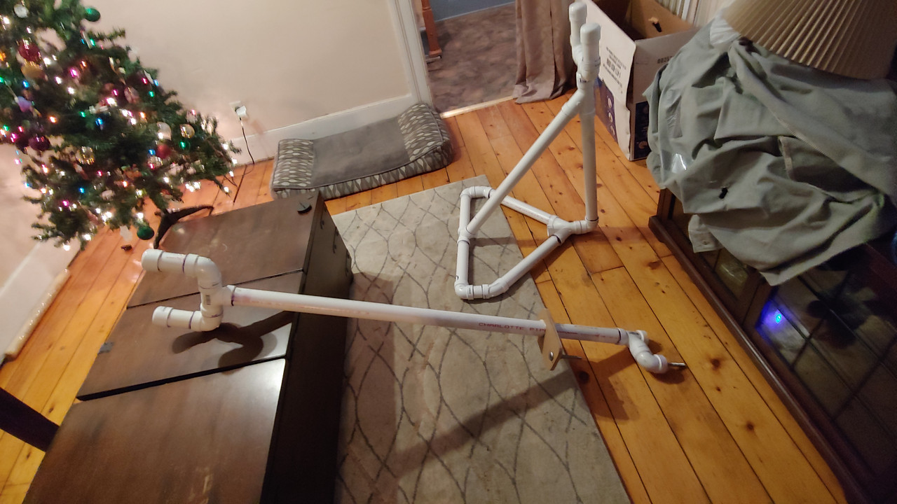

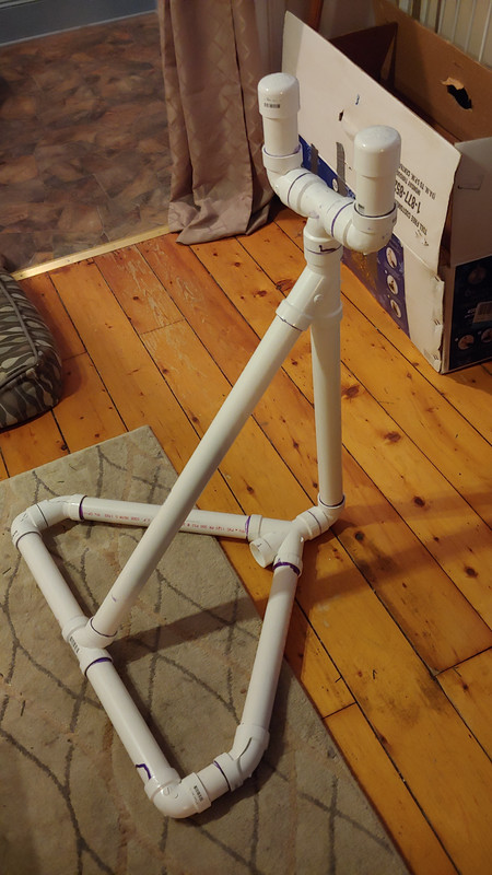

Wasn't all that happy with the wood supports I had jerry/jury rigged up (cheap and what I had on hand at the time). Had a large tarp on the boat, too, preventing easy access to the cockpit and cabin while it was covered. It's keeping me from working on the boat in the cold months... so I took a day and build new mast supports, then covered it with smaller tarps.
Not shown is the center support, it's it's little more than that upper support stuck in a chunk of 4x4 with the edges trimmed down a bit to fit in the mast step.
