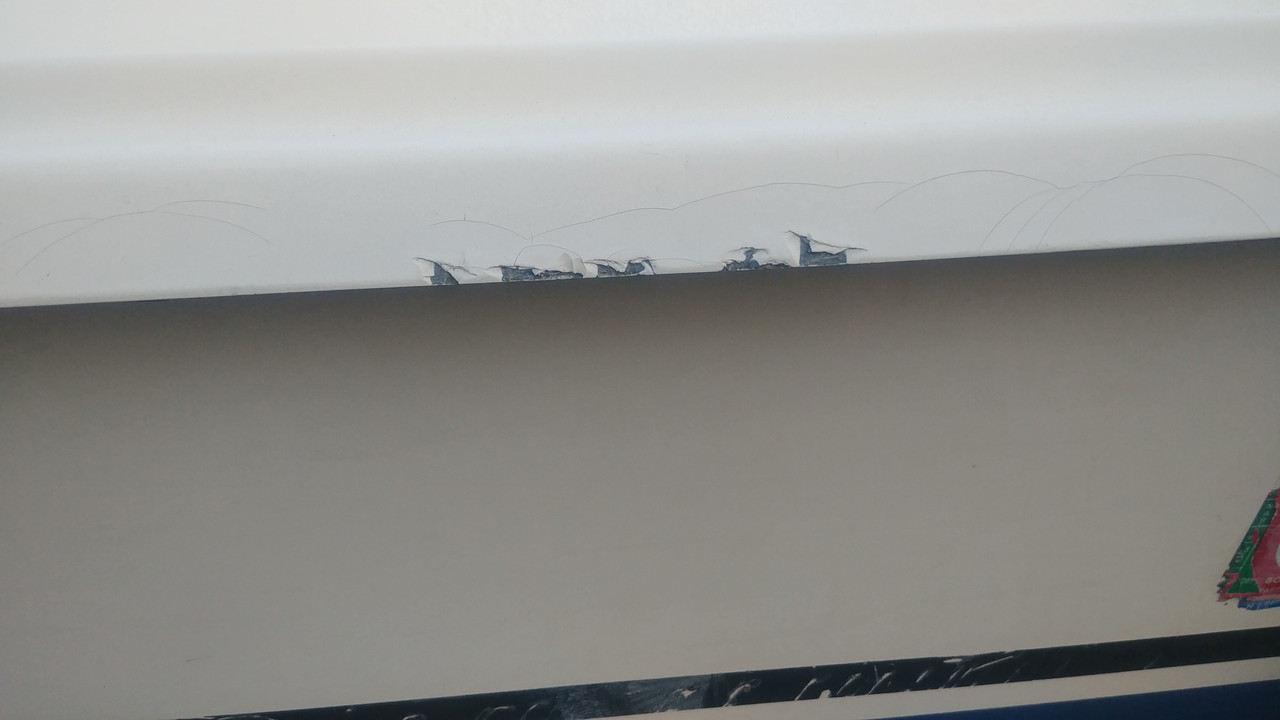

  • There's plenty of nicks and dings to the gelcoat that need to be cleaned up.

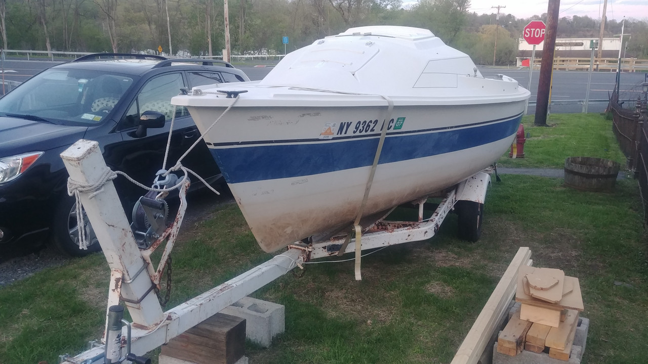

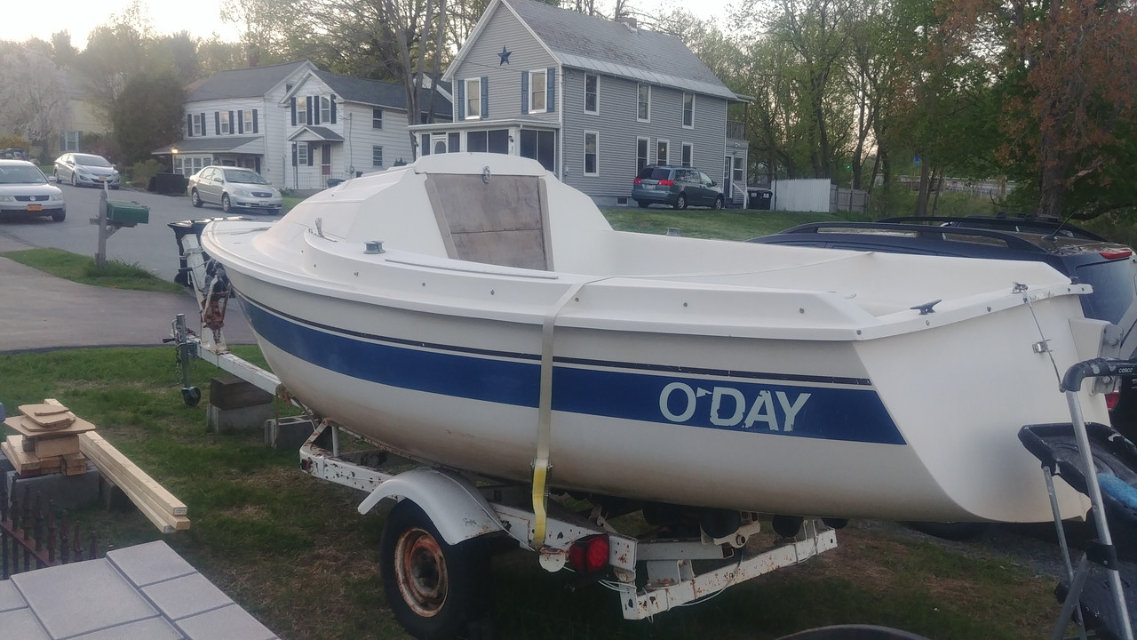

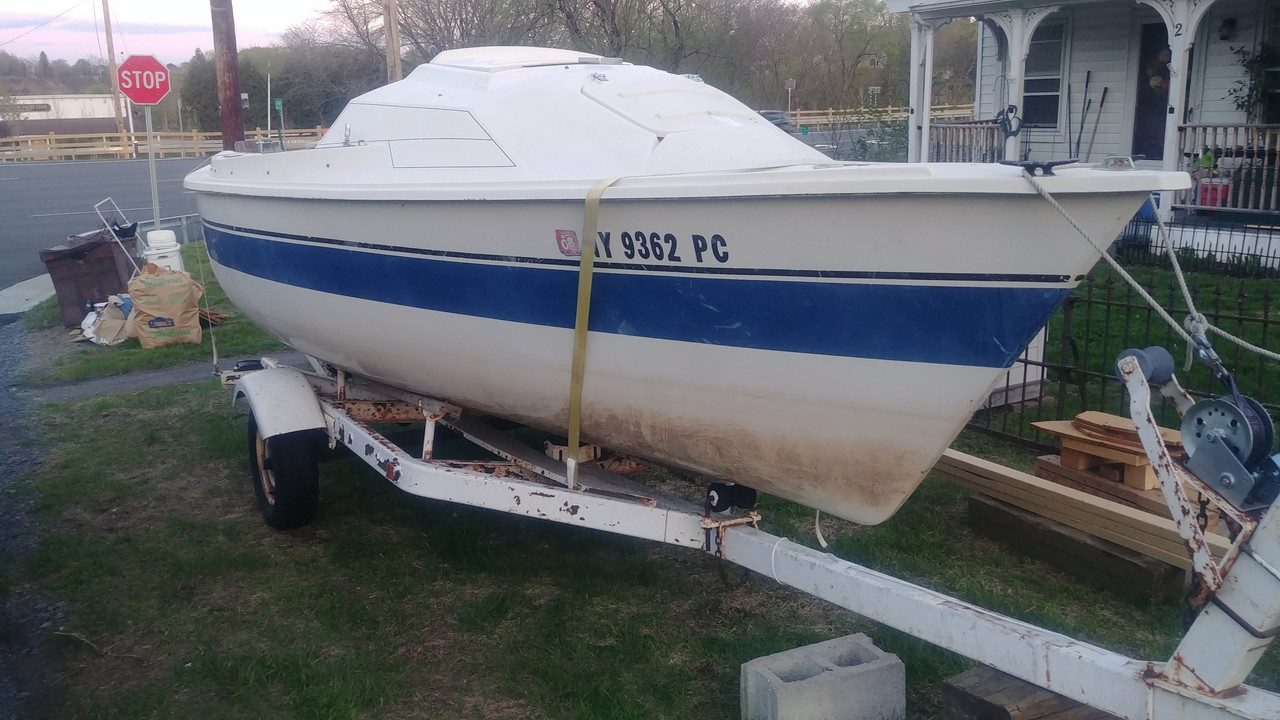

Her best angle first:
Pretty obvious where I've been using Barkeeper's Friend to clean off the scum from the hull:
She looks pretty good from this angle, too:

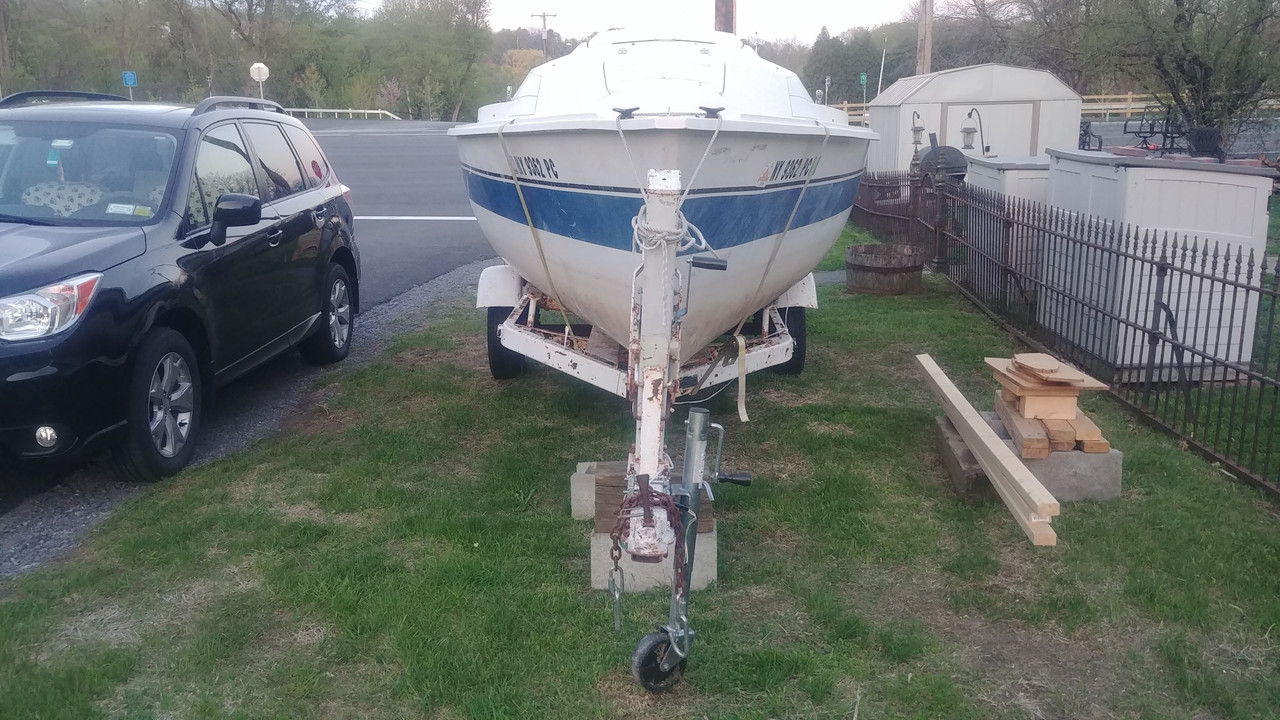

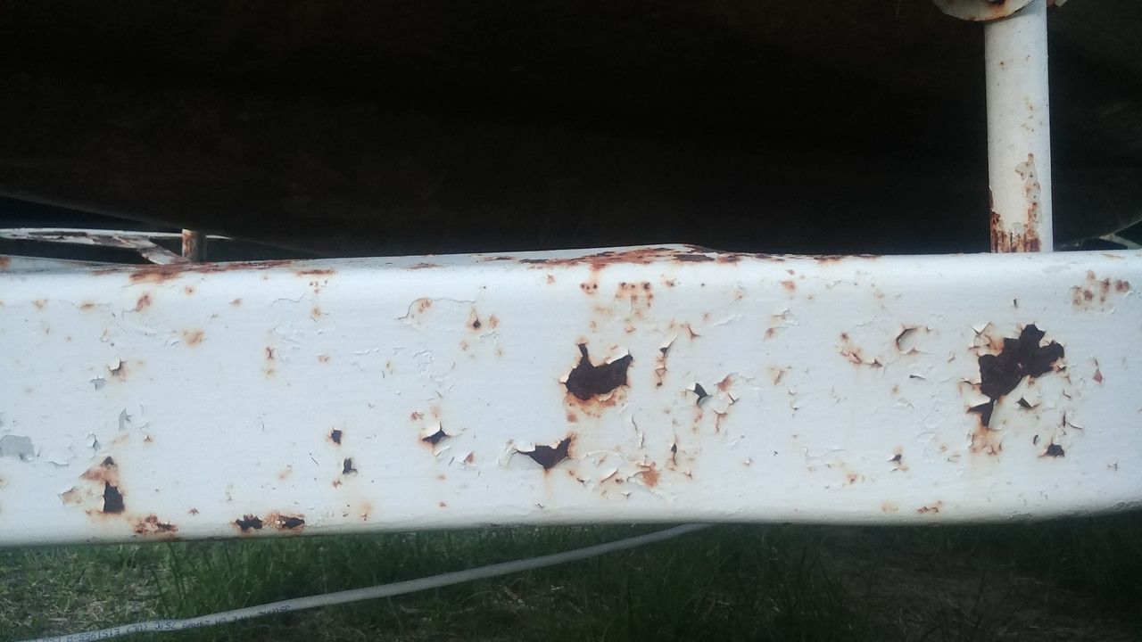

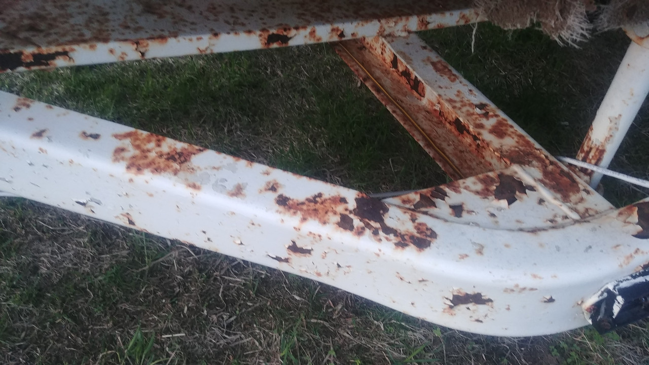

Trailer is bent right about here:
You can see where the C-channel's crimped upwards a bit on the top. Needs a good sandblasting and painting, too:
Sure looks like the frame's twisted a bit from this angle, too:

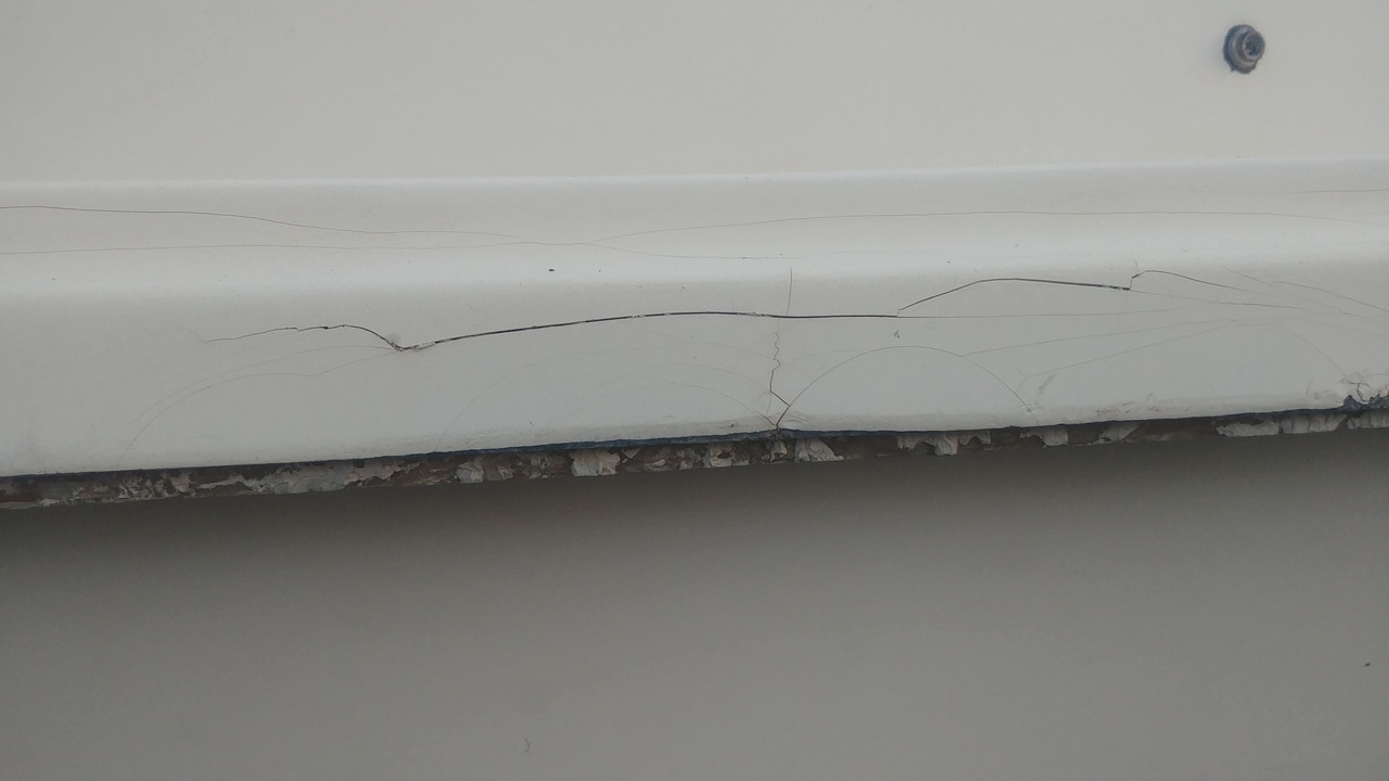

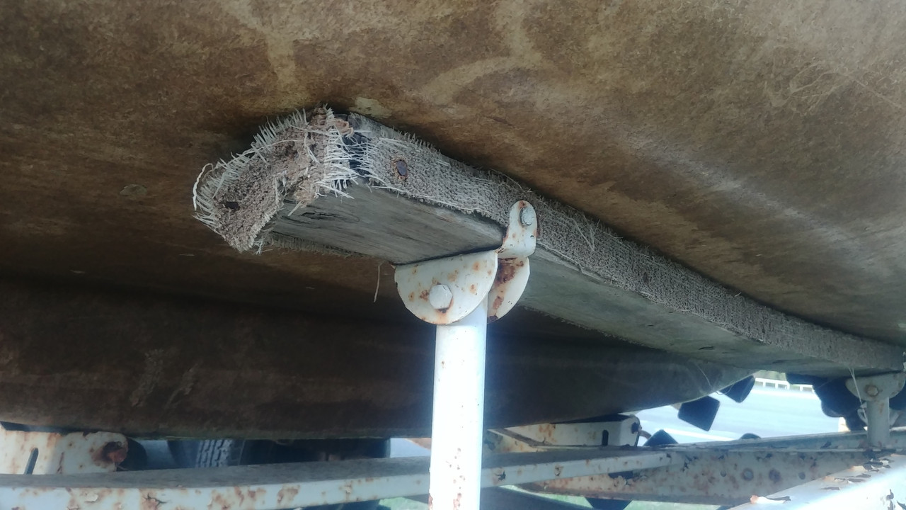

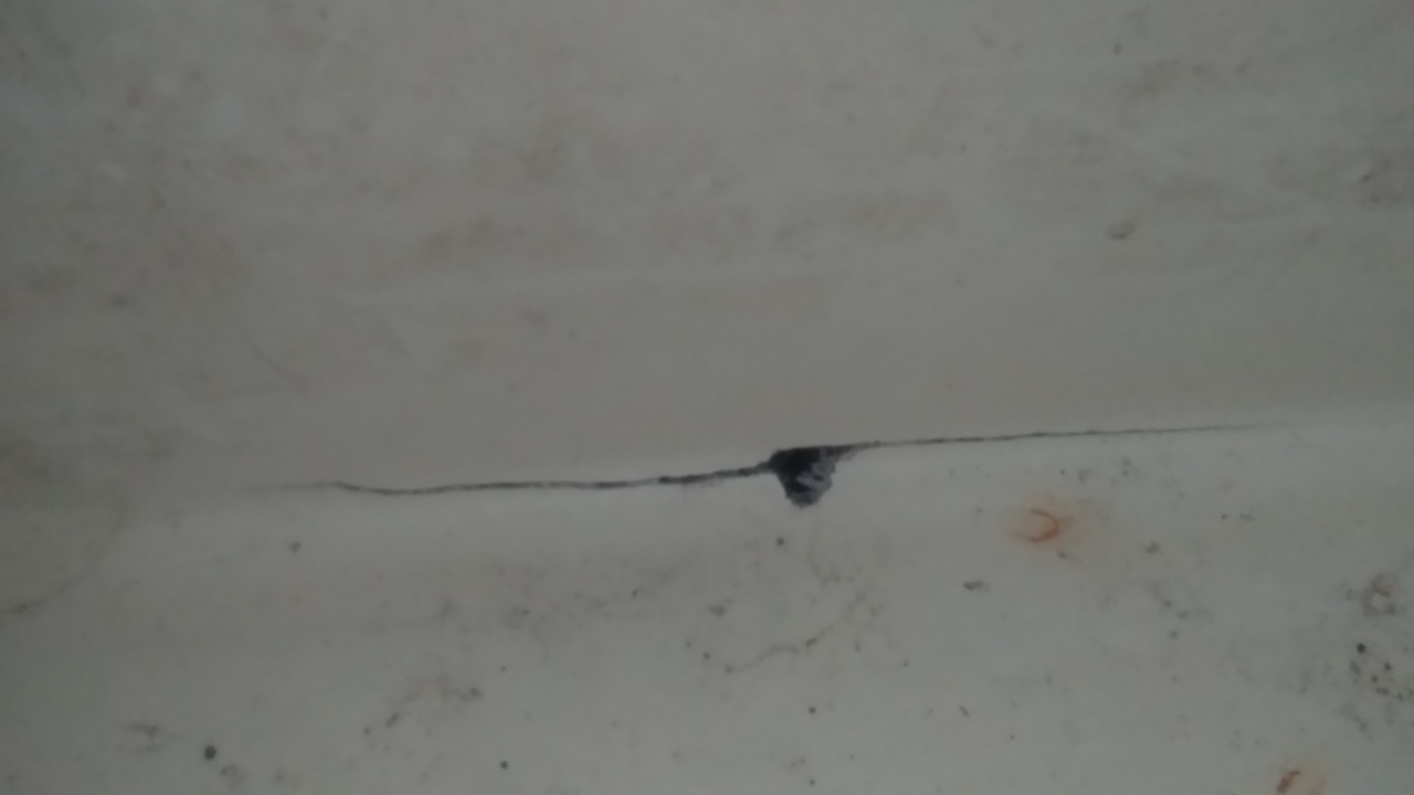

Now for the ugly. Hard to see, but the hull's oil canned here a bit, and that rotted bunk is hiding a good crack. When I first saw her, that bunk was tilted up at an angle. I lifted the bow up a bit and twisted the bunk back to flat. Didn't want it doing any more damage if I walked in the boat:

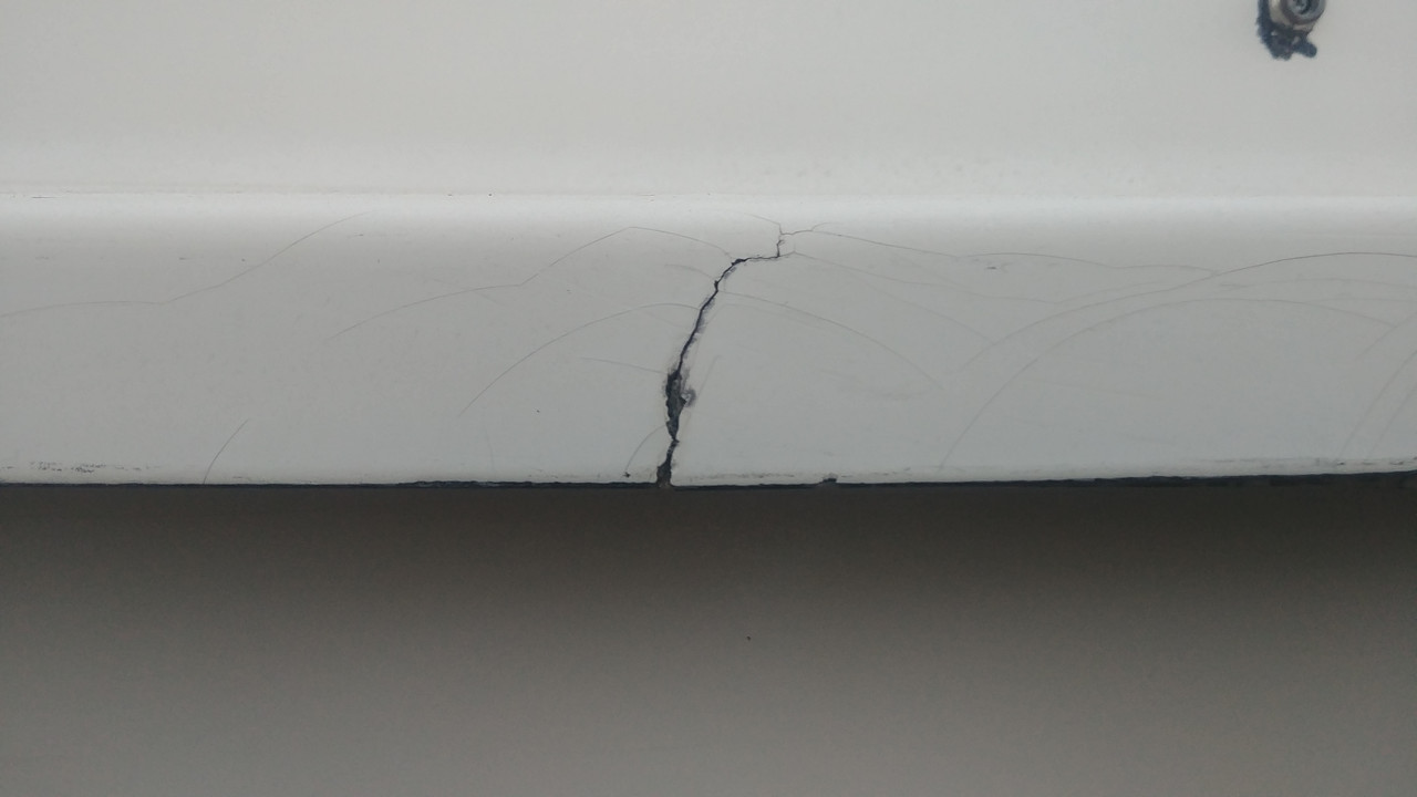

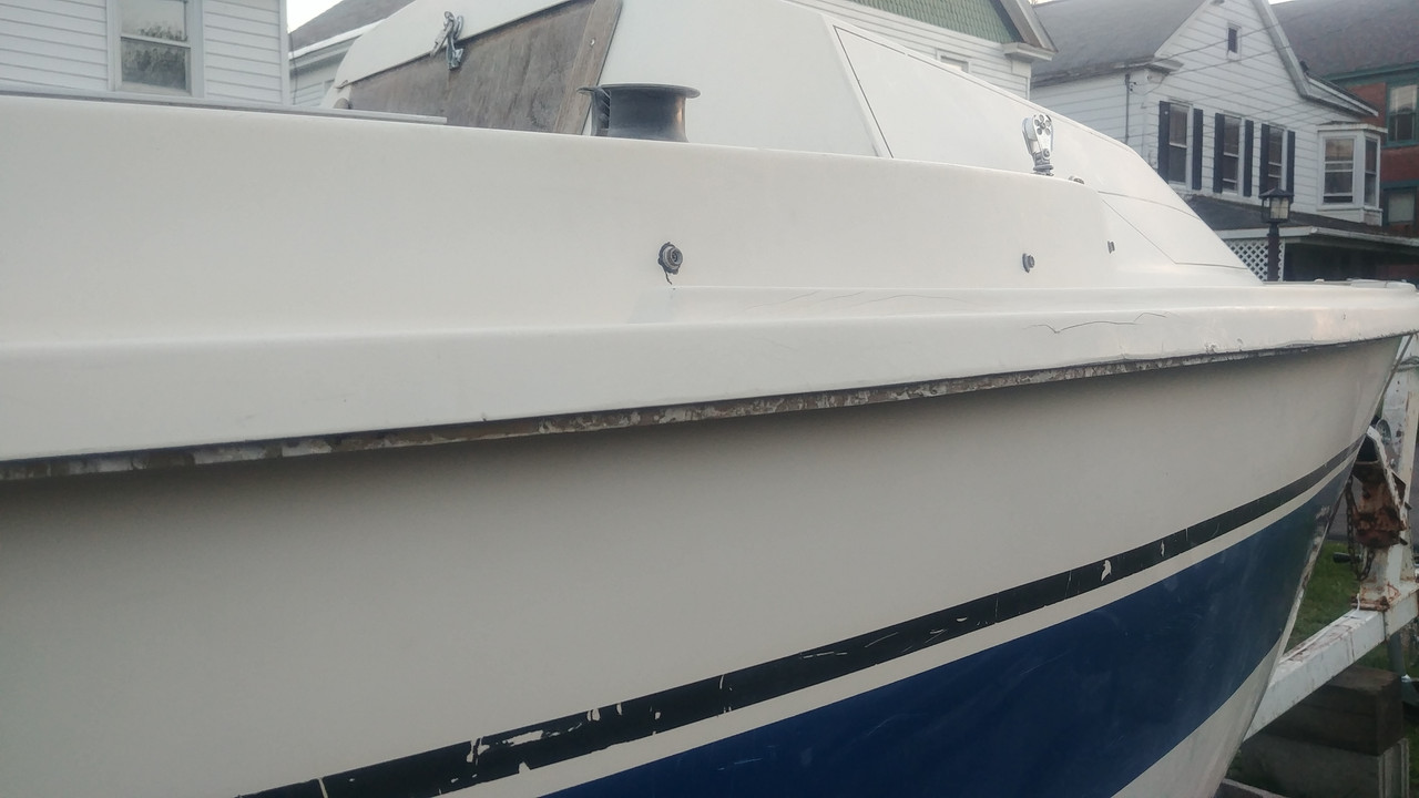

Whole starboard deck/hull joint is separated. Gonna need to get the joint cleaned out, sanded roughly, pumped full of 5200, then clamped down:
Gonna have plenty of fiberglass & gelcoat to repair on the joint, too:

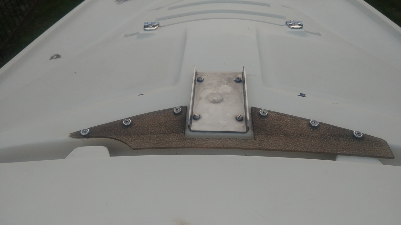

That plastic bit, probably meant to serve as a bump for the rudder (anyone know the name?) is broken off. There's a snap on it for the canvas cockpit cover, probably overstressed it and snapped it:

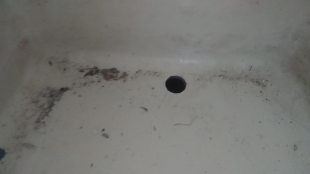

Transom bit of my temporary drain repair. Should have this fixed next week, once parts are in:

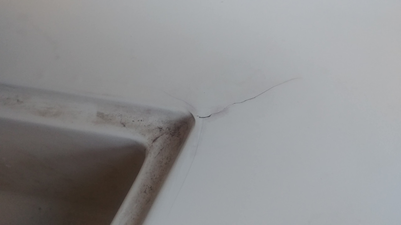

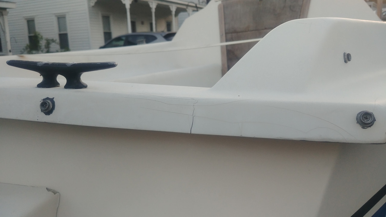

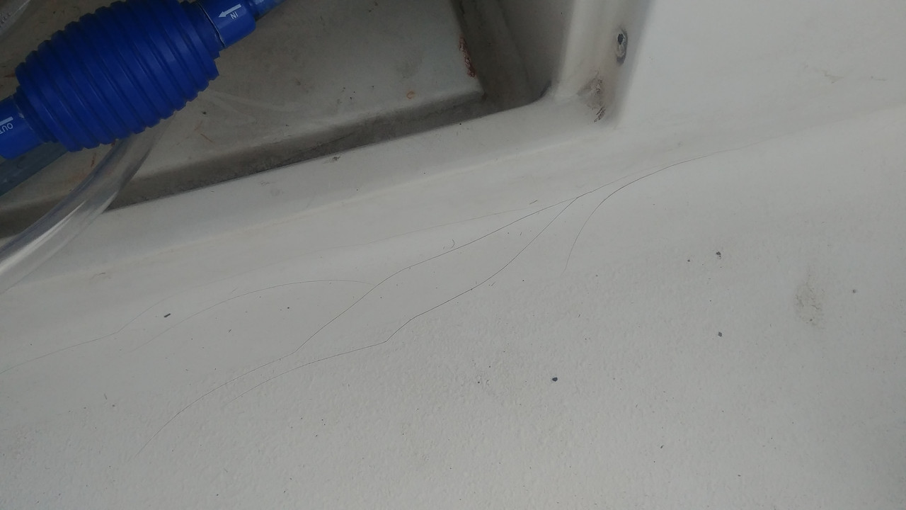

Cockpit floor has a stress gelcoat crack. Might see if I can get the floor reinforced/braced a bit, since it does flex a bit:

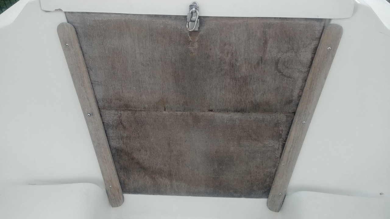

Gonna try to clean up this teak, though I might just replace it. Plywood's worse off than the trim. That said, a little epoxy and varnish, and it'd be fine structurally. Might need to wait 'til next year:

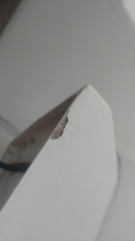

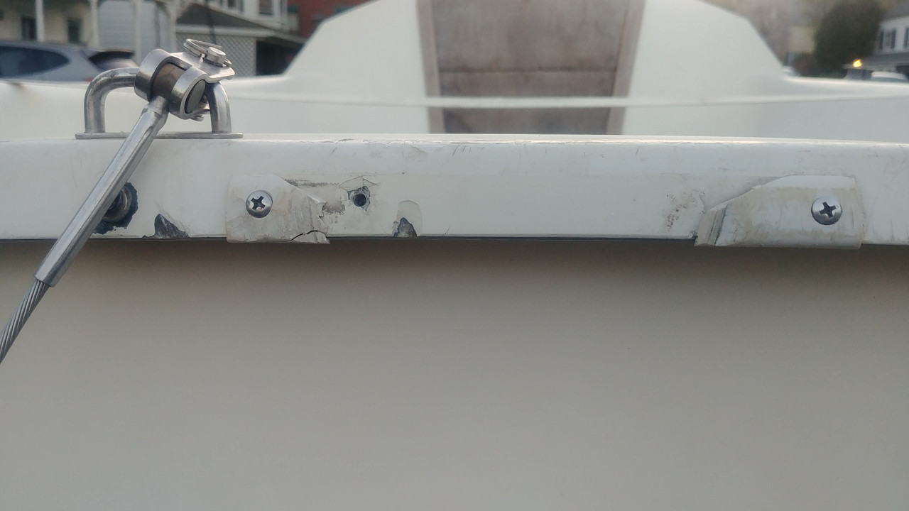

Companionway hatch retaining plate is got a notch knocked out of it:

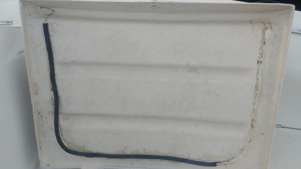

Weatherstrip needs to be replaced:
A few nicks and gouges on the cover needs to be fixed:

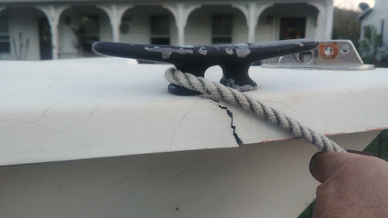

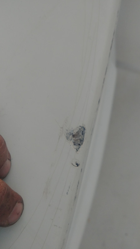

Port chainplate for the rigging near the jib car has gelcoat stress fractures, too:

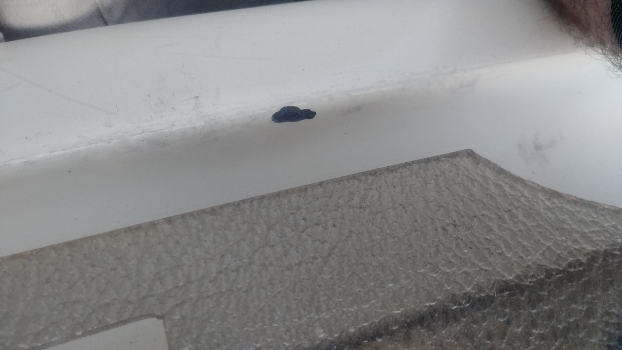

Got a chip in the gelcoat where the hatch sits:

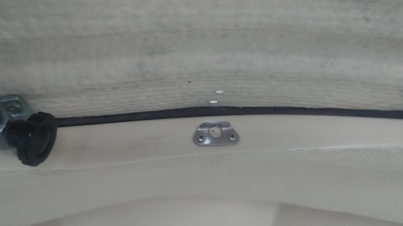

Missing the retaining bits for the forward hatch:

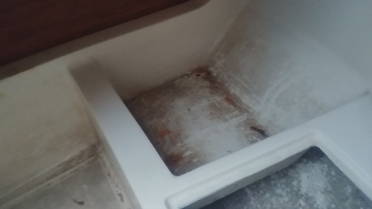

Crack in the "icebox" under the v-berth in the cabin:
And cleaning up a couple of holes I drilled trying to pump the water out of the bow. Should've just gotten it from the bilge. Ah, well. More opportunity to become better at fiberglass repair:
Semi-patched crack in the corner of that "icebox":

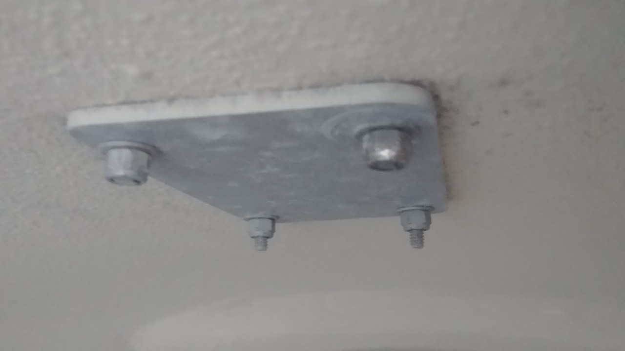

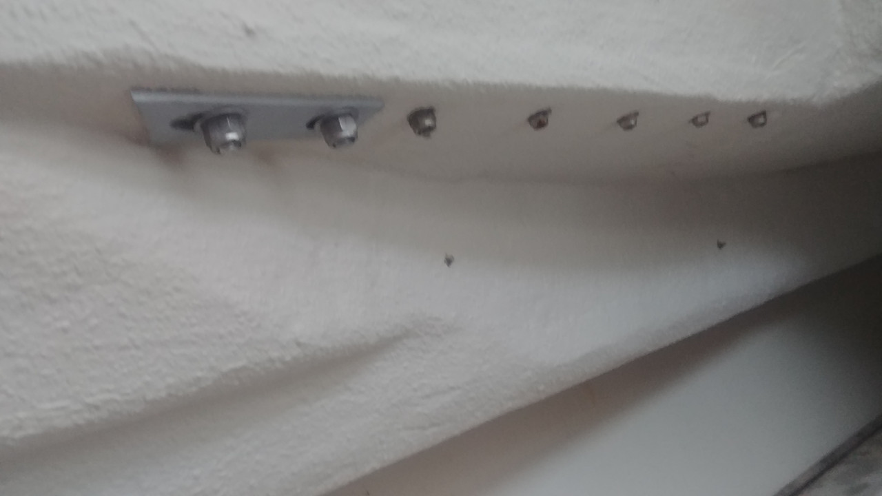

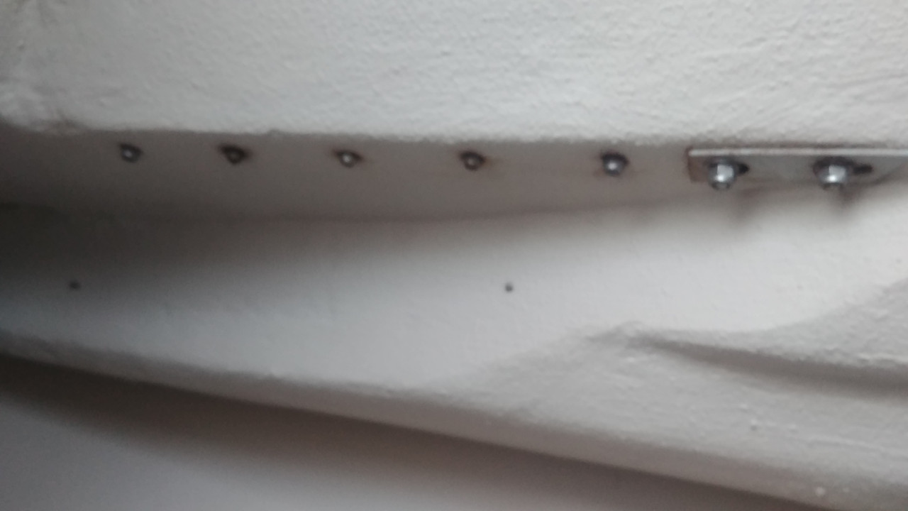

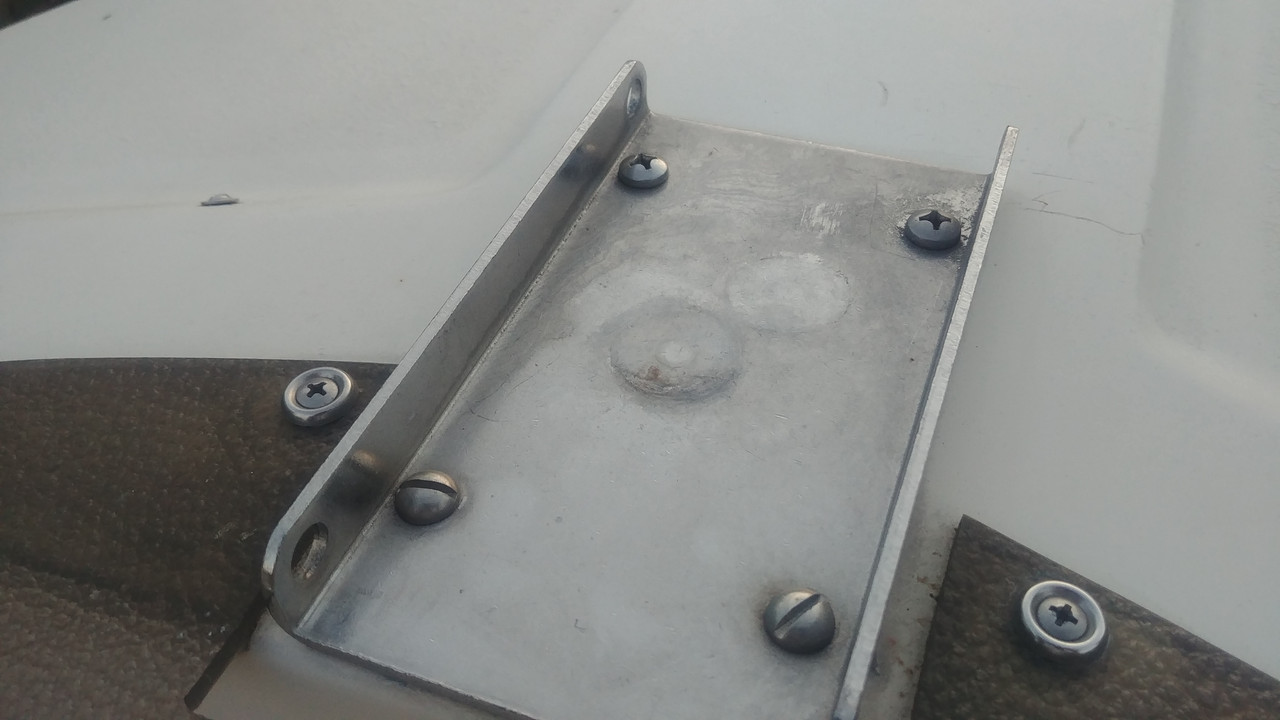

Odd thing about the tabernacle bolts... two are neatly cut/ground off. Other two aren't:
Different style bolts, too... Phillips vs flat head. Kinda thinking it might be worth popping that off and getting a good look at what's underneath. Just to be safe:

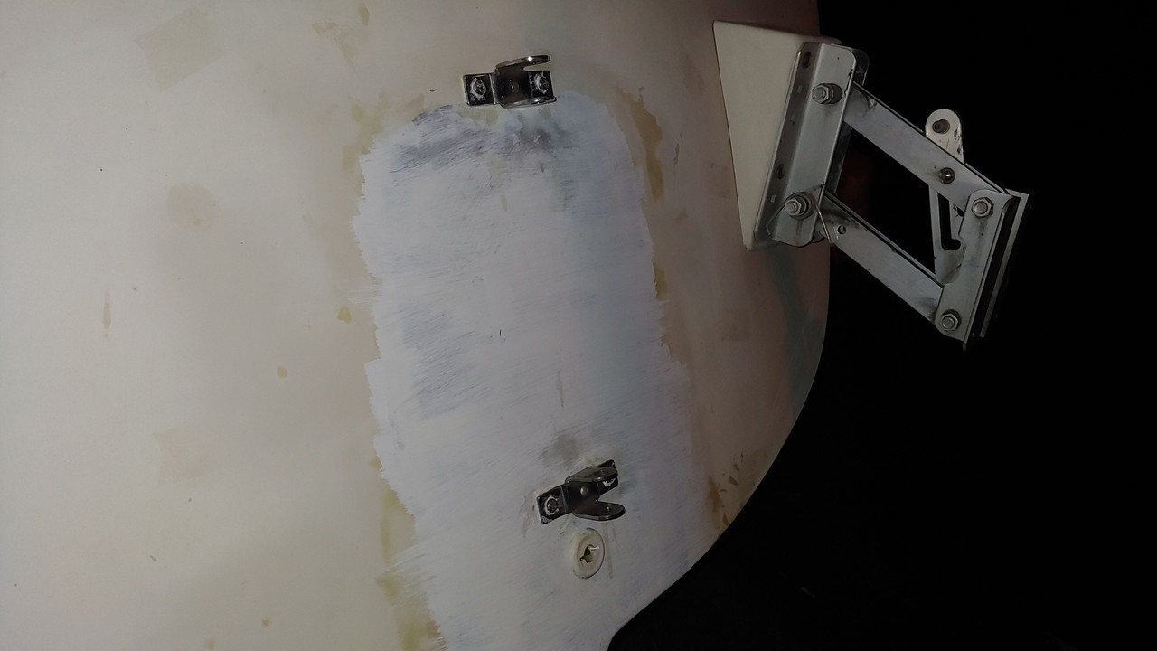

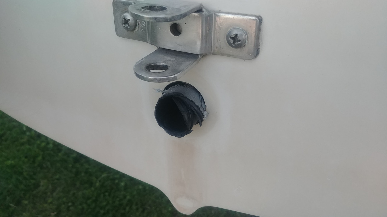

The plywood core in the transom is definitely rotted around the drain. Did some more poking around the mount holes for the lower gudgeon, and it's rotted there. Did some exploratory drilling up, and I start hitting dry plywood a couple inches below the upper gudgeon.
My current plan:
  • Mark up a template for the lower gudgeon location (done)
  • Mark out a box to cut through the outer layer of fiberglass, preferably inside the edge of the plywood. I can always cut more out later. (done)
  • Remove the outer layer of fiberglass.
  • Clean out the rotted plywood.
  • Bed the plywood in epoxy.
  • Fiberglass over the new core.
  • Drill oversized holes for the transom drain & lower gudgeon.
  • Fill the holes with epoxy (sealing both ends with tape, since the transom's a vertical surface). Using a syringe to deliver the epoxy might help here
  • Either let the epoxy cure properly and wash any blush off well, then use CSM and polyester resin for a final layer, then gelcoat... or just bite the bullet and paint over the entire bottom sides.
  • Drill the proper sized holes for the drain & gudeon.

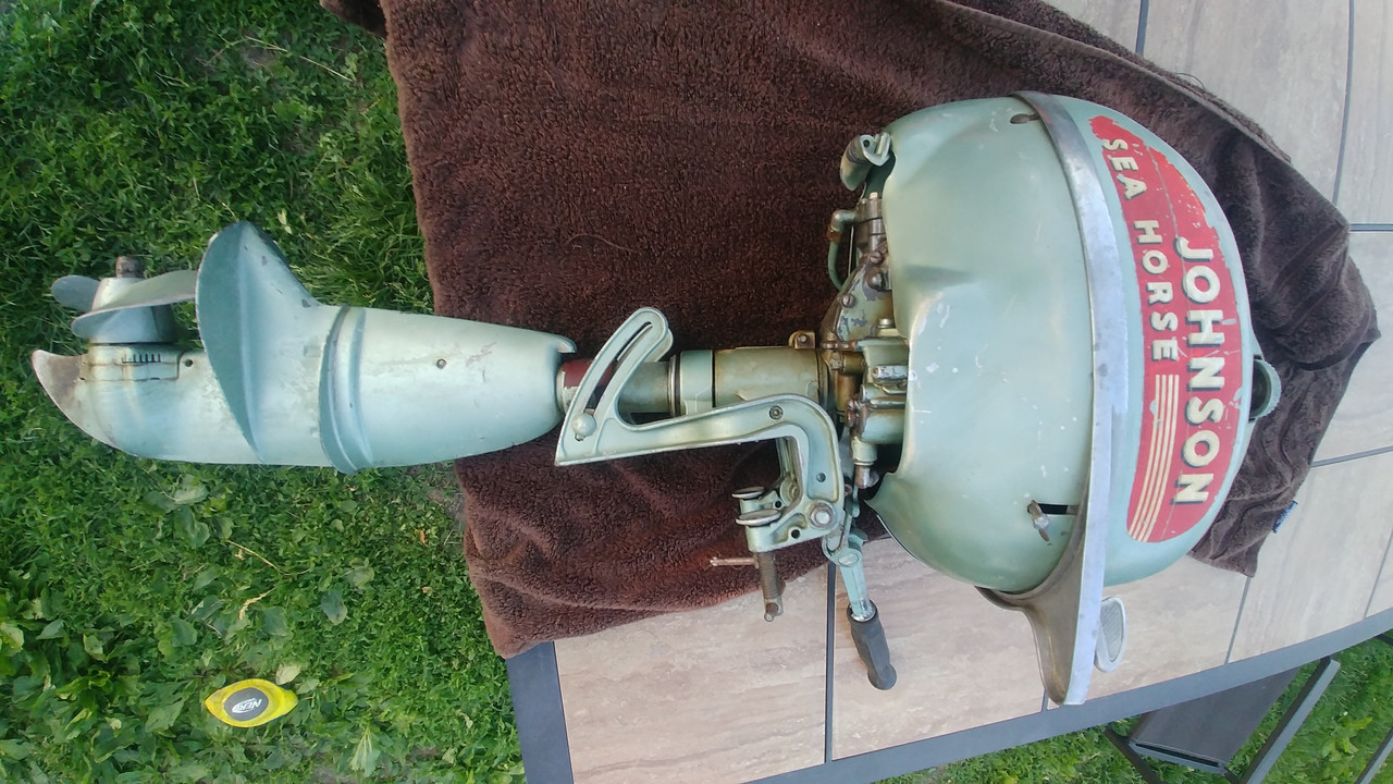

I can't think of anything helpful to add, but you might save money by going with a smaller motor. The Mariner 19, that I own, moves along quite well with 2hp. Most, however, use a 4 horse. I am planning on putting a trolling motor on mine and those that I've talked to, that use them, have no complaints for power and speed. The Mariner is about 600 lbs lighter, so that may not be the case for the O19.

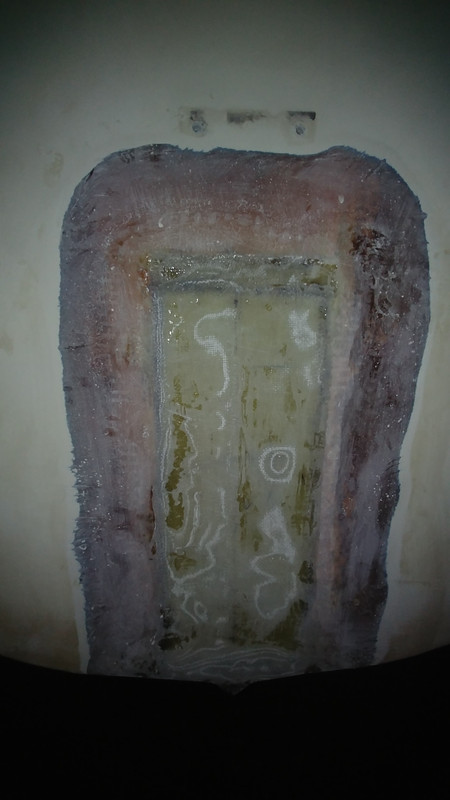

So far, I've gotten the outer layer of fiberglass cut out, then cut/chiseled/pulled out the rotten rudder backing. I shouldn't have cut down so far, since I'm going to need to wrap the fiberglass under the hull to get a 12:1 bevel. If I had to do it over again, I'd have cut three inches above the bottom of the transom, then dug the rotten wood out from there. Ah well... now I know.
Epoxied new MDO plywood in there, then started layering in 6 ounce weave. It's now more or less level with the bottom of the bevel. I'd keep going, 'cept I ran out of epoxy. I had picked up a quart of it, expecting to use it on the Force 5 dinghy (mast tube crack & backing for the hull repair). I'll order a gallon of resin and half a gallon of 2:1 slow hardener this time around. Temperatures are starting to get up there outside, and having the extra working time would be nice.

Will be, assuming I can get it running. 'Til then, it's just a fancy, heavy, and rather poor paddle :D.

The transom repair is complete, at least in regards to the rudder backing. Fiberglass is done, faired, and smoothed. Got a coat of topsides primer over it, keeping the UV off the FG. Over drilled the mounting holes for the rudder gudgeons, just gotta drill the centers out and remount them.

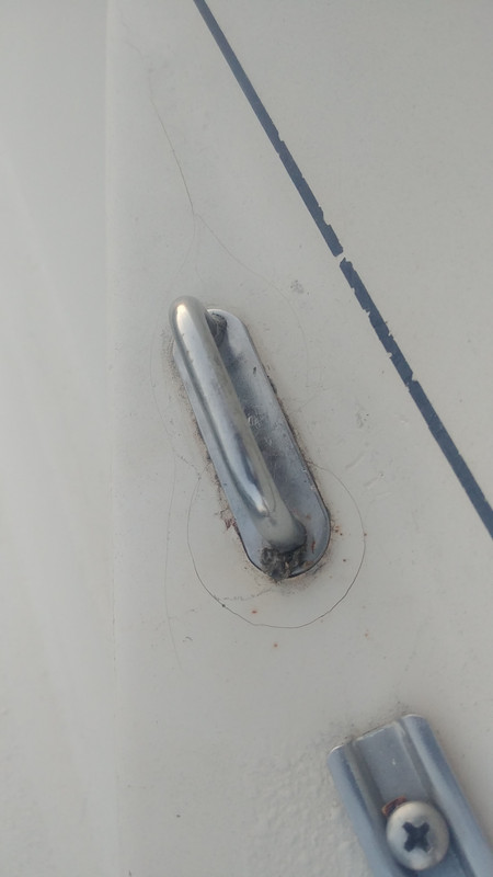

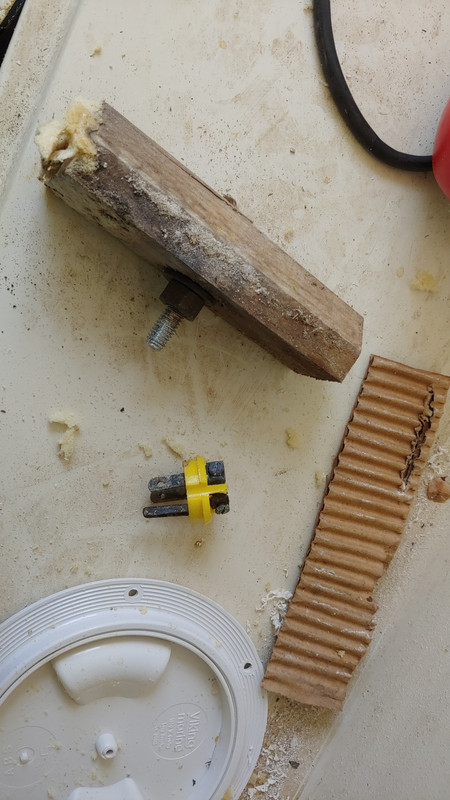

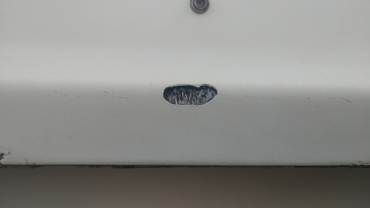

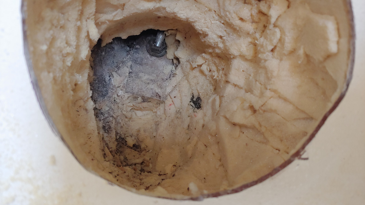

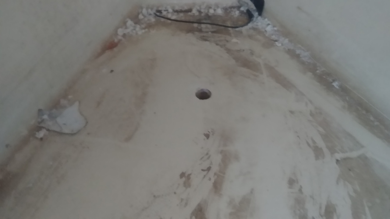

Took a stab at the bow eye... even in the last for sale pic I've been able to find, back in 2012, there was no bow eye there. Looks like all the prior owners since them have been tying off the trailer to the cleats, which I don't like. The angle's just wrong, pulling the bow down instead of forward. So I cut an access hole in the interior liner, then trimmed away the flotation foam to get at the bolt and backing wood.

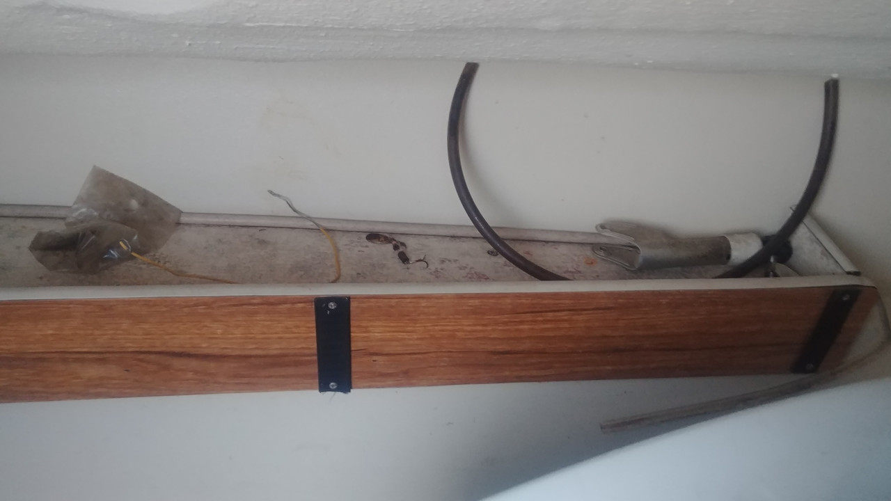

Discovered an electrical plug bouncing around in the same cavity, as well as some loose cardboard. Makes me think some worker cleaned off his workbench into the hull... maybe the garbage can was too far away? :laugh:

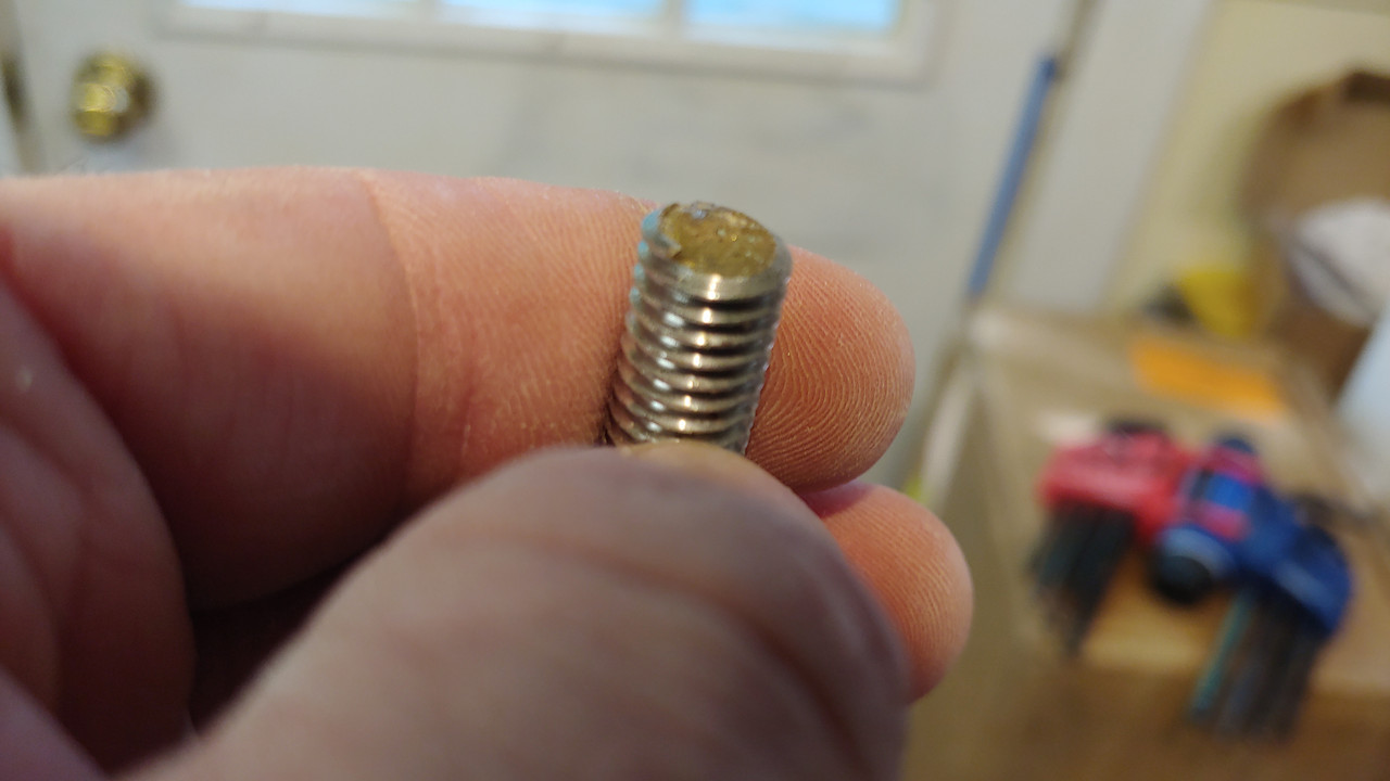

After I got the backing out and examined the bolt... it looks like it pulled straight out. I don't see any bends in the broken bolt, though I'd feel better if I had seen the rest of the bolt. The backing looks clean, too... no rot, so it must have stayed dry. The hull around the entry point was covered up in some filler, which I didn't feel good about. I ground it away, and it turned out to be a thin layer over what looks like a decent fiberglass repair. Since I'm going to be painting over the hull anyway, I built up the area with some more fiberglass. Got a spot that's a little low, so I'll apply another layer or two of FG, then fair it out. The hole for the bolt had already been oversized and filled with that unknown filler, but since I was able to chip it away easily from inside the hole as well, I plan on filling the entire hole with more epoxy and drilling it out again. Once that's set, I'll be able to set the bow eye. I won't replace the flotation foam or set anything else permanently until I get the hull painted.
I'll get some more pics of the exterior of the bow eye install once it's cleaned up nice and neat. I'll be putting in an access plate, too, over that ugly hole in the interior liner.
