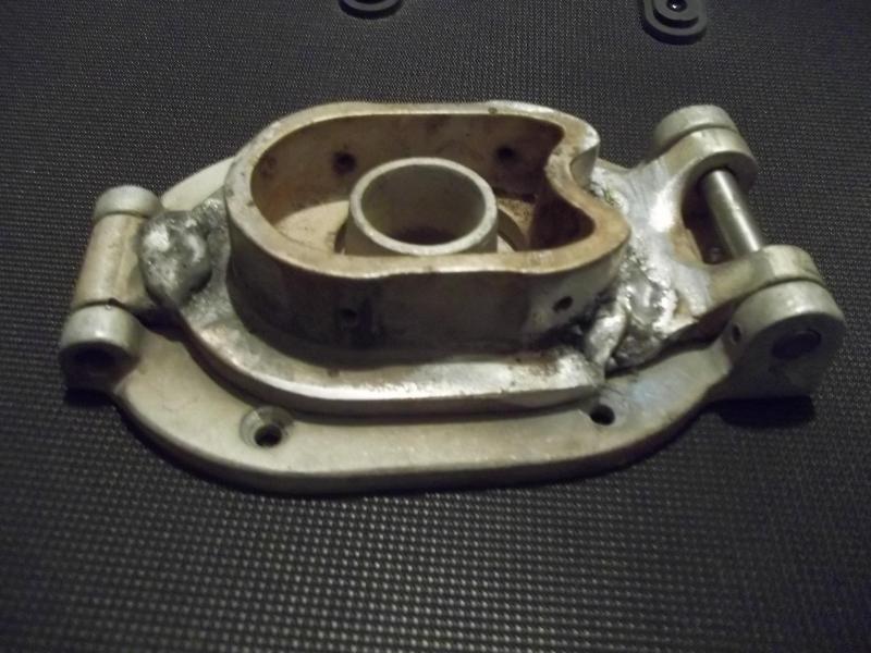

1st is the hinged mast step is broken between the mast and the rear hinge pin. base plate is still in good condition.
I'm having a hard time visualizing that.... but you can buy tabernacles that should work for this boat. Or if you can find a MacGregor 22, or Catalina 22 that is being parted out that one should work for you.

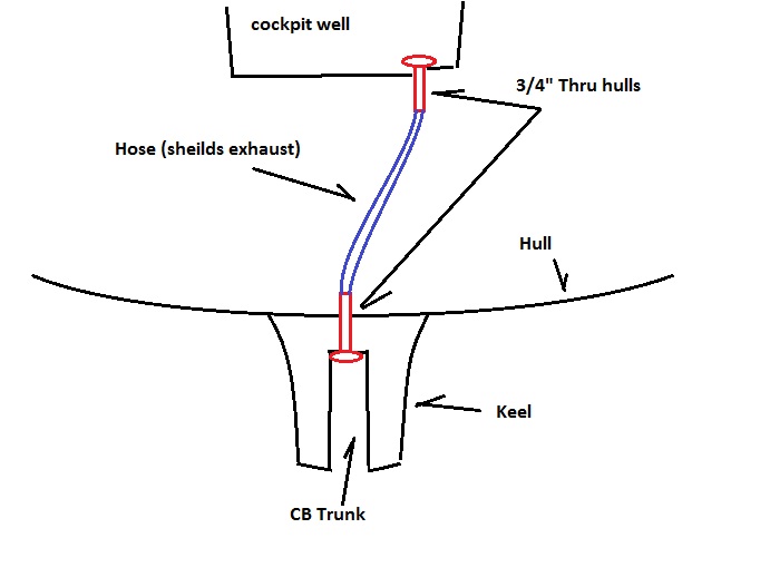

My CB lifting hardware was missing with exception to a rotted turning block in the front of the bilge and the stuffing tube that the rod is supposed to run through. In the pic below you'll see what I'm talking about. My CB is a hunk of steel encased in fiberglass and weighs about 60 lbs. The ballast is in the fixed portion of the keel.
I didn't care to restore what was, in my opinion, a system that was grossly over-engineered for my non-inboard boat so I followed a 22 owners mod and refitted mine with a double braid line running up thru a tube into the cockpit well and held by a cam cleat. I put a loop in this line with a block for the Mrs. but without it only requires 20-25 lbs of pull to haul the board up.
Also below is a simple drawing of what I did. I can explain my system if you care to hear about it.

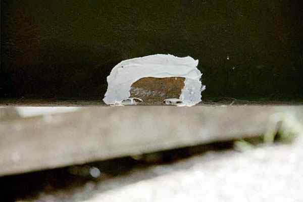

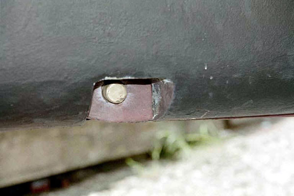

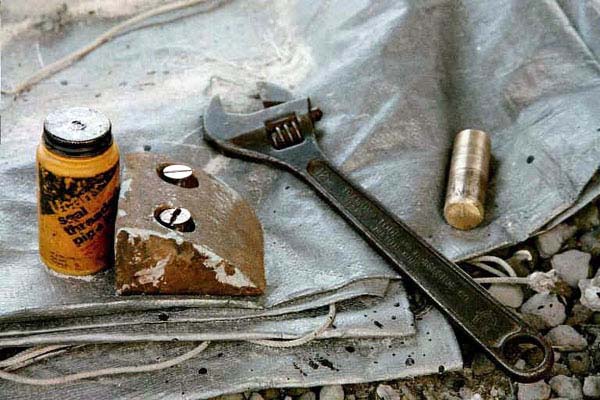

The pin is held in by 2 bronze blocks that have 2 screws each going into a slab of something embedded into the hull. Pics attached.

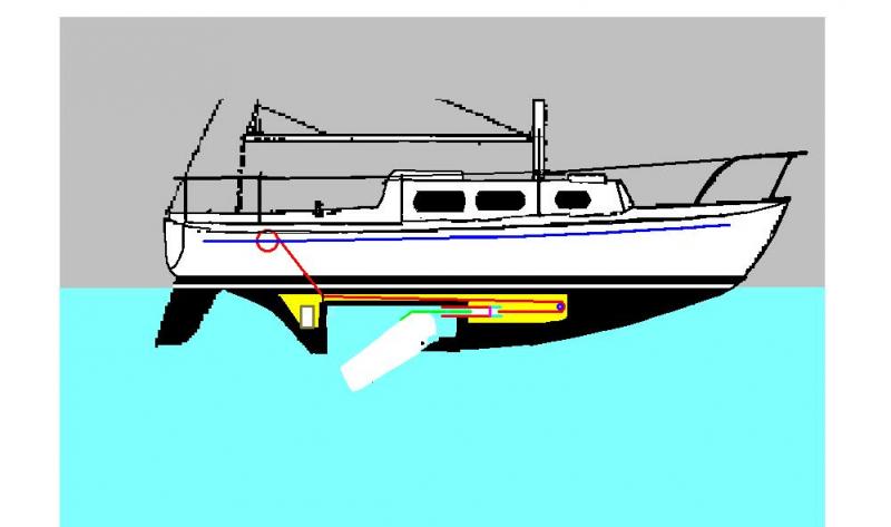

You're right, the shaft going thru the stuffing box originally was a hollow tube with the wire rope potted. Here is a link for Bob Horan's Morgan 24 site in case you haven't seen it http://morgan24site.com.istemp.com/ and his page on the fix for the shaft http://morgan24site.com.istemp.com/Morgancbpage.htm and here's Miguel Checa's site on his 30, but a lot of info on other Morgans.

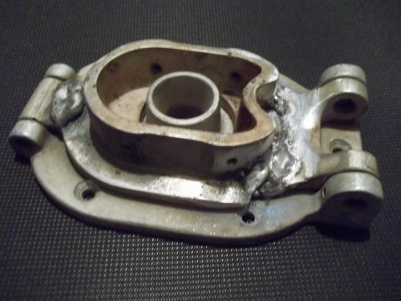

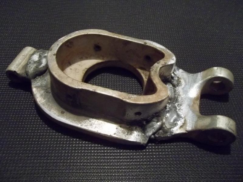

I say I hope because the mast step is a bigger problem than I thought. Turns out it can't be welded. I had two very experienced cast iron and cast alum. welders try to fix it. They both said it appears to have too many impurities in it. It just burns up when you put heat to it. Here are some pics of end result. It looks like two kids tried to fix it but both these men have been welding alum. and cast for 30yrs. Is there any of these things out there anywhere? I'd like to stay with original design but open to suggestions. Ft. Worth machine shops want more than I paid for the boat to machine a new one.

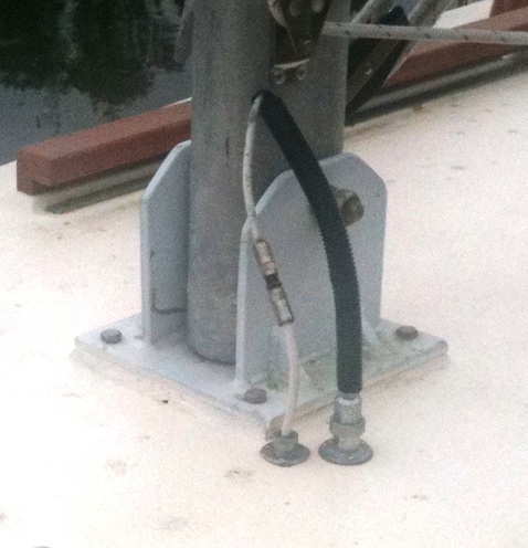

My boat has a heavy custom tabernacle and no base needed. I'll get pics and dims tomorrow and you can see if it would work for you.
It's welded aluminum so shouldn't be pricey.

Hey man, was your welders using high-frequency tig to weld that? It sure doesn't look like it. If they weren't, shop around one more time until you find a H.F. heli-arc.

My base plate is still good. I just need the insert like the one on Chuck Wagons link. Does anyone know if the mast insert on the 22 is the same size as the 24? And yes they used a tig and several other methods that usually work on this type of material but nothing worked. Not sure why but maybe it was just a really bad batch of cast alum. I'll call D&R tomorrow for size and price. The 22's insert is 2.75in x 4in. That's the part that slips inside the mast.

not cleaned correctly for welding.......
that looks like it wasn't cleaned before welding.......you must grind a bevel on the weld joints along with cleaning with a SS wire brush till it shines like new in order to get the impurities out of the base metal...other wise your tig tip (tungsten) will ball up with contaminated metal making it look like is was stick welded or even worse ox/act torch welded witch in either case is not acceptable........

I have what Joe is talking about and it works great. Mine was made for a PO by a welding shop and has no mast base, just a bolt through the mast to pivot on. There is a verticle slot cut in the mast.

Yeah, I'm still with the welding thing. Truly, and I swear I'm not trying to be offensive, but the welding attempt on that would get a welder run off the job. Seriously. When I said tig, I meant HIGH FREQUENCY tig. Huge difference. I've welded cast aluminum wheels with H.F.
And like said, put that part in a glass beader,(sand-blast), to clean it of ALL impurities, and take it to a welder that REALLY knows what they're doing..

The mast step that Joe Blizzard showed you in his link is the same one I have on my boat. It works great. For the price of a sand blast and weld, you could have a new one.
