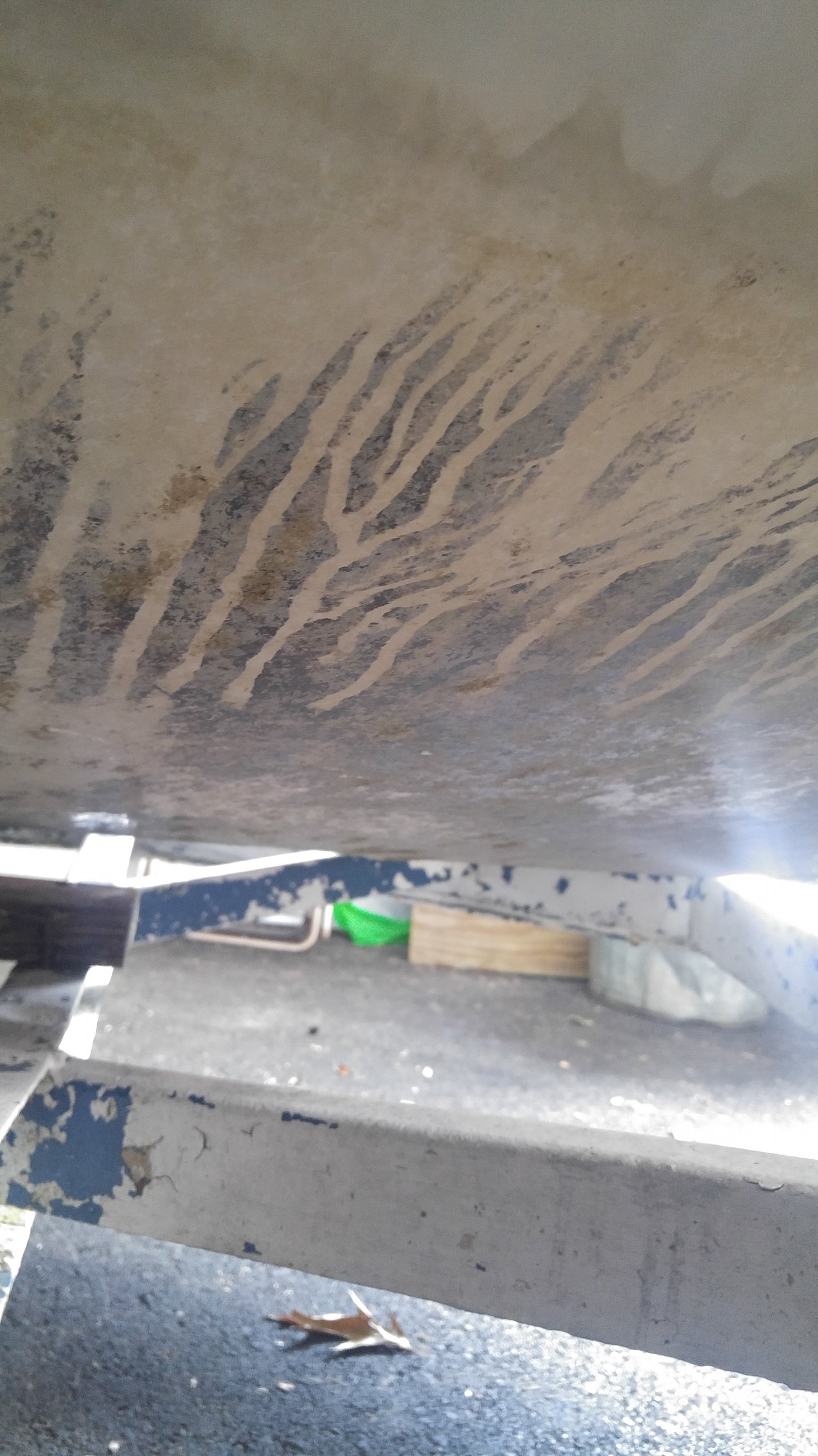

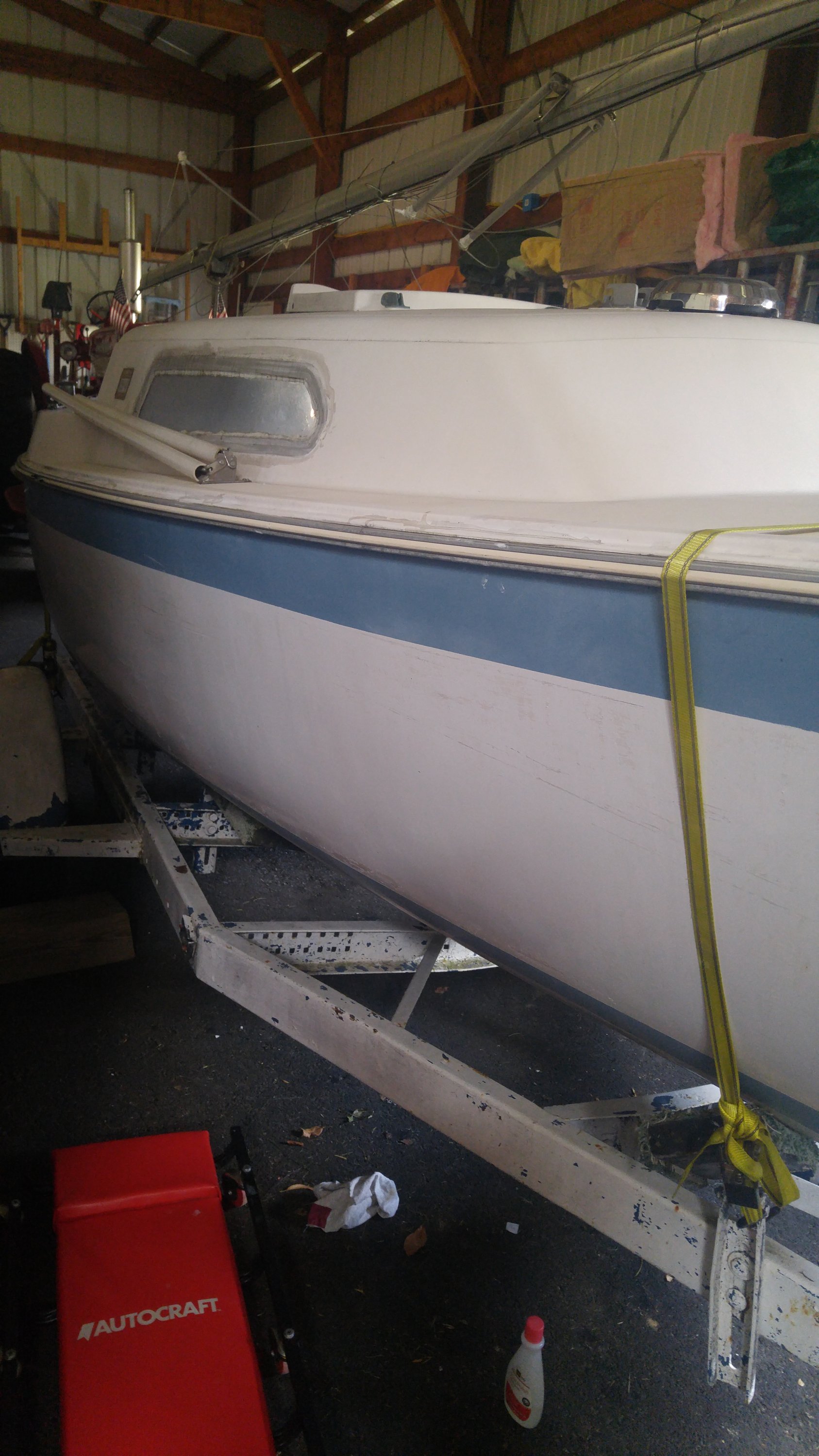

Hey guys, was away for the weekend and just got the chance to check out the bottom. I cleaned a small area with acetone to check if there was VC17 but it only cleaned the remainder of the dried green slime that the pressure washer didn't get. After looking closer it almost seems like someone painted it at some point, but didn't do a great job. Although I'm not 100% sure pn that. Here are some pictures.

The good news, the hull will come back with some elbow grease, rubbing compound, and wax. No need to paint.
Not sure if the bottom was ever painted. On an area you cleaned try some SoftScrub with bleach in it. See what happens.
14,231
Are there a lot of pine trees near the lake? You mention the water is murky, it could be some stream run off as well as tannin. Gelcoat is slightly porous so what you may be seeing is tannin stains. If that's the case, you'll never win the battle unless you do a bottom job, sand the bottom and then put a barrier coat and bottom paint on it.
