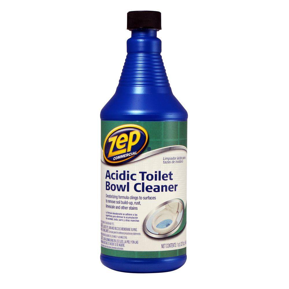

If the bottom has a lot of algae on it.... green or brown.... try an inexpensive acid based toilet bowl cleaner. Smart & Final sells it in their janitorial supplies section. Active ingredient is Hydrochloric acid and the algae (pond scum) will come off easily. After that, wash and rinse with soap and water.... now... what's left... does it look like paint over the gel coat.. is it flaking off anywhere? How smooth is it? Do you have a boot stripe (water line) ? Do some quick research to learn about the different types of bottom paints. Essentially, the hard shell type is for boats that are stored in the water year round... the ablatives are most popular for trailer sailors, and those that take their boat out of the water on a regular basis.

Joe has a good thought about an acid wash. Just go to the nearest hardware store and get some muriatic acid brush it on and rinse it off. Should take any growth with it. A gallon of muriatic acid (aka 30% hydrochloric acid) is a lot cheaper than toilet bowl cleaner. Neutralize with baking soda and water.

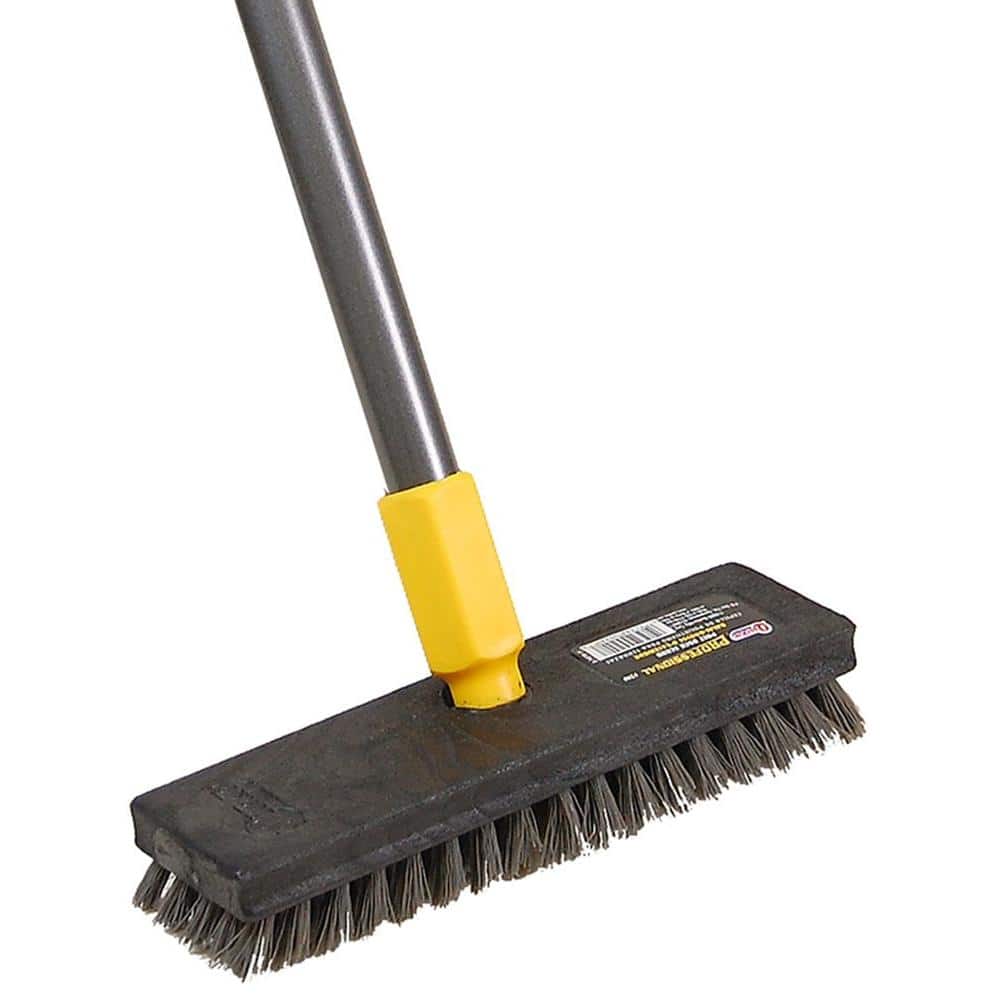

Never used muriatic acid..... but I know this works.... Home depot... $4.49 qt is enough for many cleanings.... the deck brush is $7.99 Remember, acidic not bleach, cleaner.

Acid Bath?????? Not what I was thinking....but call it what you want. Never used muriatic acid..... but I know this works.... Home depot... $4.49 qt is enough for 4 or 5 cleanings.... the deck brush is $7.99
Zep Acidic Toilet Bowl Cleaner is Muriatic Acid, Sulfamic Acid and some other stuff. Check the MSDS.‎ content.rpgov.net/dpw/right_to_know/DPW/Zep%20Acidic%20Toilet%20Bowl%20Cleaner.pdf

So to be clear the acid/toilet bowl cleaner is for removing stuck on grime below the waterline? To begin prepping for painting?
13,304
Yes, test a small area first. Posting a good photo might also help.
Wear proper protective gear, eye protection, gloves and clothes that are not your Sunday best.
