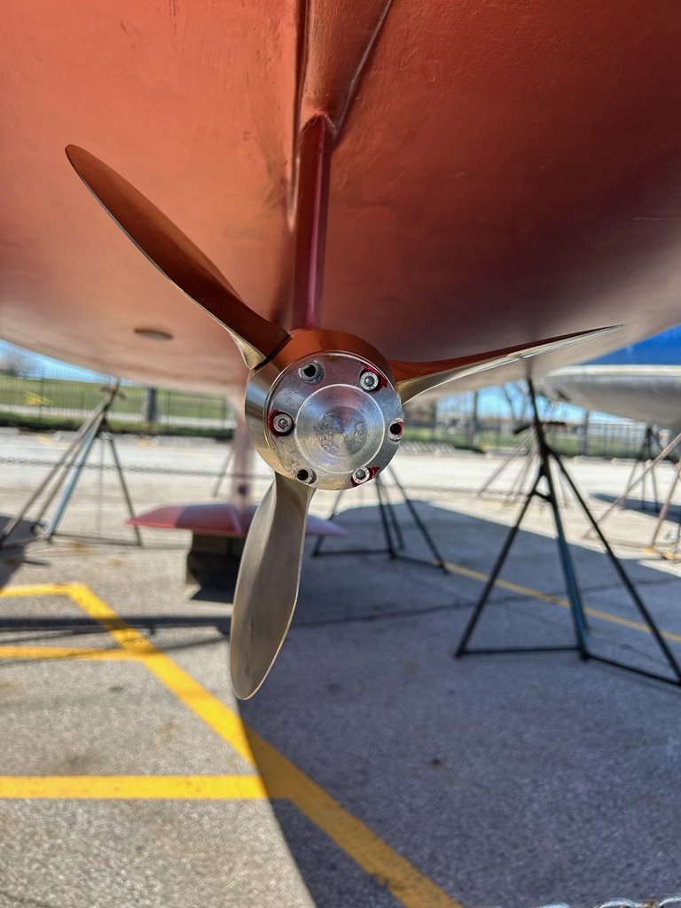

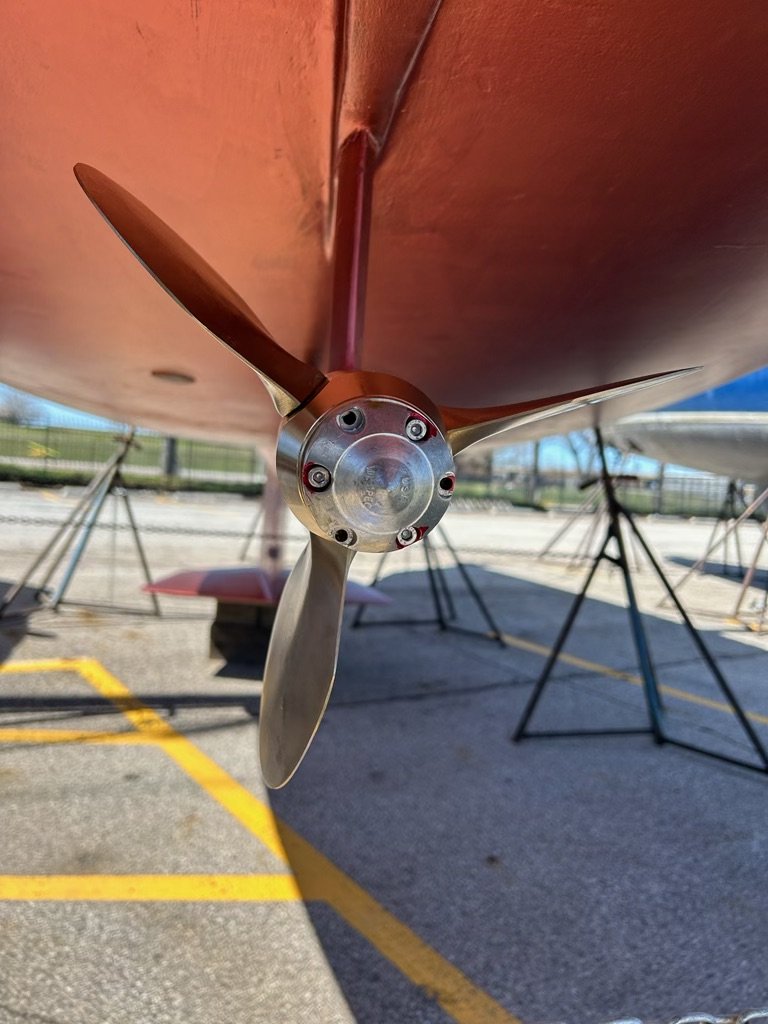

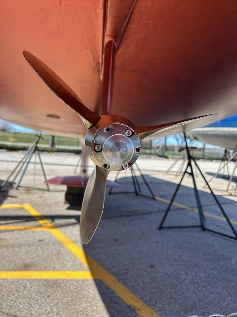

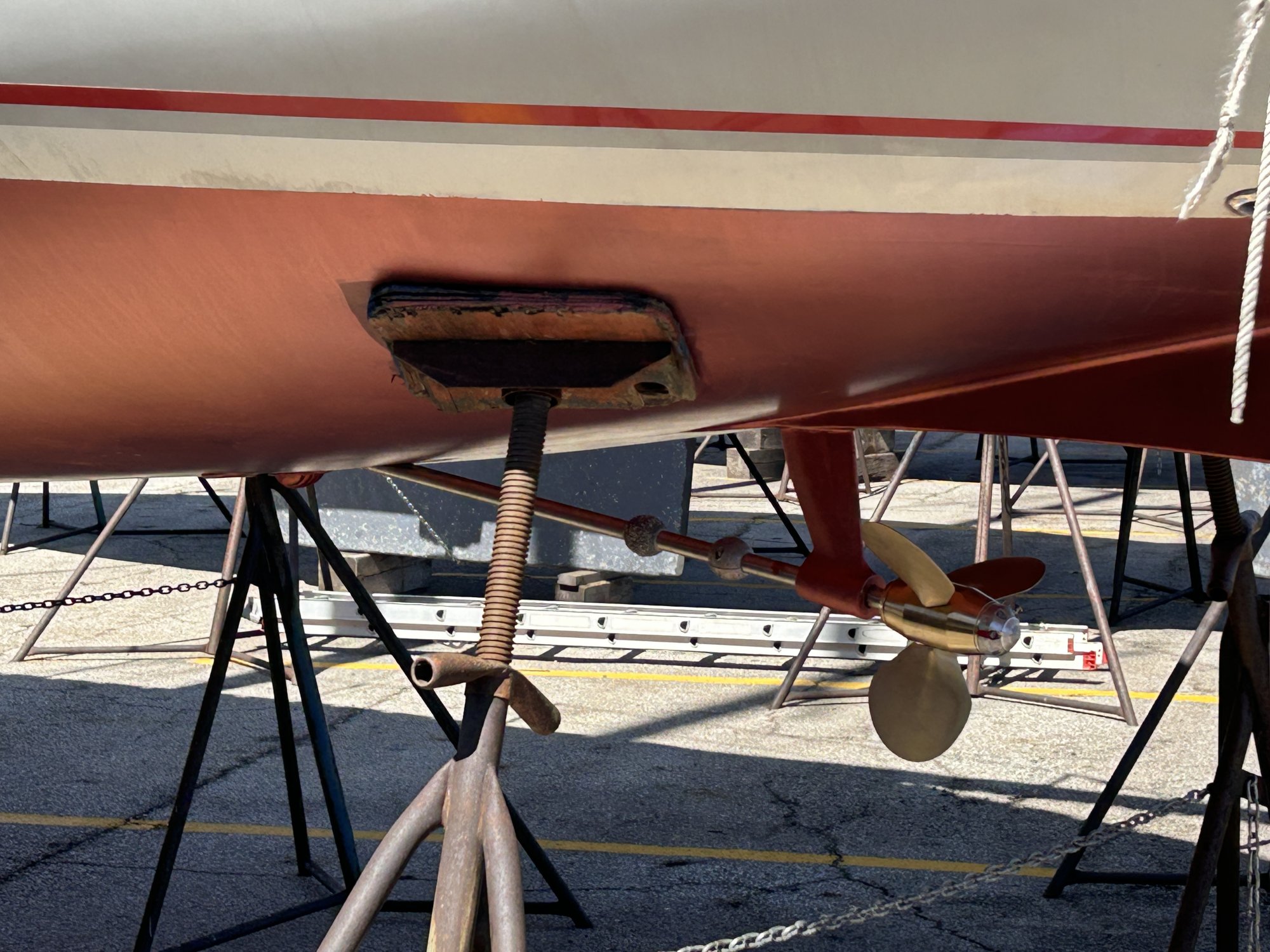

Tally Ho upon launch this spring after VC-17 application.
Greg

I have sanded the rough and flaking spots, smoothed things out and then repainted with VC17. As long as you get the flaking stuff off, and get it as smooth as you want…wipe with some solvent and paint.
But if the goal is to remove it all, and apply barrier coat, that will be a big job with an orbital sander.
View attachment 227820 View attachment 227821
Greg
You're just trying to show off your shiny new prop again :biggrin:

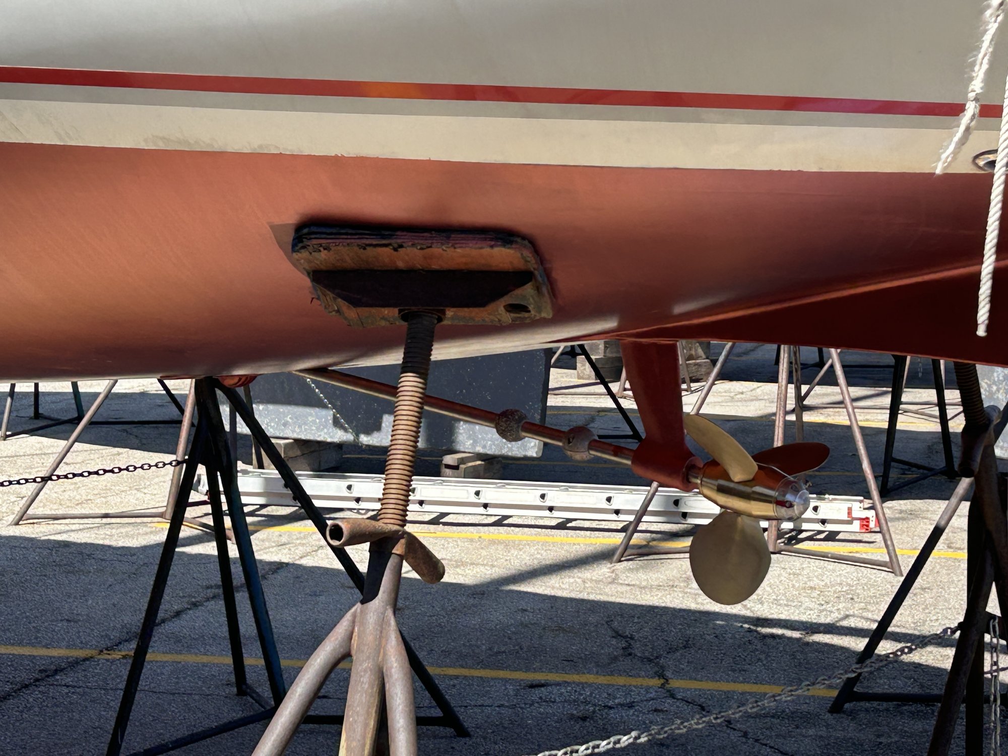

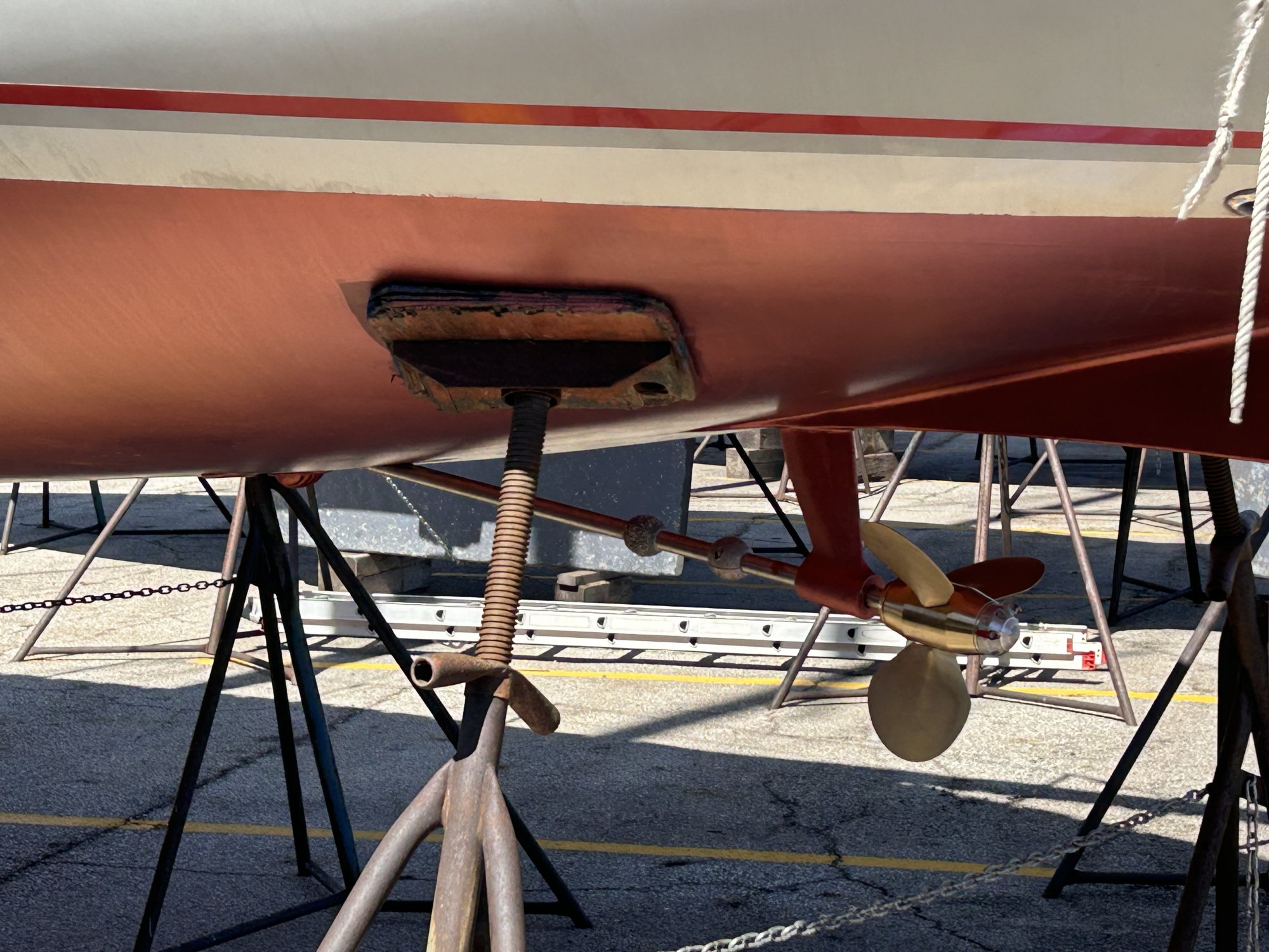

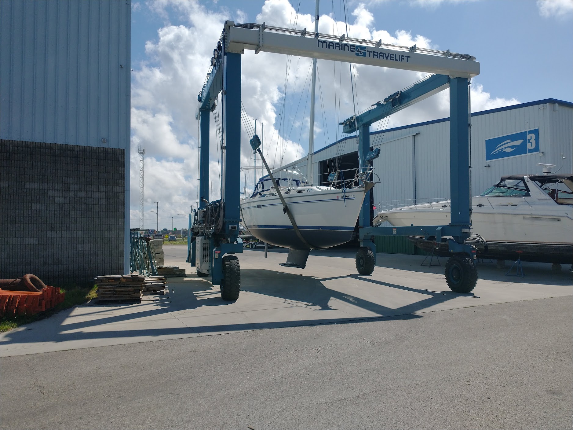

I can't imagine going to the trouble of trying to remove VC17 unless I had to in order to switch to a different paint. As other's mentioned, a quick wipe down with denatured alcohol and repaint with a thin coat every spring is all it takes. Done right, it should not build up. Can't go wrong with VC17 up on the Great Lakes. Pic below is our boat at the end of the season. We don't even bother to pressure wash it. We keep it moving though, and don't spend much time in one place.
13,960
I used VC 17 for about 30 years on 3 boats, I never wiped the bottom with a solvent before adding another coat each spring. The solvent wipe is an unnecessary step. Pressure wash the bottom and get any dirt or dried growth off and roll on another coat.
