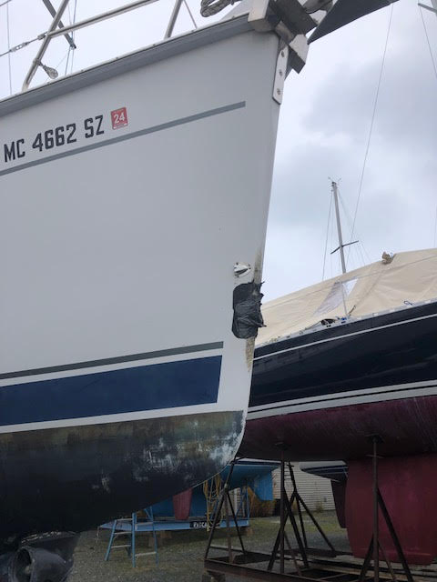

- Thanks - the area to be repaired is in the bow above the water line and below the anchor locker drain. A mooring ball damaged it in a storm. It is covered in the attached picture with black tape

That is outside work, not Anchor locker work.
It is the Bow area that has special structure to take the wave force.
Before
Fixed
I had minor damage to the bow. That part had to be fixed from the outside.
Jim...

Ouch! Pat
That had to make you just sick to see.
I do wonder if the repair can be done from the outside. We had a Tripp 50 hit the channel wall a couple,of years ago and made a much bigger hole. That repair I believe was done from the outside and the boat was still in the water.
If it cant I think the instructions given by Hello Below on how to pull up the platform the V berth cushions sit on should get you there.
