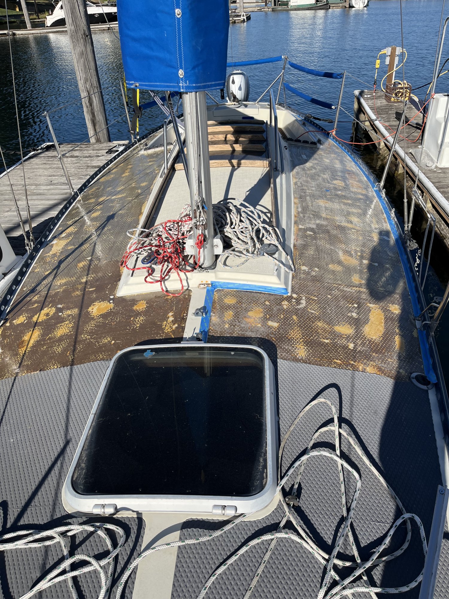

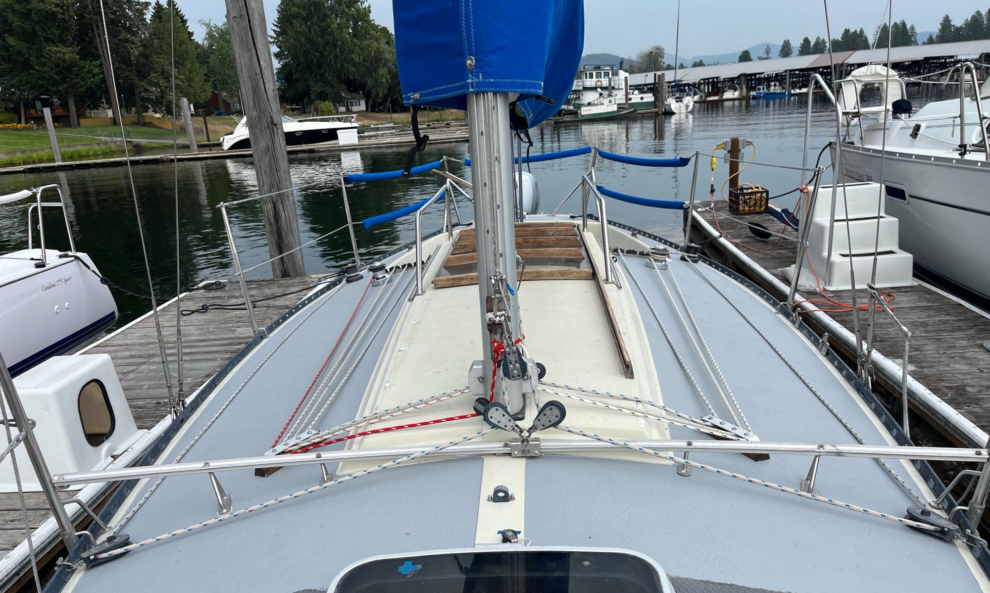

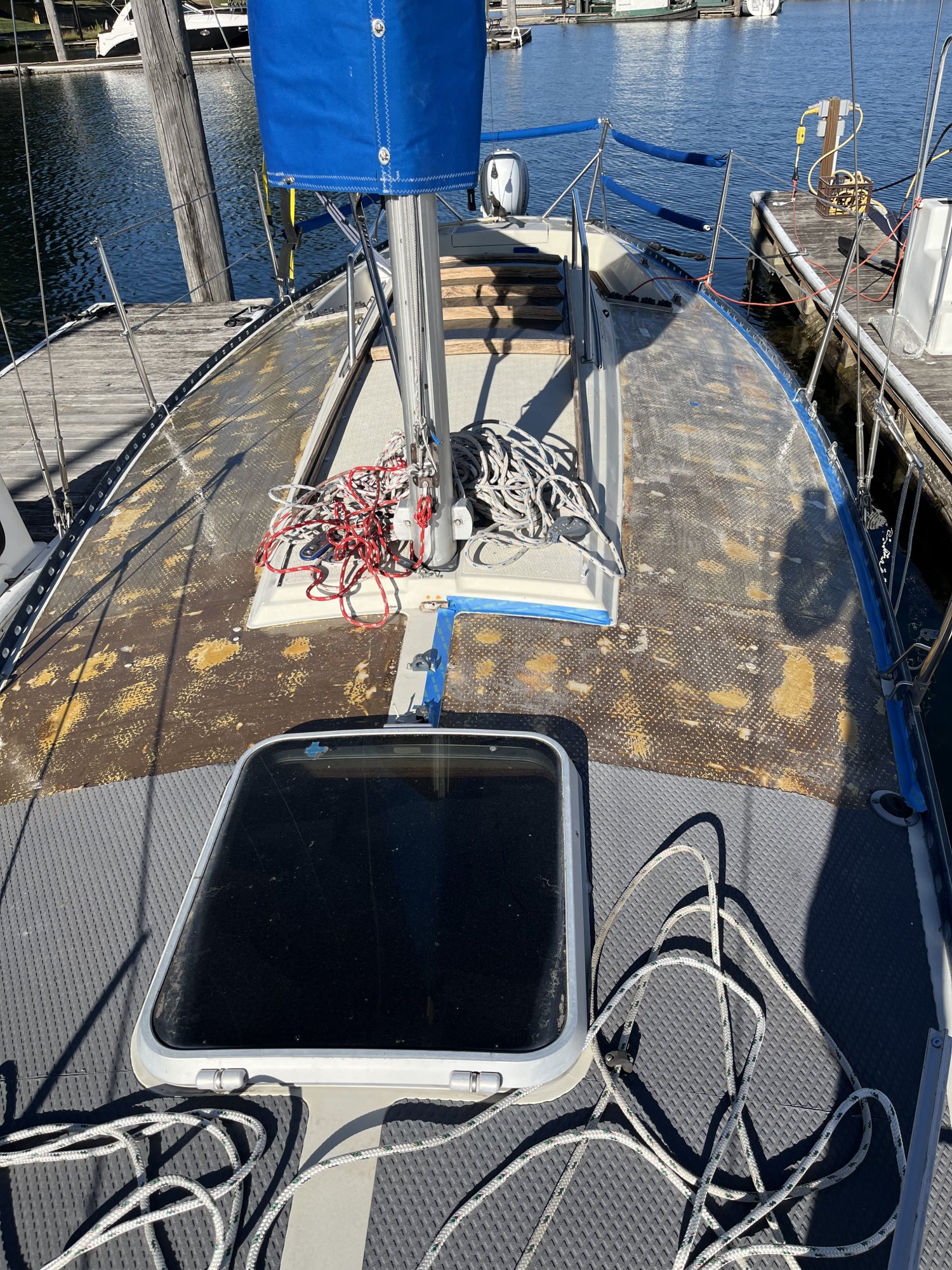

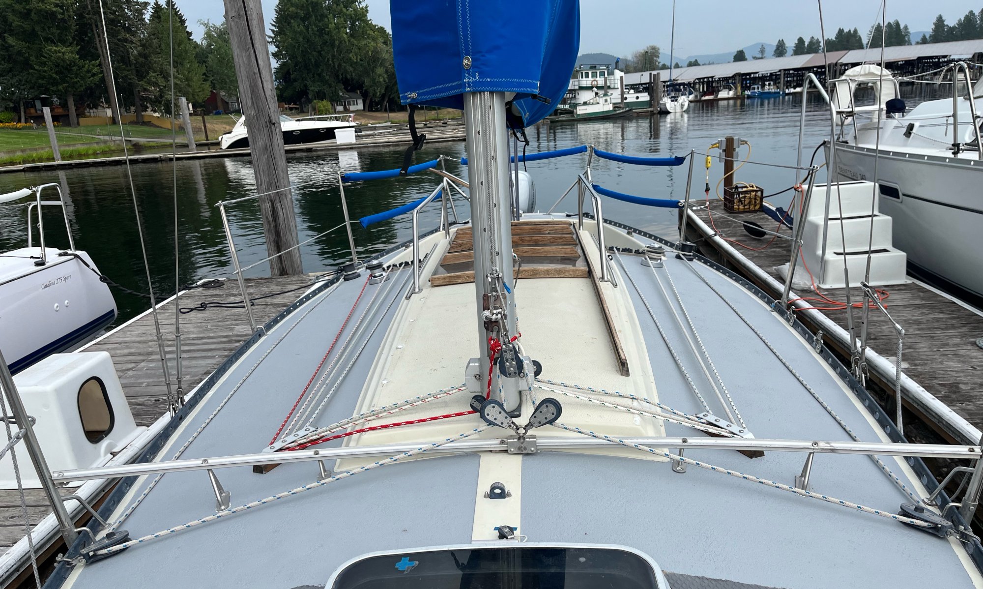

Finally got around to removing and applying Kiwi Grip on two thirds of the deck. To remove the Treadmaster I used a Dremmel multitool with a scraper blade. The old material came up easily particularly on the warmer days.

Removing the old Treadmaster. With a bit of patience and warm weather the job was much easier than expected. Two tools that helped were a Dremmel multitool with a scraper blade, get two or three blades depending on the size of your project. The other tool that came in handy for my project was a Wen file sander. It was handy for the tight corners. It’s also good for prepping corners when doing gel coat repair. One issue I had was some chip out of the gel coat along the edges. It generally happened when I got a bit lazy with the scraper. The chip out was minor and the Kiwi Grip ended out covering most of it. There were a few spots where I went back with a chisel to remove some small pieces along the edge that the scraper didn’t get.
Not sure what you intend to cover the deck with but there are some excellent YouTube videos that cover in detail how to apply Kiwi Grip. The only comment I would add is the more time you take to mast the better your end product will look.
Good luck and let me know if you have any questions.
