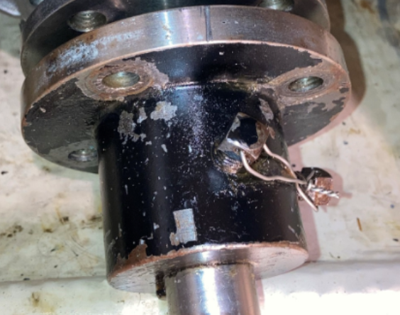

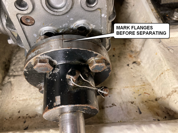

Heat is a good friend here. I had a difficult flange to remove . Heated to 350 to 400 degrees -which is well below any metal transition temps. Two benefits- 1st the flange expands and you can add more WD or Liq. wrench. 2nd the flange expansion makes it easier to remove. I did have room for a puller on my boat but it took several careful tries.
Jan 4, 2006
7,452
Heat would be more like a torrid concubine here. With a big hub like this, an air/acetylene torch would be the minimum but an oxy/acetylene torch would probably be best to move things along.
Unfortunately, this doesn't help @Rich Stidger getting the flange back on again unless he resorts to a split flange. I believe a split flange is recommended to be installed initially by a pro shop first.
I wonder if anyone with a dripless mechanical seal is reading this and realizes the work required every 6-8 years to renew the bellows.

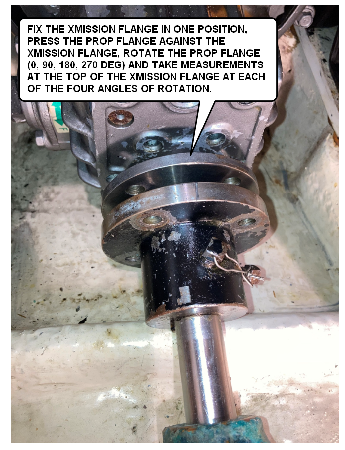

"Angularity" - Does this mean that the flange might not be perfectly perpendicular to the shaft? If this is possible, how does one check for the precise alignment and if it is not correct, how is it corrected? IIRC, the alignment spec is 0.001" per inch diameter of the flange. So the flange to shaft alignment has to be darn near perfect in order to align the shaft flange with the transmission flange.
Jan 4, 2006
7,452
If there's a God above, please don't let that happen or it's off to the machine shop we go.
Rotate the prop shaft flange and measure the clearance at a single point relative to a fixed object while pressed against that fixed object. That fixed object will be your Xmission flange. That clearance must (we hope and pray) remain within 0.001/inch of flange diameter.
It's off to the @#*&%#*&^%*! machine shop we go to see if they can correct it or replace the whole assembly.
Unfortunately, yes. But FIRST, the prop shaft flange has to be perfectly aligned to the prop shaft and THEN the prop shaft flange is aligned to the transmission flange by kicking the :poop: out of the engine, UP, DOWN, LEFT, RIGHT, IN, OUT, ROUND AND ROUND until you're blue in the face. Oh yeah, and then after you do all that, remember that you should have loosened the engine supports so the engine would move when you kick the :poop: out of it.
Engine alignment, the making of a man OR alternatively, the breaking of a man.
Attached are the instructions I started with decades ago (two anyway) and have trimmed them back to suit myself. They'll help you to understand what you're trying to achieve and enable you to streamline where you see fit.

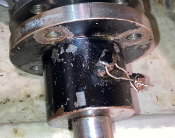

For separation of the flanges, I still believe that a socket located in the centre, and using bolts to press them apart has the most promise
Jan 4, 2006
7,452
That of course is the method for driving the prop shaft flange off the shaft. However, when things get sticky, you may find yourself looking for an assist such as :
............. which is the only way when you've got a big hub as these things do.
