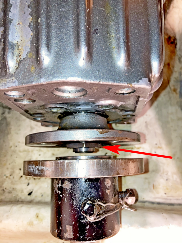

What I want to know, when you tighten the longer bolts between the shaft flange and the transmission flange, with the socket spacer, what keeps the transmission flange from coming off instead of the shaft flange?
Jan 4, 2006
7,757
A fervent religious belief.
A few pennies in the poor box every week.
And for you non-believing heathens, make sure the big hex nut on the Xmission shaft is bloody tight :biggrin:.
Rich
Thanks for this
But, the compression force is between the 2 flanges, as the shaft is free to move fore & aft.
Once again, do this carefully.
