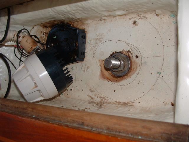

I'll take a picture
I thought I had a picture of the seal area, but I didn't. I'll take one and post it. It looks a bit like the picture "Maine Sail" posted, but not quite as much weeping.
I'm going to have the boatyard drop the keel, but my timing is bad and I won't be able to get to it for a couple of weeks.

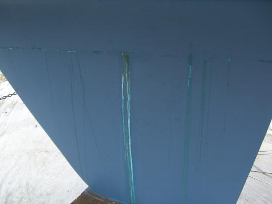

He's a picture of the weeping keel that started this. A couple of years ago I saw no weeping when it was hauled out. The boat remains in the water year round, and the only time I've ever seen any water in the bilge is after a rain.
I'll have the boatyard drop the keel and do the re-bedding. I need to see what's happening down there since one of the bolts seems to be coming out of the lead.

Some pretty good water infiltration. Without dropping it you'll have no way of really knowing the condition of the bolts so you've made a good choice. Keep the pics coming..
Ross

My keel ballast is incapsulated in a full keel.
But I get streaks like that in new bottom paint from the water draining from the scuppers. That look to be quite a bit of water. There is no doubt about the scource. The "WHY" is the big question.
