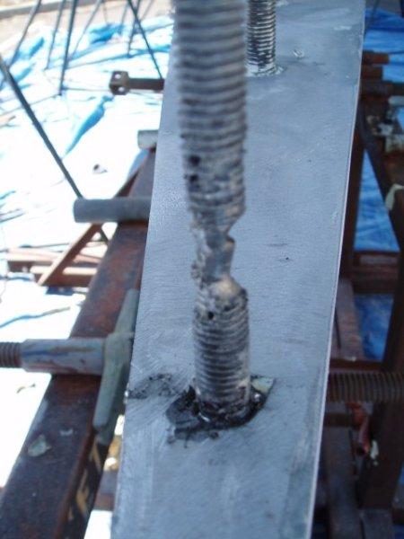

The bolt rising up an inch or so as you tightened it could be a failed bolt due to crevice corrosion. It could also be that O'day was one of the manufactures who laminated plywood into the keel stub and this wood is compressing giving the appearance of the bolt rising.
Either way dropping the keel and re-bedding it is no simple task. Unfortunately what you will likely find is that the diameter of teh bolts has been eaten away and your keel needs new keel bolts installed. Mars Metals up in Ontario is one of the few shops who does this the right way and you can drop your keel and ship it to them on a pallet and they'll ship it back to you.

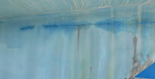

water evaporate under water? Trust me there are many keels not leaking. If you haul your boat and no water comes out from the joint it's probably dry. If you haul it and months later it looks like the photo bellow it's leaking.

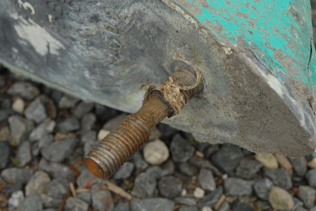

Another photo
This keel bolt was leaking from the top or bilge side and NOT the keel side. Note the lower portion where it passed through the keel stub was free from corrosion. Perhaps this boat had a wet plywood core from bilge side leakage that destroyed these bolts. The point is that the keel side is not what failed but rather the bilge side.
Sometimes plywood cores are destroyed by owners mounting a new bilge switch. Perhaps they don't realize or know it is a cored bilge so they don't bed the screws and the plywood just sucks up the water eating away the keel bolts..
